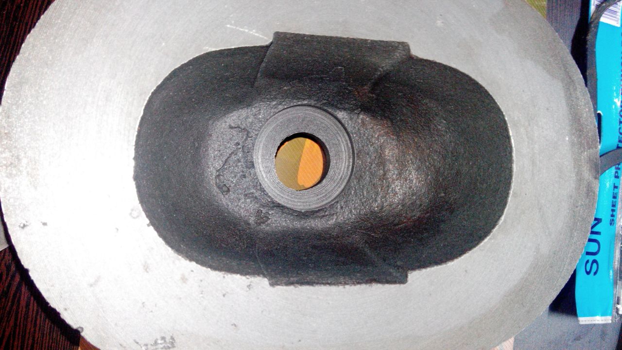

Model in Solid Works Rahul Kapoor 13 Dec, 2014 04:04 AM How to make the part in SW with the cut as shown in the pic 4 IMG-20141213-WA0004.jpg pdf.pdf bonnetpics.zip 4 Answers saeid mirshahidi Answered on 13 Dec, 2014 09:08 PM I Hope it Help You Answered with a tutorial: https://grabcad.com/tutorials/model-in-solid-works bonnet-S.SLDPRT Rahul Kapoor Answered on 14 Dec, 2014 05:20 AM This is my part BONNET.SLDPRT saeid mirshahidi Answered on 13 Dec, 2014 06:14 PM You Can use lofted cut with suitable sketch & guide curve saeid mirshahidi Answered on 14 Dec, 2014 10:25 AM perfect But not exactly same drawings & Pics
