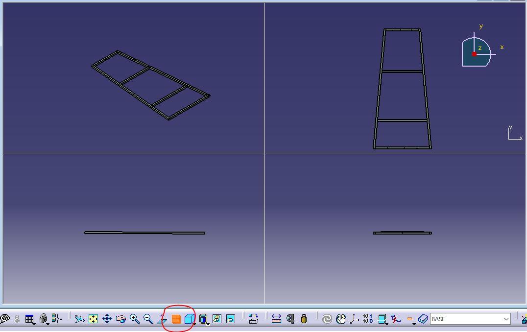

multi-view command not working catia
I'm using catia.
and multi view command was unavailable.
somehow I restored the icon ftom the options menu.
but still the views does not show as multiview...
whenever i click that icon I can't see any multiple view's on the screen.
someone help me in solving this problem..
5 Answers
The CREATE MULTI-VIEW command only works with 3D data (parts or assemblies). It does not work with drafting. This command changes the screen layout to show multiple windows of the 3D model.
(If you want to create multiple views on a drawing, use the View Wizard tool in the Drafting workbench)
YES . Actually I tried to show multi views in the part body environment only.
then too It didnt work.
I'm using a student's version
