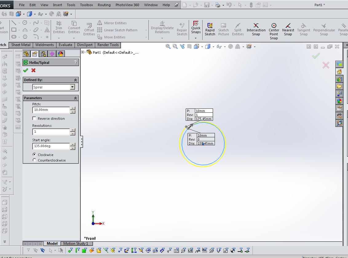

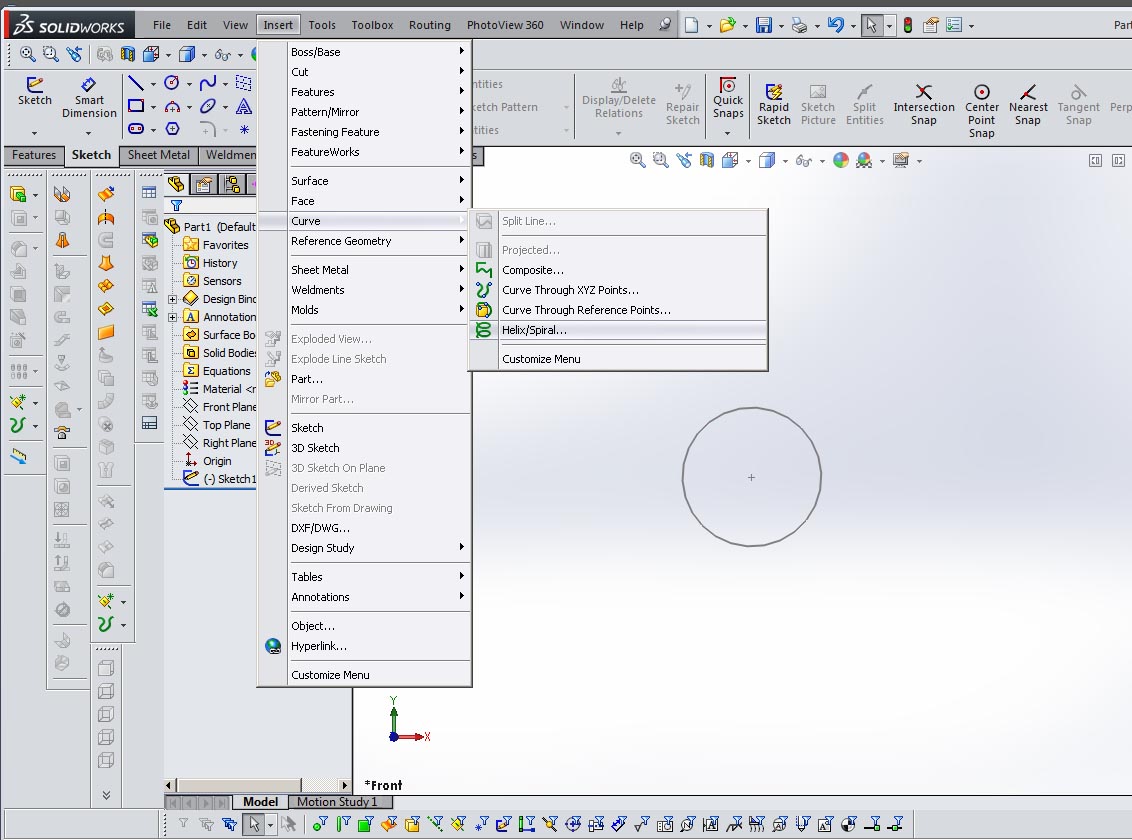

In solidworks you haveat least two path. Draw a simple circle an then (see figures attached 0 and 1) Use specific funtion spiral a = pitch.

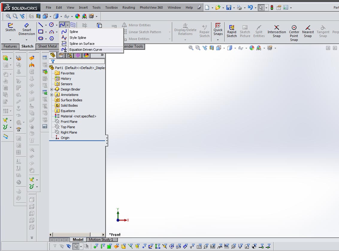

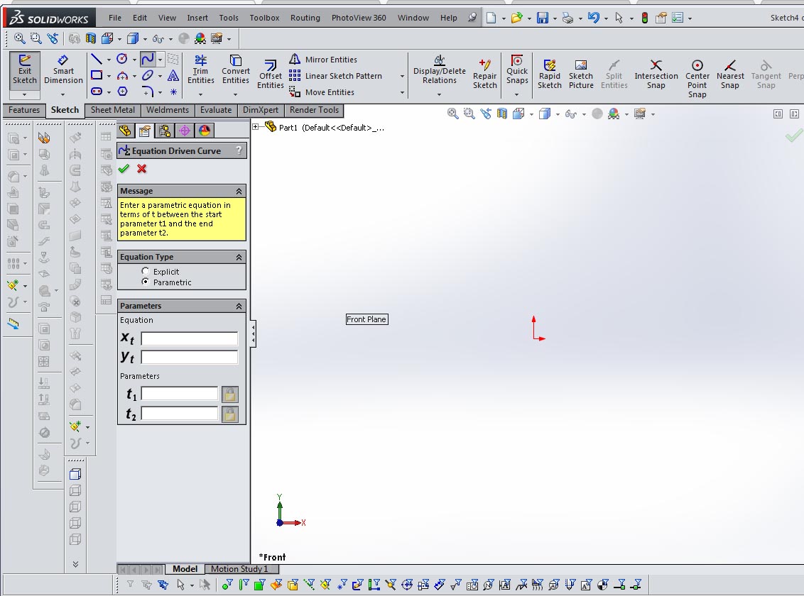

Or use a drive equation driven curve ( see figures 2 and 3).
