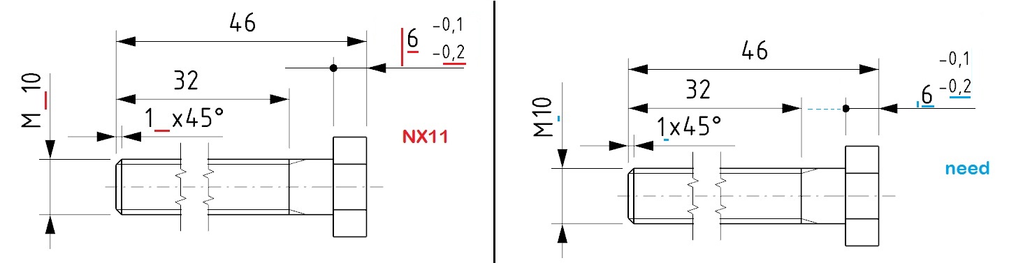

Hi guys. I´m new in NX11 drafting and I have some basic questions.
Is possible configure NX11 drafting preferences to:
- reduce spaces between dimension text / field "Before" and dimension text / field "After"? (it takes a lot of space when placing the dimension...)
- when is need to put both f arrows out, is possible reduce or eliminate one of arrow lines length, keeping its dimension line visible? (when I try eliminate one of the arrow line, the dimension line always desappears, and it takes a lot of space to put the dimension...)
- align tolerance fields (bilateral) so that lower tolerance text bottom aligns with the middle of dimension text? it´s a national standard requirement here (ABNT/NBR).
Manually I didn´t get it, and my search int Draft. Preferences didn´t get results too.
See attached file
Many thanks ind advance
Looks like the spacing was working before, perhaps in an earlier release?
Many of these settings are in the drafting standard (customer defaults > drafting > general). If you're company uses their own standard, it may be customized, otherwise, choose one of the standards.
