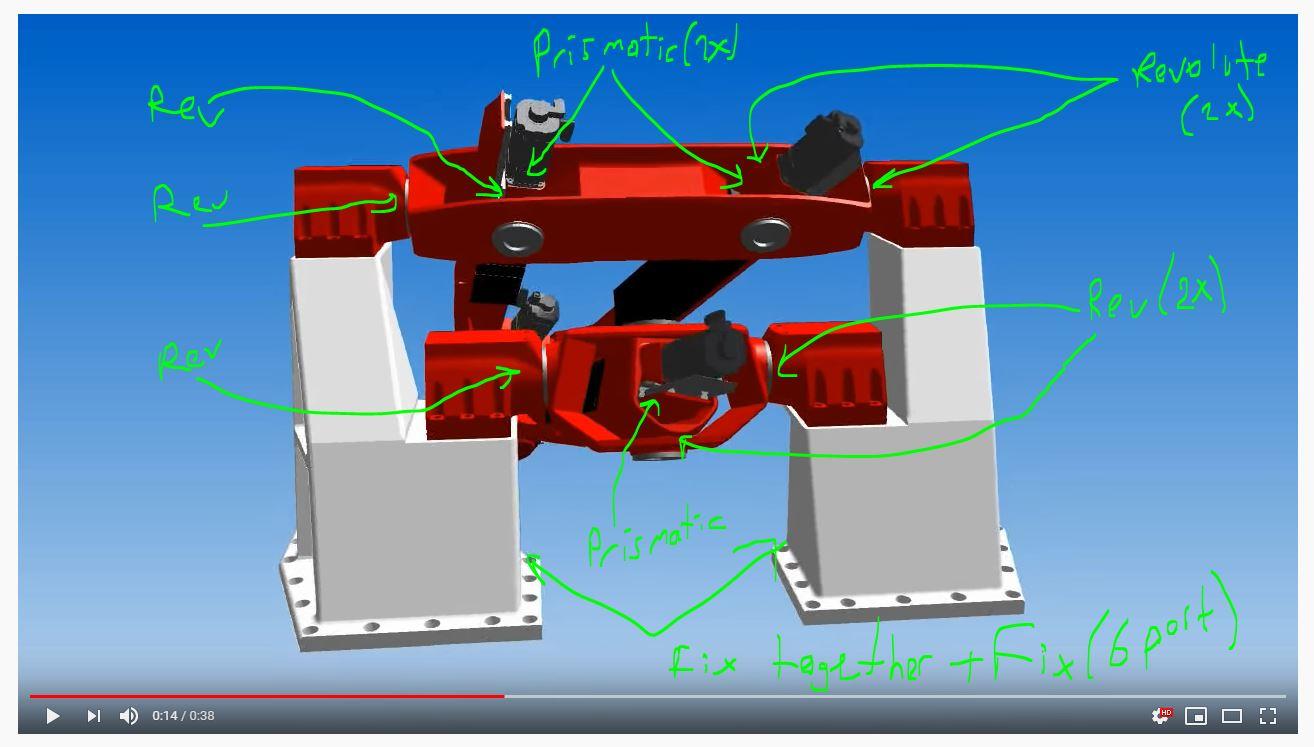

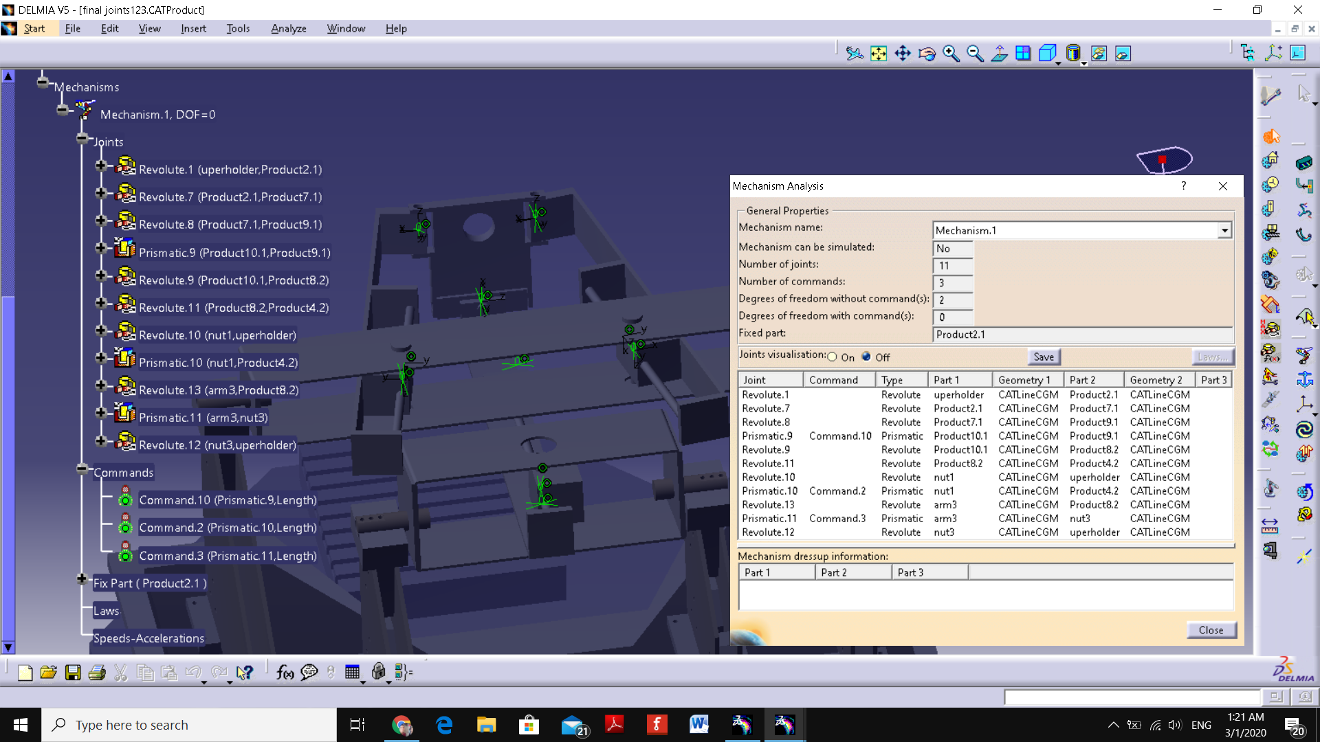

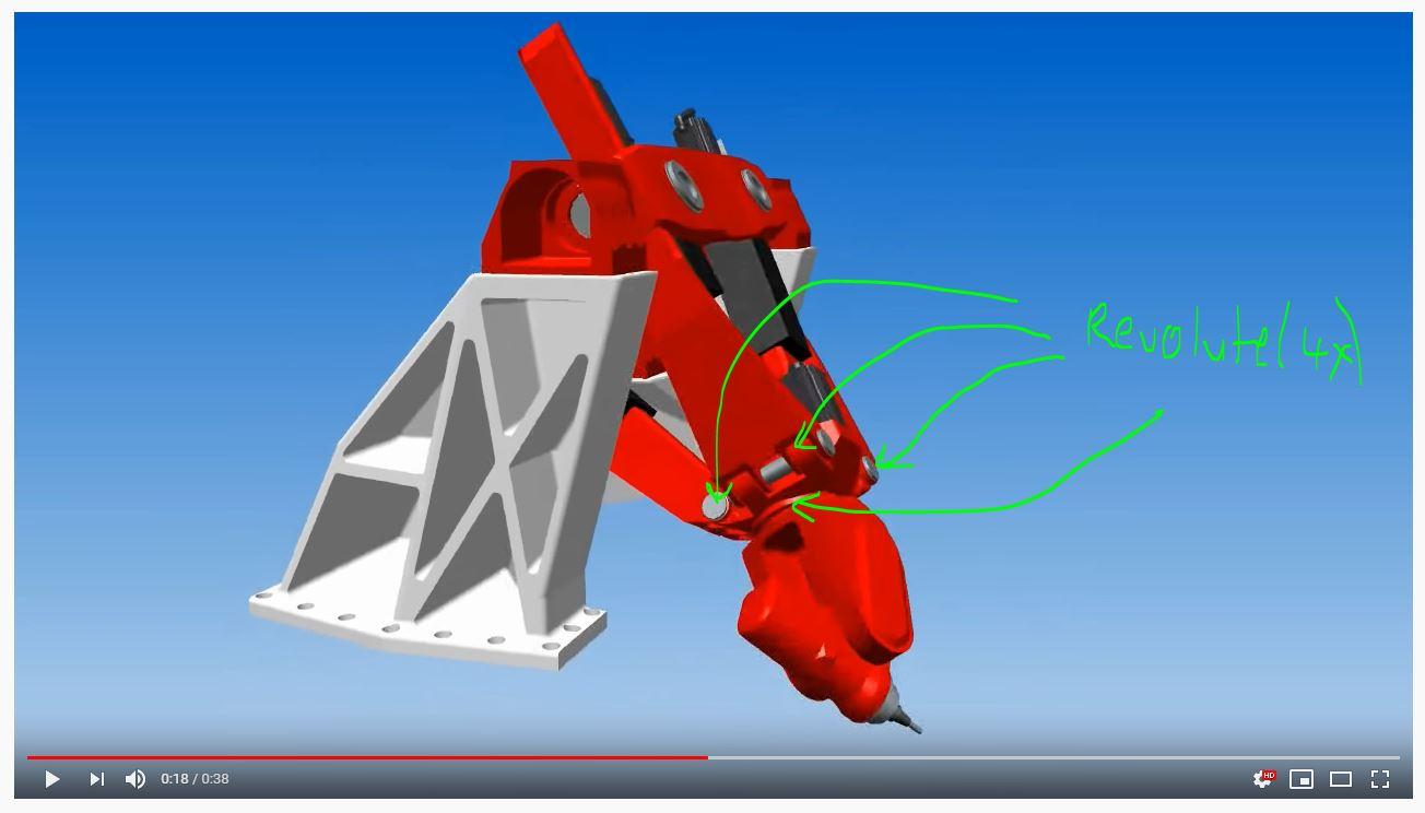

p Abdelrahma Ahmed 29 Feb, 2020 11:48 PM 6 bfdbdfb.png 3 Answers özgür kesebir Answered on 3 Mar, 2020 04:26 PM connections step1 connections_01.JPG özgür kesebir Answered on 3 Mar, 2020 04:26 PM connections step2 connections_02.JPG özgür kesebir Answered on 3 Mar, 2020 04:30 PM first way = 3x prismatic joint and 1 revolute can be length driven. second way = add point to the front drill and make a path with point and curve joint with lenght driven. (1 more part needed and can be hidden at the simulation)
