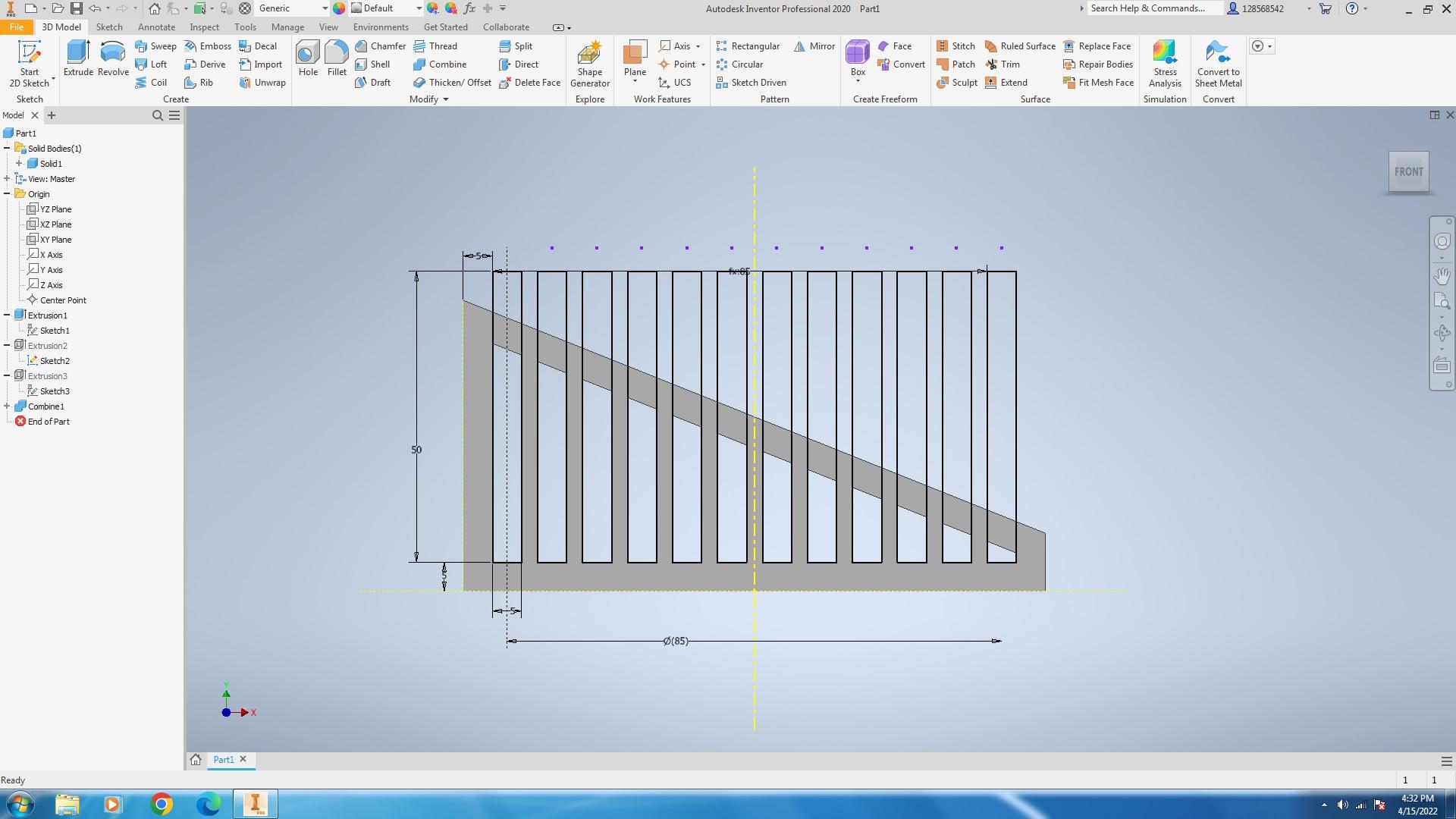

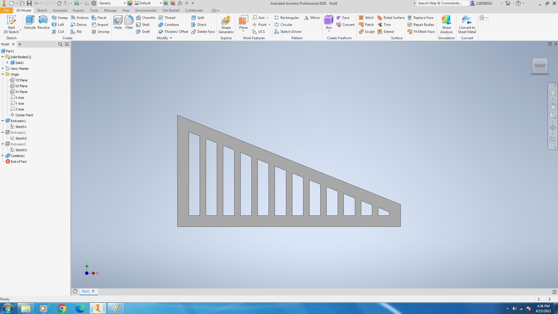

Like Mason pointed out you can’t taper a pattern. Each instance in a pattern, whether it be in a part sketch or an assembly, will be identical. What you can do in a part Is make a feature using sketch pattern and then make subsequent edits using additional sketches and features.
