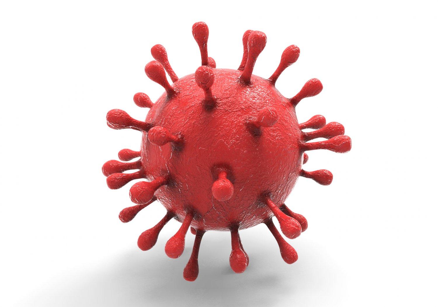

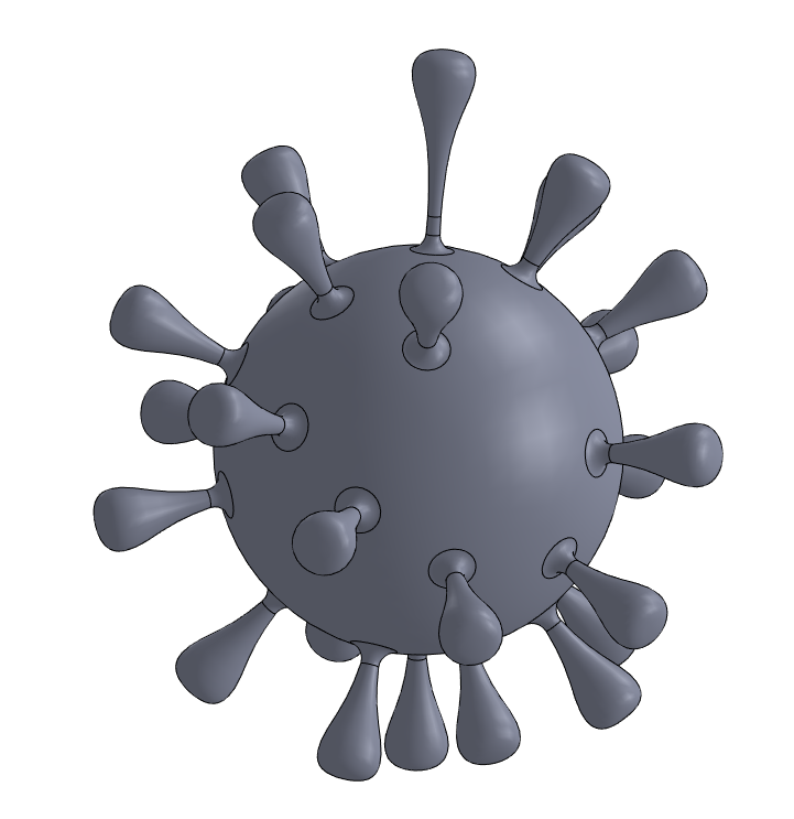

Here's a SOLIDWORKS model, that is then rendered. It is just a sphere, then a bunch of additional revolved shapes are added to it. The CAD model has a rather boring appearance.
Texture and color can be added via rendering. Here a skin like material is made much more red, then a texture is applied to give the surface some detail. Additional work can be done in an image editor.
The end result is a blend of your skill level, time spent, and effort exerted.
