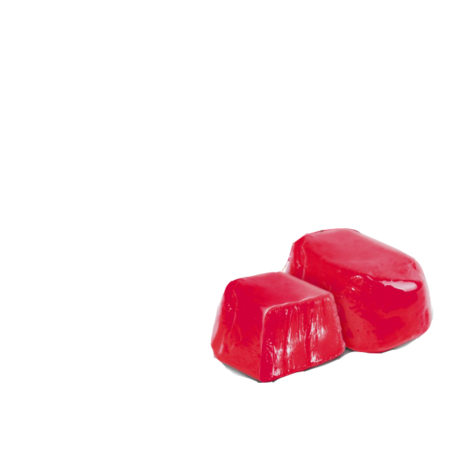

I have some candy like in picture. I want to do the same material (same view). Please tell me how can i do the same material ?
I work in keyshot. But also can in Photoshop/
2 Answer
http://files.mail.ru/57FF1ABA1D99438C849C8BCBDB86A182?t=1
Thats what i've done.
After keyshot rendering i made some improve in Photoshop.
http://files.mail.ru/31025E219B784634BCDEA954AFDF4D65?t=1
Copy and scale the solid a little bigger or smaller. You can get a lot of cool effects by making the outside surface glass and the inside surface something else and changing the "refraction" setting in KeyShot 3.
