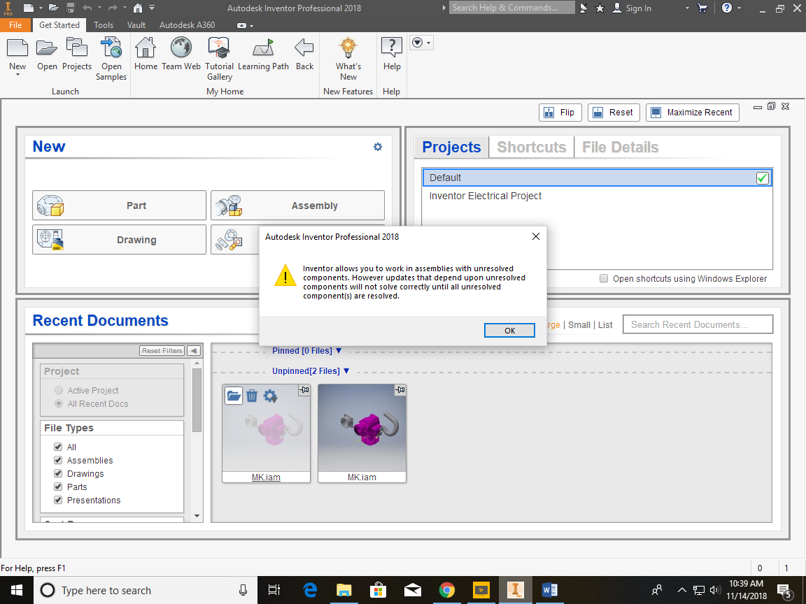

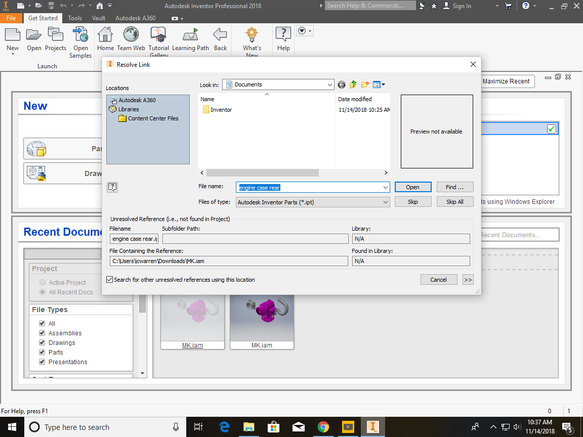

Hi I am a student of inventor software
I keep getting resolve link issues and I have compressed, zipped, and extracted my work yet the problem remains
if you need the files let me know please help.

Five files are missing and unless you have them then you will always get this message,
When, the Original assembly was made it had these files and it remembers them so unless you find the files then the assembly is broken, if you don't need these file then make another assembly without them.
[ERROR] 5 components were not found.
C:\Users\icwarren\Documents\Part11-25ul.ipt
I:\Engine Sleeve Rear.0011.ipt
I:\Part10-28ul.ipt
I:\Part5.ipt
I:\Rear Exhaust Manifold.ipt
