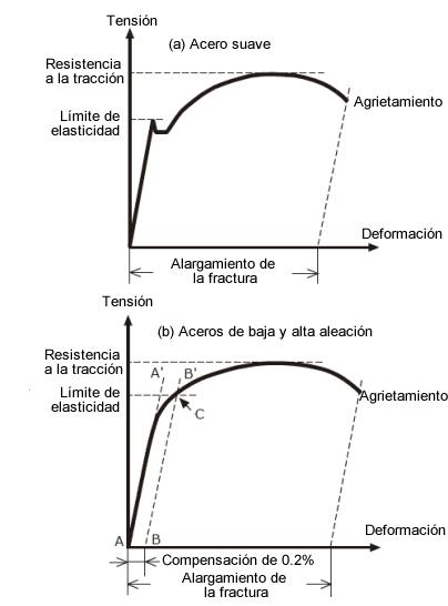

For example, in uniaxial tensile tests, it is defined not only how much stress the material resists elastically, but also how much unit deformation it can resist (this can be observed in the post-processing of the linear simulation because "their theory does not consider that the deformation has a limit " but calculates it as if it could take any value).
