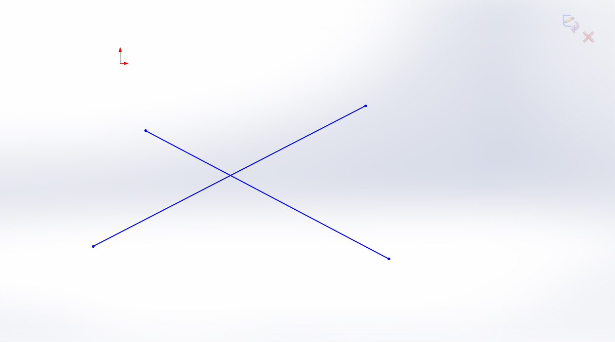

Imagine that we want to draw a sketch (for example a line) from the intersection point of two lines (or a line and a curve , etc.). What should we do? Unfortunately when the cursor comes near the point, there is no change or ...

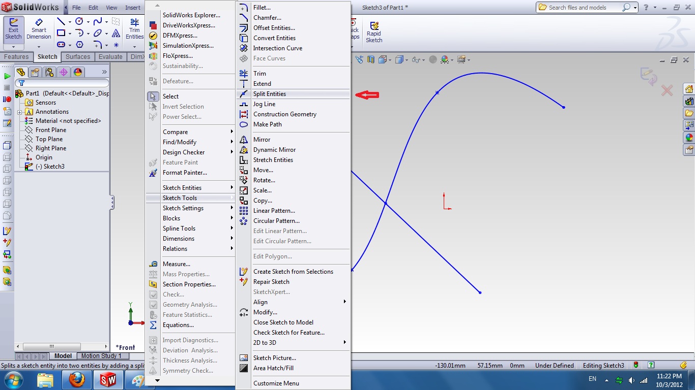

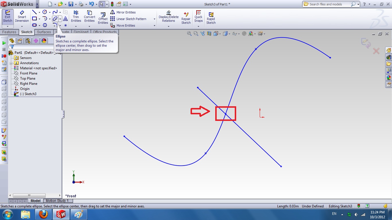

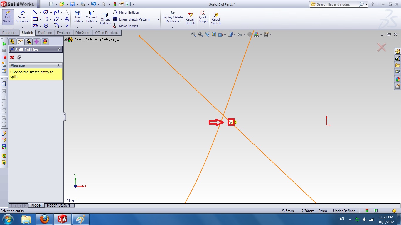

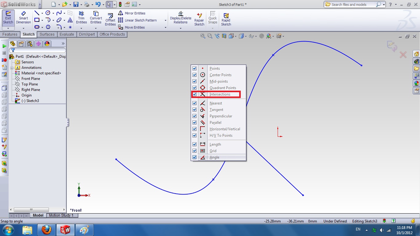

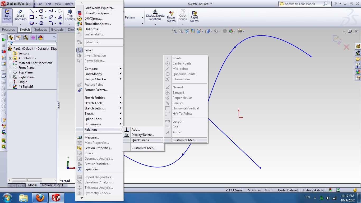

I explain the procedure through screenshots in five step
note: if you want to start some sketch feature like line from the intersection point just do the 2 first step and by nearing the cursor after clicking the line button to the intersection the intersection snapshot appears then by clicking the intersection point will selected as start point of the line.
