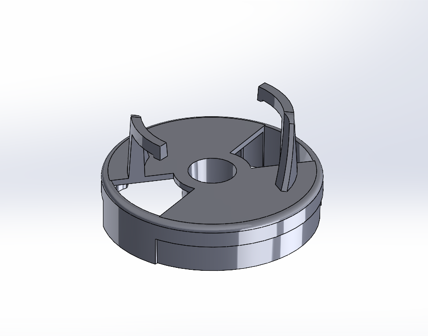

I am still a student and am practicing mold making for the part, but the part with the cavity separation face is difficult to identify. I'm here to ask for your help, can you show me a good way to model?
Hey Xuan,
From a quick glance this is quiet a tricky part to learn on that being said I would probably split like this.
Green line is you split line for these features and you will need a core from the bottom.
Blue line in the split between die faces(to maintain Radius).
Hope this helps.
