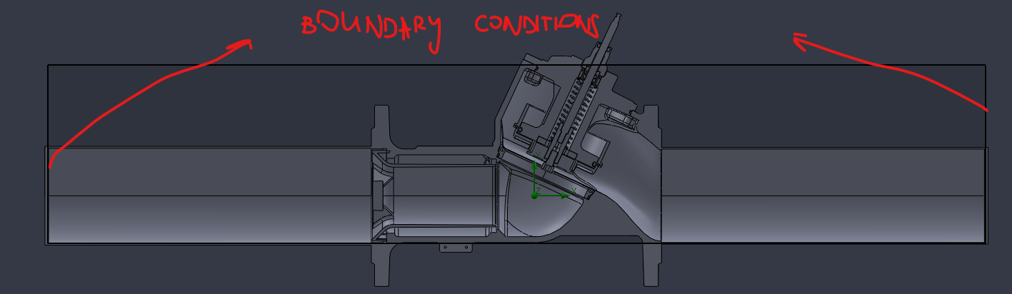

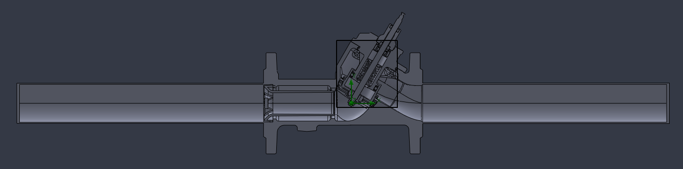

I have been doing some CFD simulations in SolidWorks Flow. I did a couple of simulation and they were okey, but when I came to the current example (Valve DN65) it didn't show the computational domain as it did in the rest of them. Because of that I couldn't run the simulation. In the attachment you can find two pictures:
1. Valve DN125 with the right computational domain
2. Valve DN65 with the wrong computational domain
Why is this happening? Should I change something in the model (e.g. forgot to close something)?

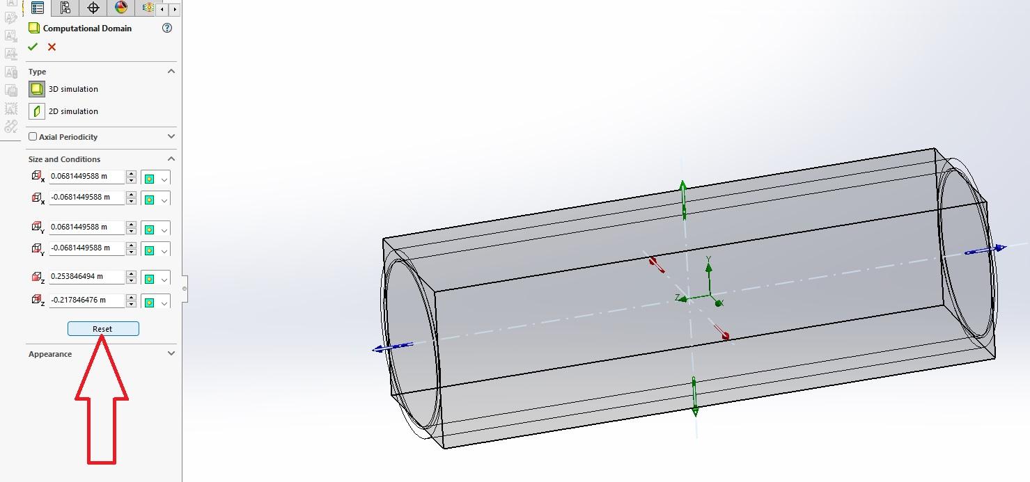

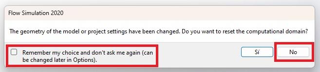

I don't think you did anything wrong. The computational domain simply has not been updated for the geometry you are simulating. Perhaps you ignored the dialog box warning you that the domain needed to be reset (you checked the box or answered NO).
Anyway, you can go to the computational domain specification and press RESET.
