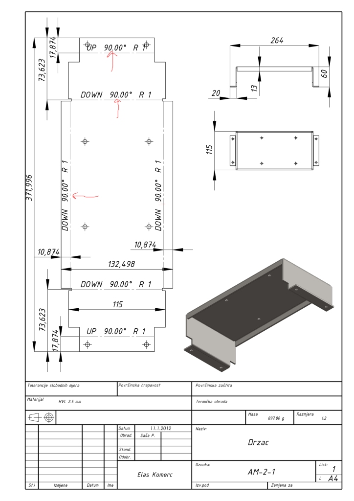

I think I saw somewhere to change color of bend line in solidworks but I can't find the option. So can someone explain how to set this.
Thanks in advance.

Try adding the "line format" as a toolbar and then select the bend line and try changing the color.
Search the help menu for:
"Sheet Metal > Sheet Metal Parts > Sheet Metal Options"
This will step you through the process.
Thank you I have found it when you access drawing then on options there is an command where u can change it.
