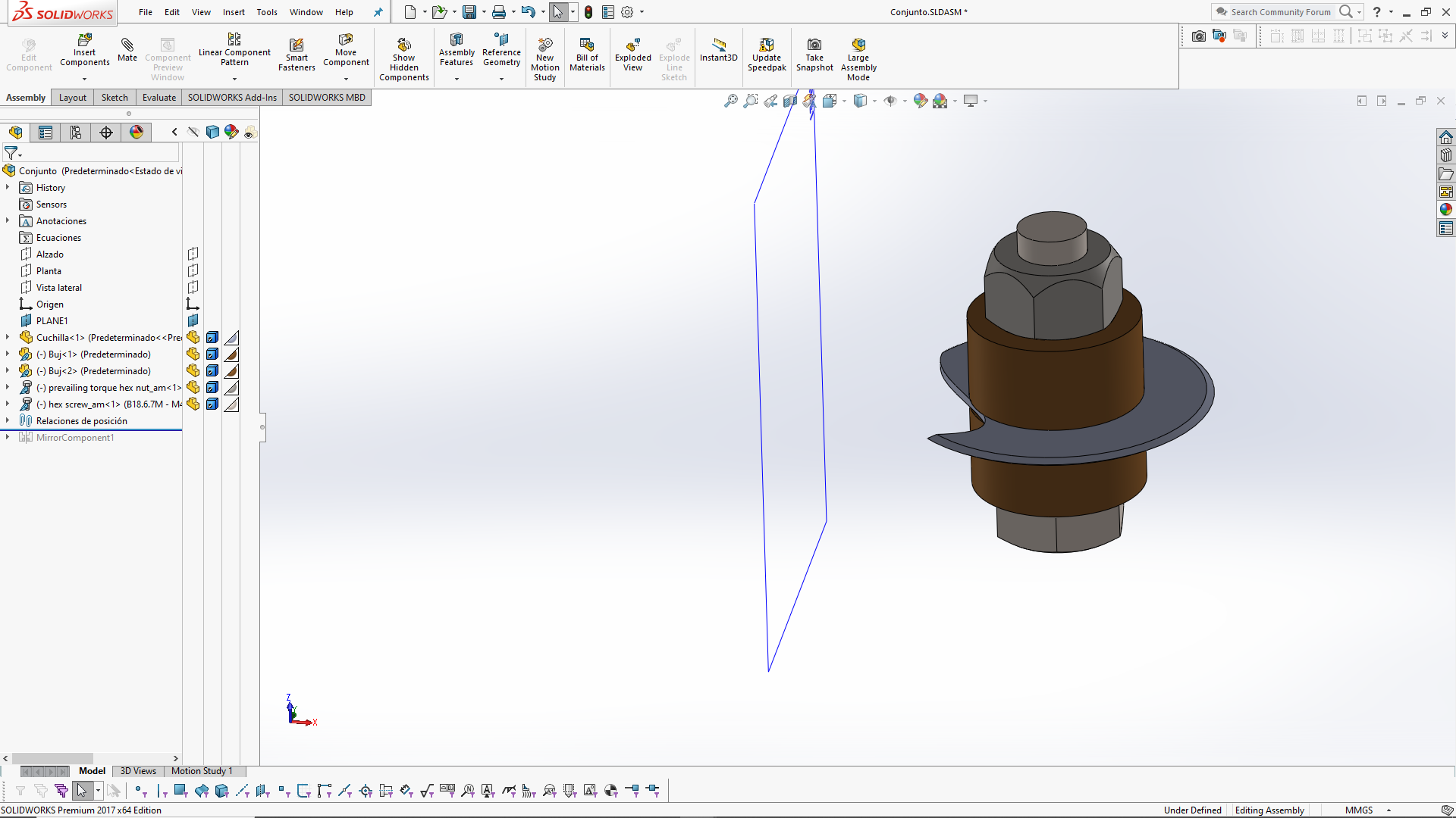

Is it possible to create a mirror of a solidworks assembly? The closest I have found was to save the assembly as a part and to mirror that. Would I have to individually mirror the parts and recreate the assembly?
Accepted answer

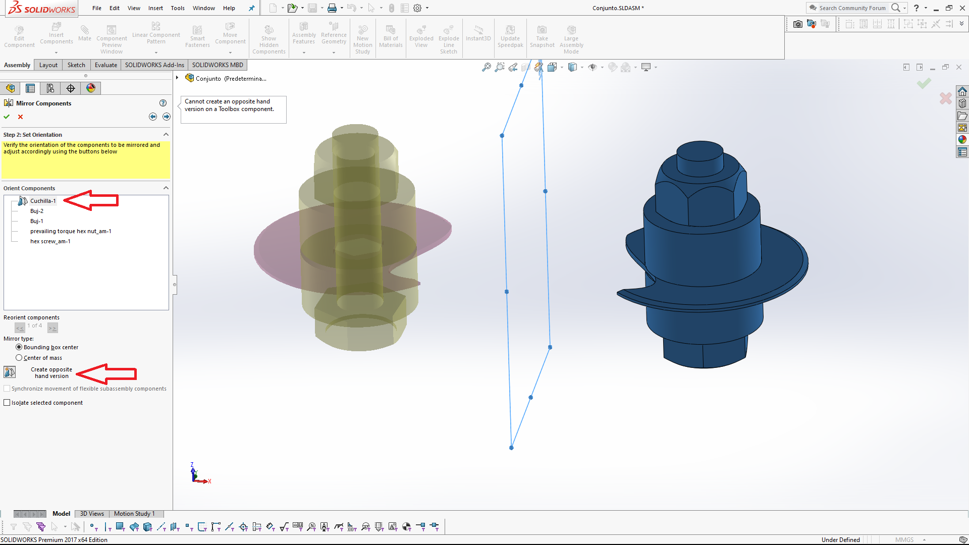

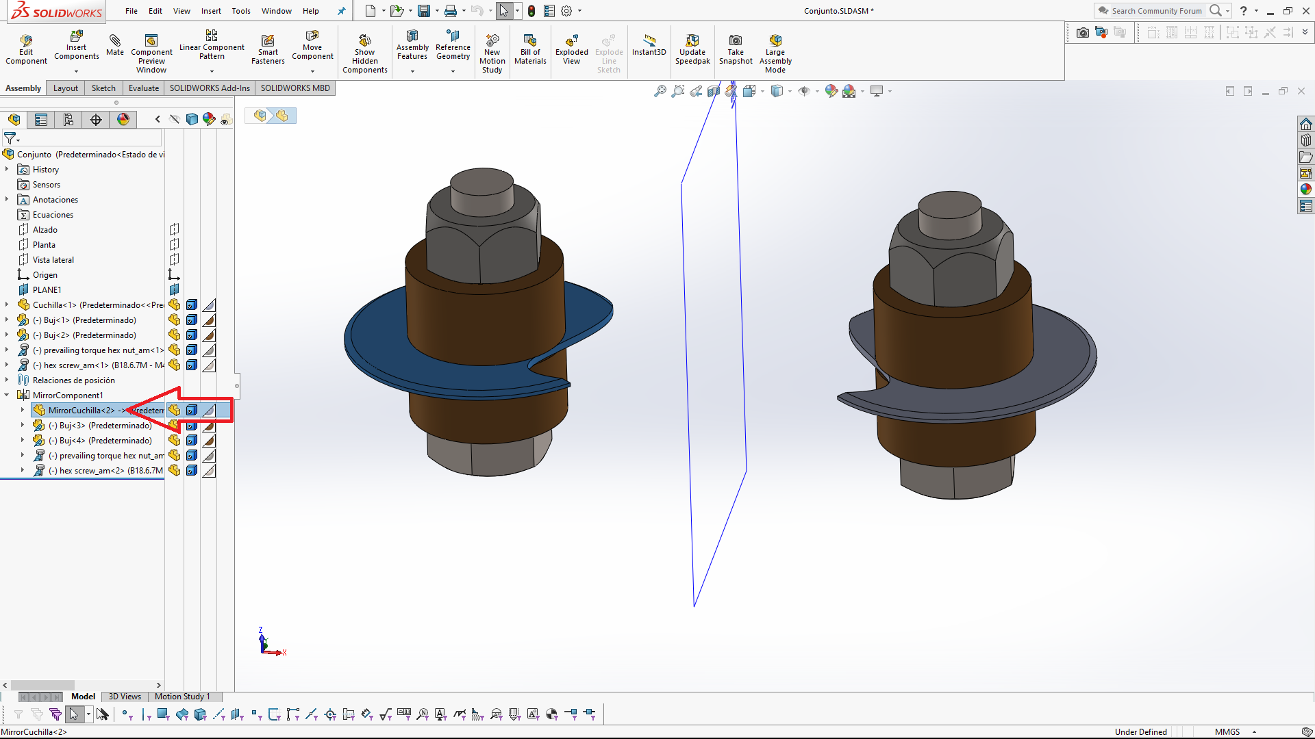

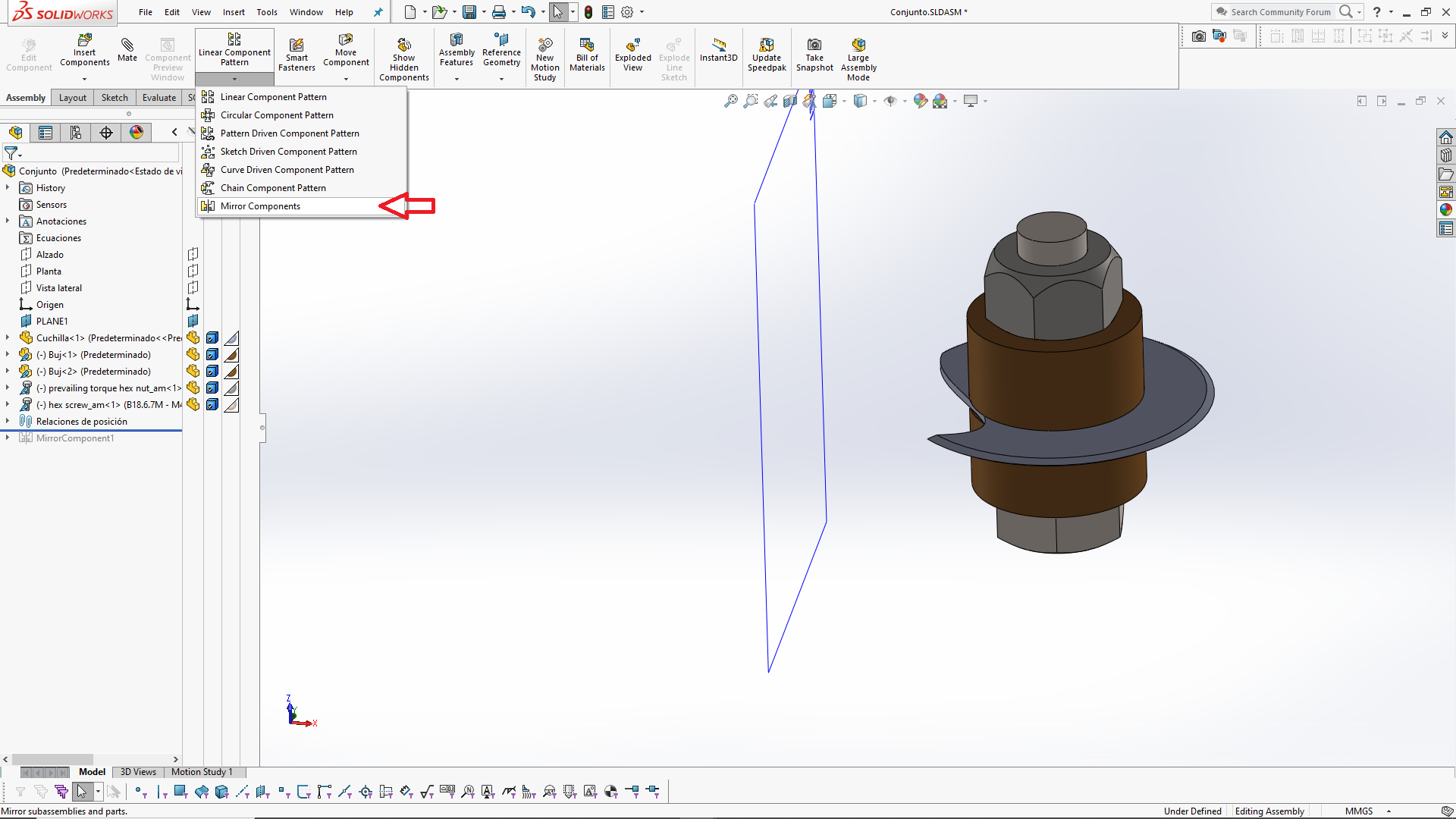

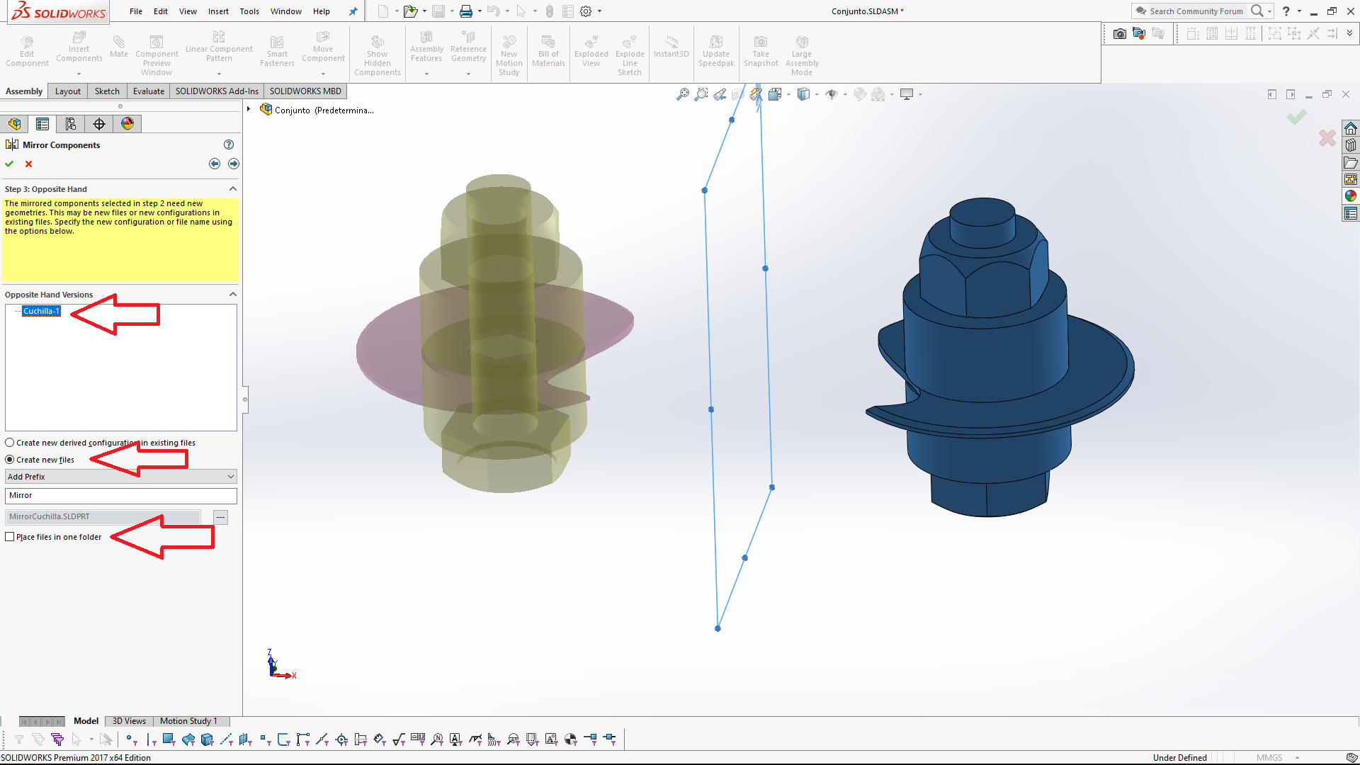

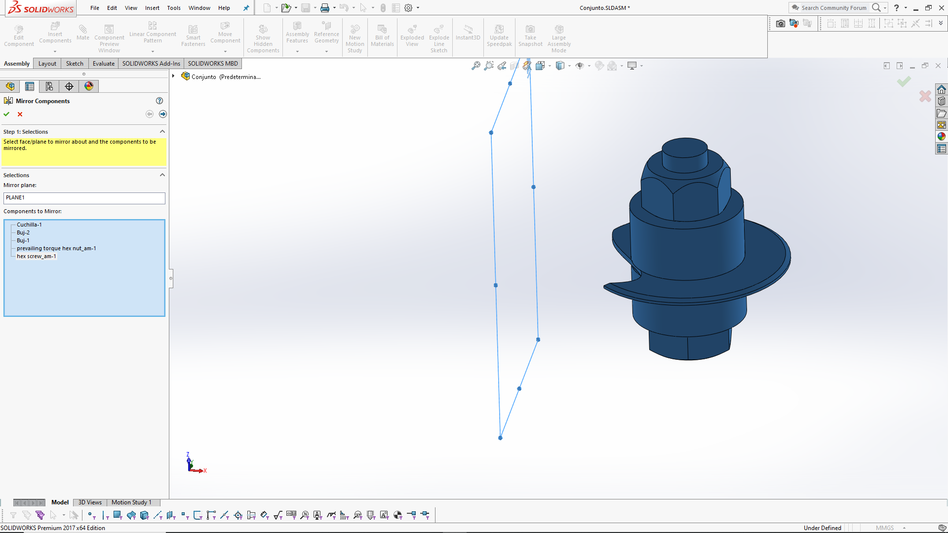

Define the plane for the mirror and select all the components that interest you. Then follow the steps to control other details (including the names and locations of the new files, or if they will be configurations within the existing ones).
