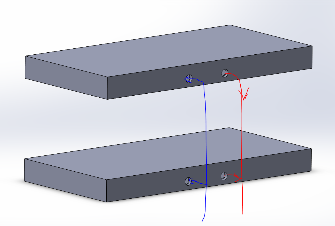

Hi, i'm trying to use the solid-works (2013) piping feature, but unfortunately i couldn't find a 0.25in fitting to start my piping route. I've also attached a photo showing what i want to do.
I need to prep this for fluids analysis. The liquid comes through the blue line into both blocks and leaves through the red line(parallel connection). I thought solid-works might have a feature where we can draw a 3D sketch and convert that in to a pipe, but i was unable to find such thing.
Thanks in advance for your help.

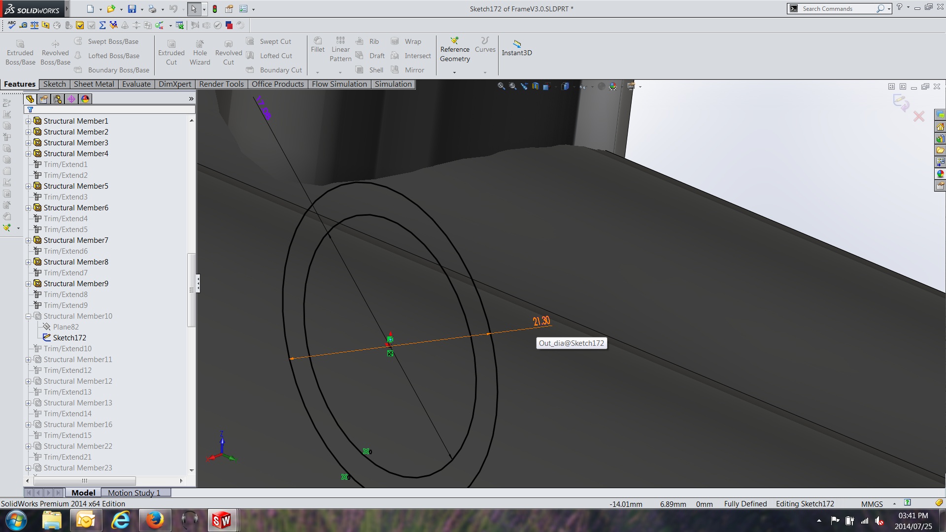

Use 3D sketch along with weldment.
You can change the size of a weldment after creating it. Use a 3d sketch to get the shape of your pipe. Apply weldments. Edit the sketch feature of the weldment and then resize your pipe. Also start of with a larger initial sketch and shrink that down to your desired pipe length and diameter.
See images attached.
