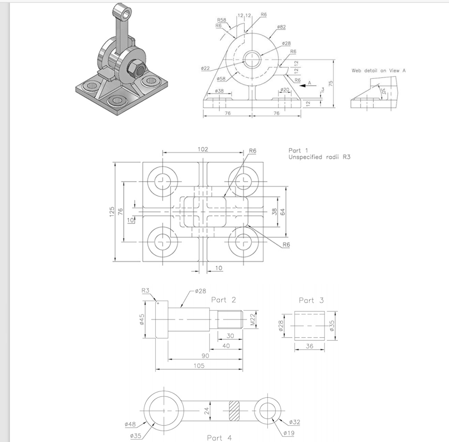

Can anyone make the design of the square-based rocker arm below? Or tutorial of the design is good enough. I cant seem to find any reference for the design.
with a quick glance, I think there is enough information to model it. But if you have design something based on this, you need to do it yourself because there is no specifications, applications or any related information here. Designing is different from modelling.

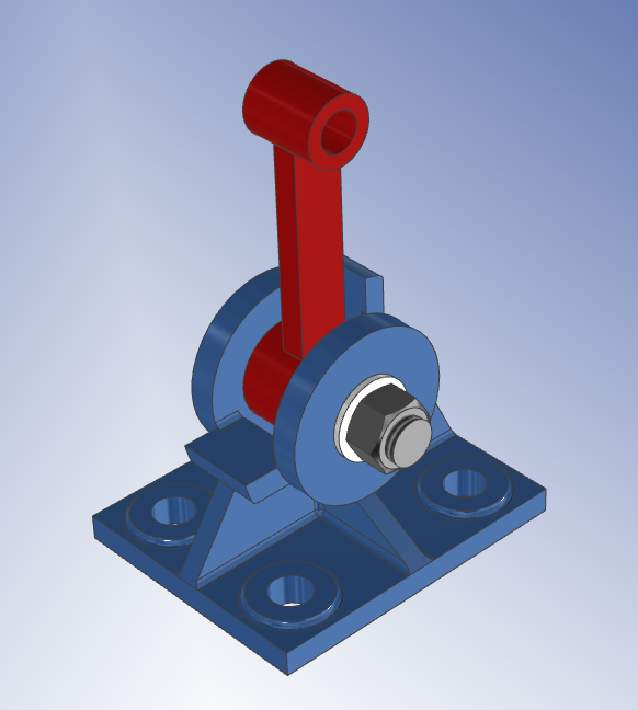

Here´s a Step file hope it helps. some measurements are guessed ( Rocker Arm)
