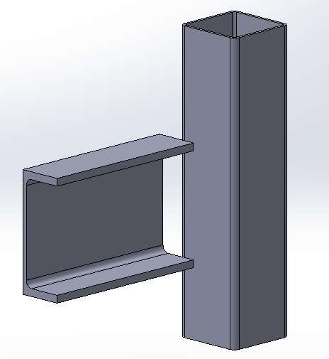

I have to create a balcony structure with steel profiles RHS and UAP.
The problem is the connection between this two profiles (see atteched image)
Can you help me please? Can you say me what is/are the best connection for this case?

The perspective of the view makes it difficult to determine how close the parts are, but welding would be a common method used to connect structural steel parts.
Der all
Trank you very much for your help. I considered the version with plate and bolts. This was better for the assembly.
