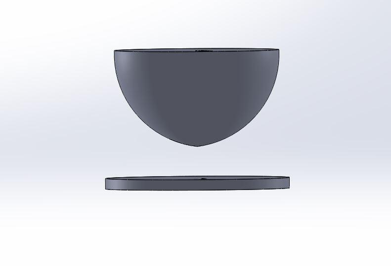

To make an object on an object
Any of the programs I can do to form an object on another body

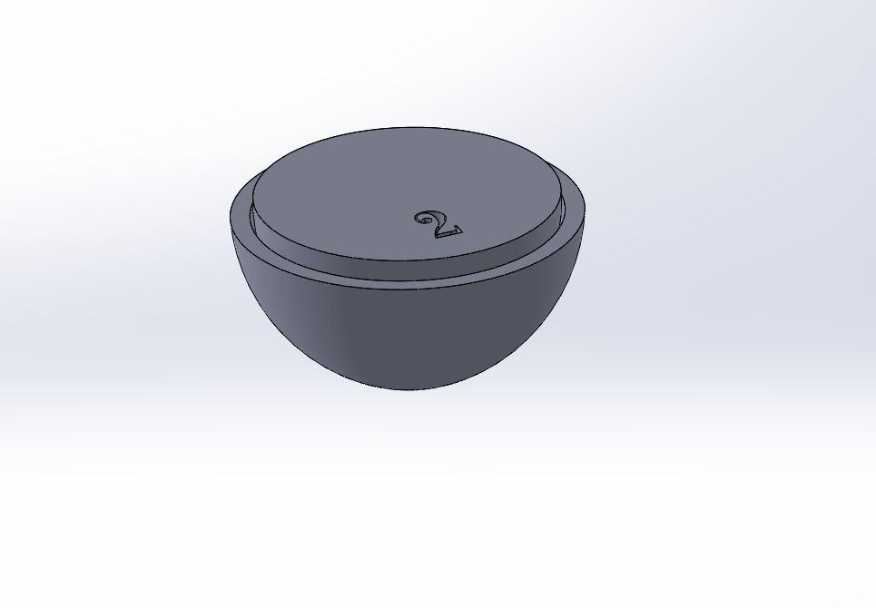

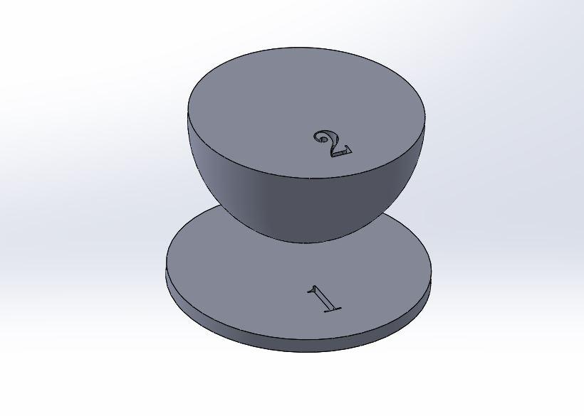

As shown in the picture, I create a solid number one, then push it on body number two and take the same shape
I paint flat and then take any other shape

Are you wanting the solid to 'morph' into the next shape? As in, it would begin as a flat disc (1), and an animation would show the flat disc moving upward and conforming into the shape of #2?
Check out this video and see if it is similar to the outcome you are looking for?
https://www.youtube.com/watch?v=t1YGPHP_DbE
Program from video is Cinema 4D
There are users very skilled in animations and post processing, hopefully they can chime in.
Maybe check this stamping add-on for SOLIDWORKS?
https://www.3dquicktools.com/
