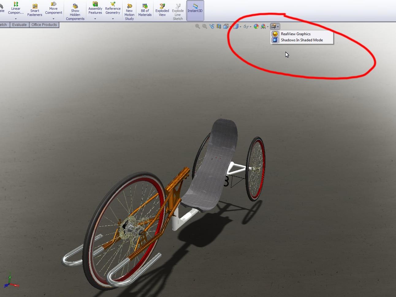

Robert I say the opposite. I think using real view makes you look like a novice. What's the purpose of real view anyways?
You must be novice with SW :)

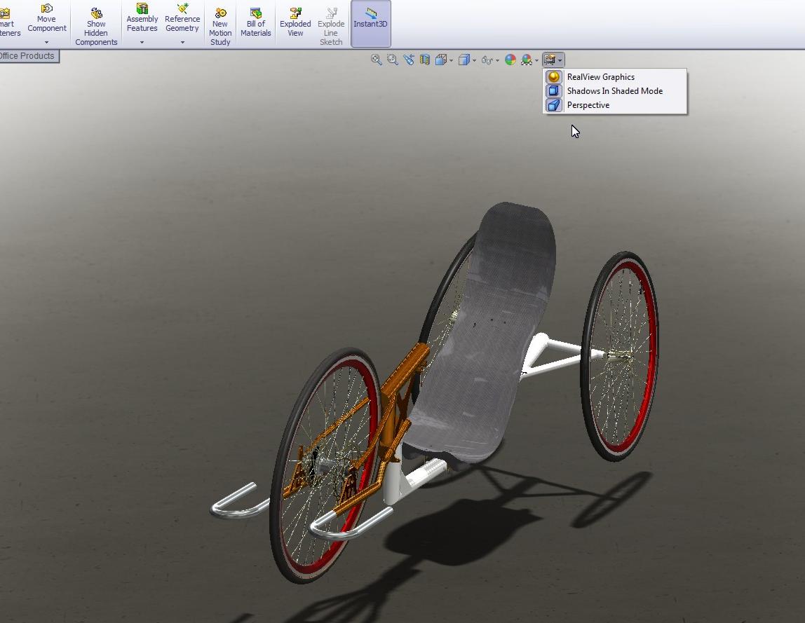

If you turn "on" the "Real View" option, it gives you photorealistic appearance while you work on the model :)

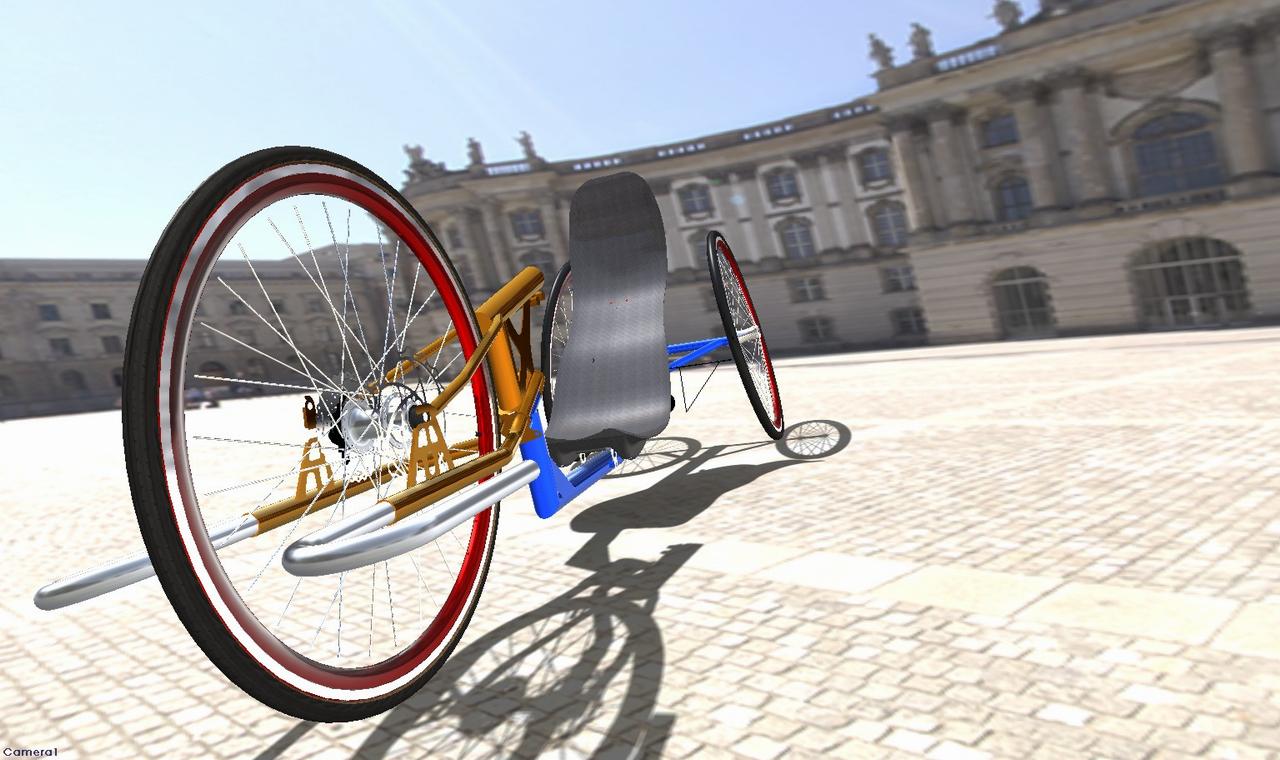

Here are two examples, one is with perspective view, one with a camera view. With a good choice of camera setting (you can adjust it to your liking or have several cameras with different settings, you can get fabulous results in the native working environment - these are just cheap and dirty examples made within a minute ;)
BTW, I did not make renders, these are just screenshots
You can play to infinity... Add a scene, move the camera, view, image capture -screen capture, open an image editor app, copy/add from clipboard, resize/crop and Voila!
