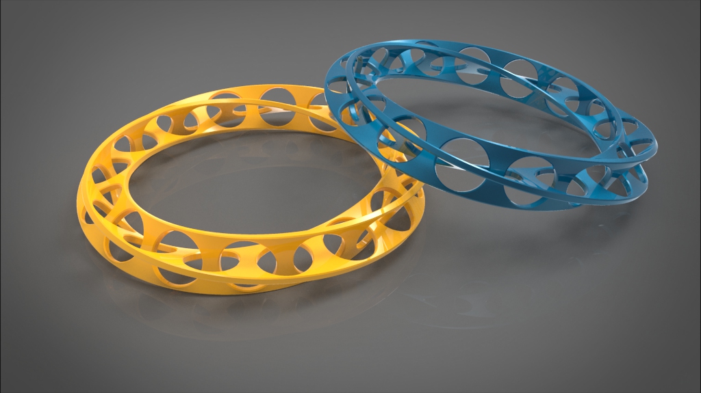

Tutorial: How to model self intersecting Möbius strip

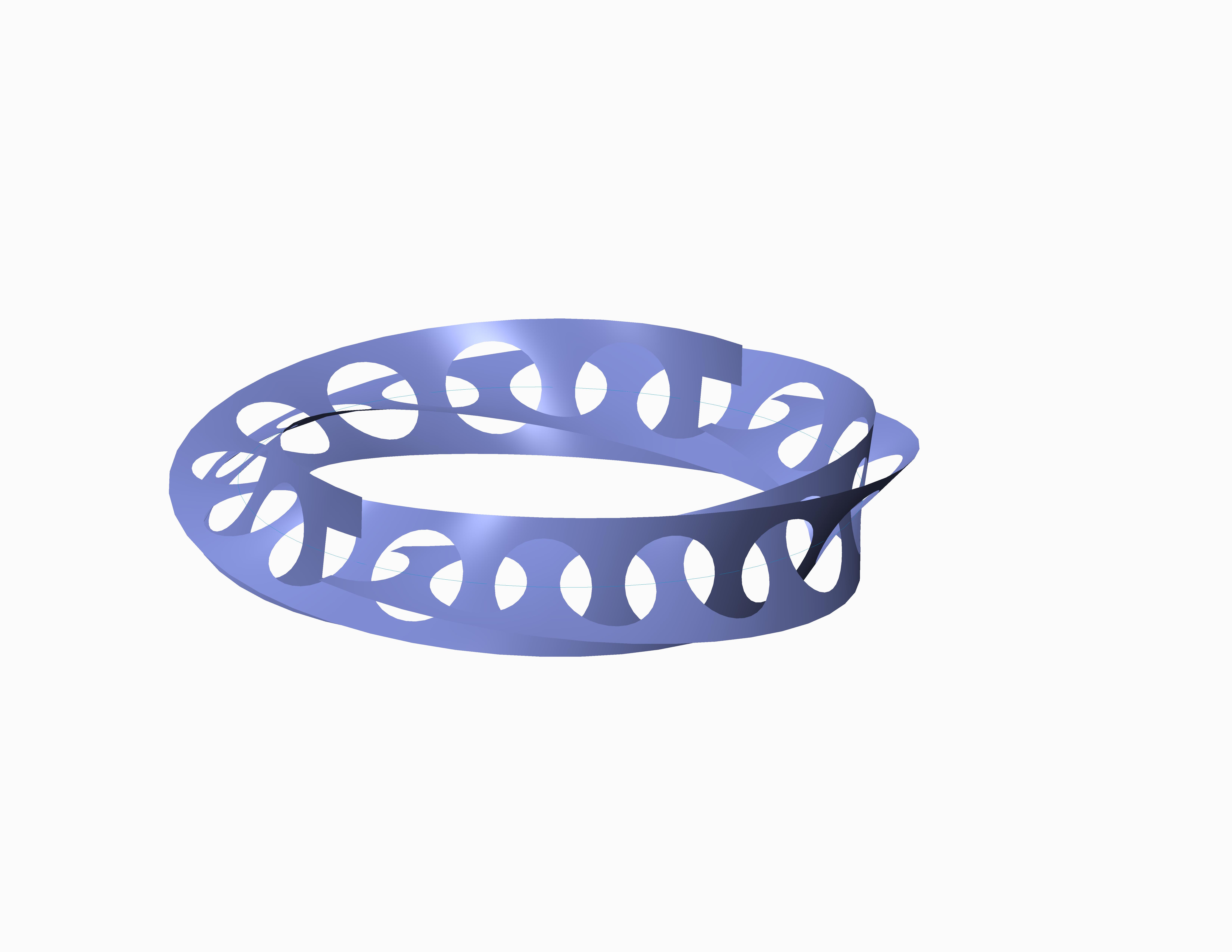

My version of Möbius chain strip

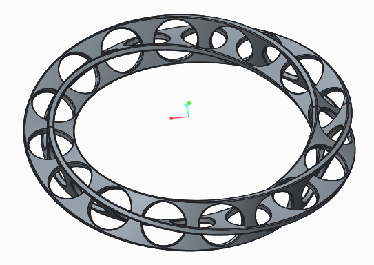

Möbius chain bracelet v2
14 Answers
Create object like mobius strip is simple, and should be divided into separate operations.
Answered with a tutorial: https://grabcad.com/tutorials/tutorial-how-to-model-self-intersecting-mobius-strip

Good tut, it made me practice a bit surfaces where I'm not really trained.
good tutorial, BUT you could specify for the beginners (with surfaces), that when extruding the second surface on the second half circle, you may NOT project the line, but construct a new one and dimension it, otherwise you will get just errors or a reference dimension that couldn-t help you finishing the formula or making the Sweep.

Hi, I have tried this, but I am not able get step 12 & 13.
When I rotate using Z axis by 180deg, it's not mating with the existing surface.
So i'm stuck on 2 and 3, i don't understand by what you mean to change the trajectory to half circle. Also on 3 how do you change the dimensions command I've never done that before. When i try to look it up nothing is helping to explain what to do.
ok i figured those two parts out how do u do step 7
