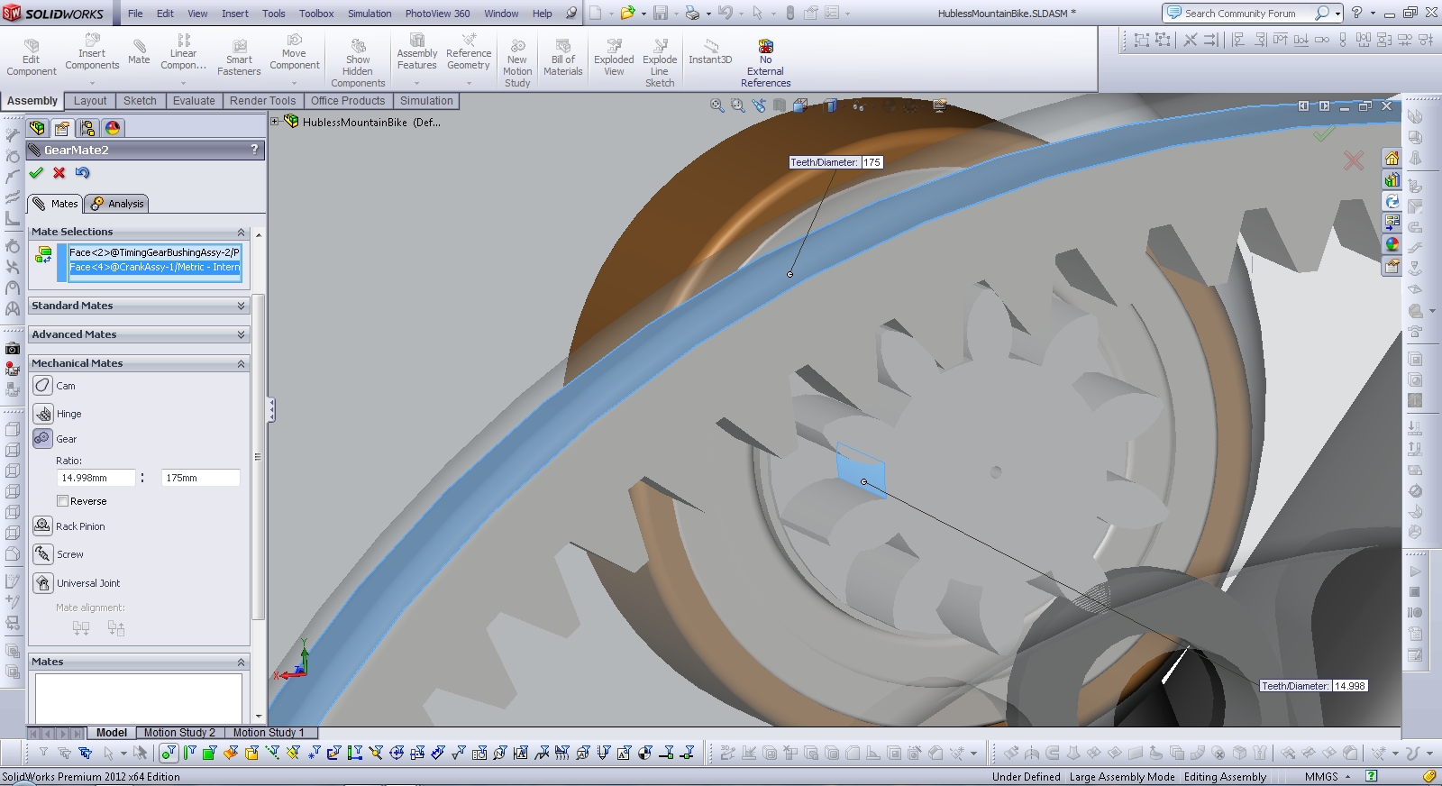

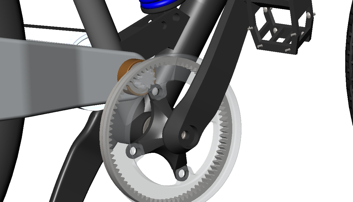

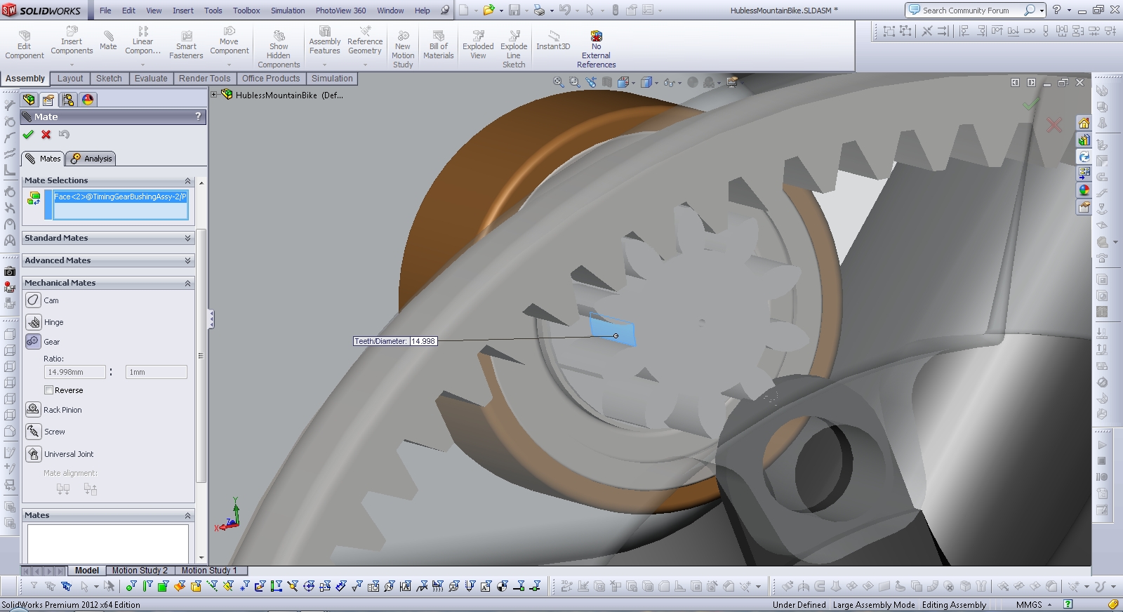

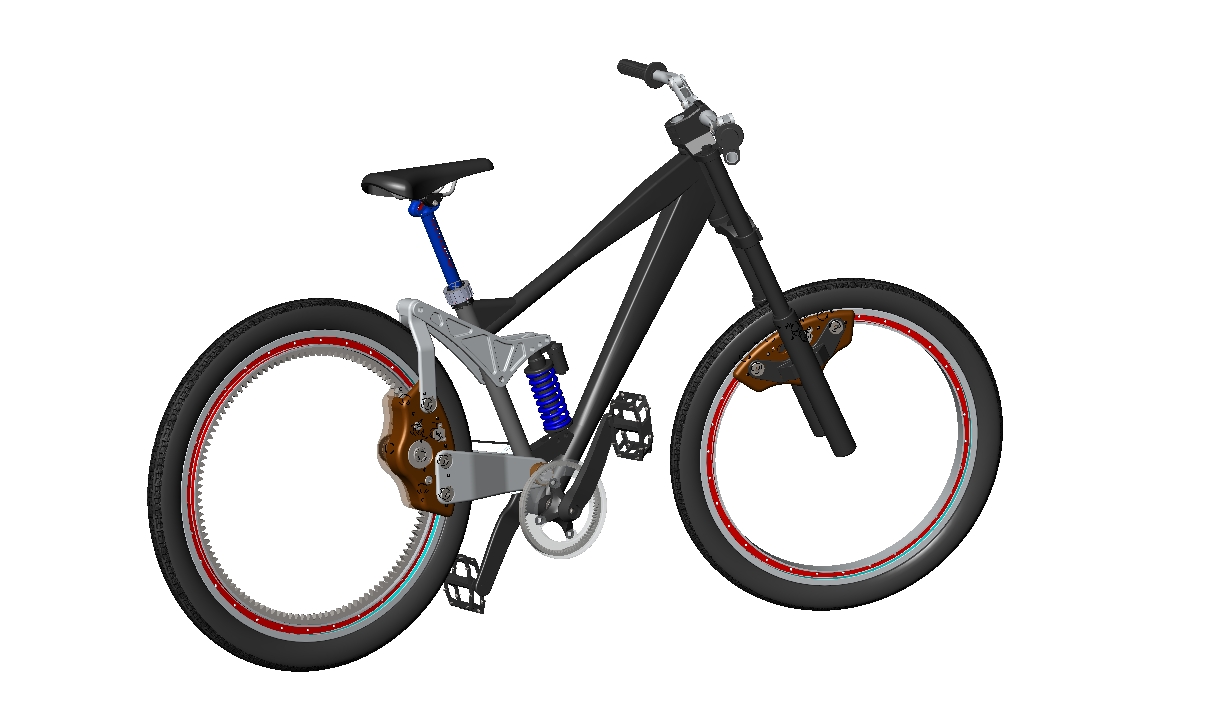

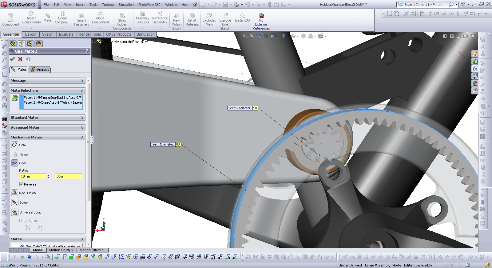

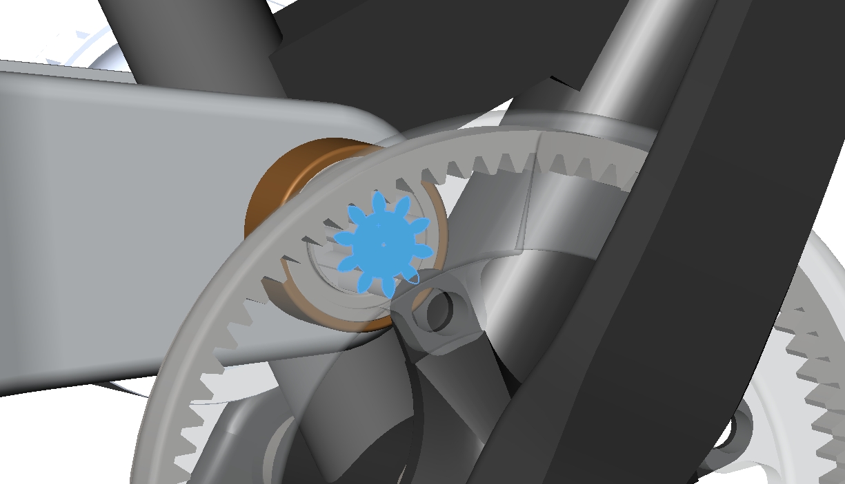

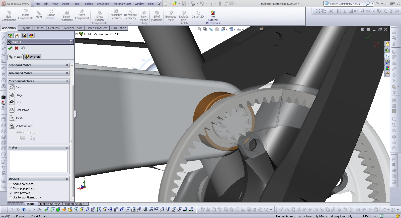

Tutorial - how to use mechanical mates in solidworks Tom Martin 7 Jun, 2013 05:12 PM Tip to use mechanical mates in Solidworks using "gear". In this case I have my most popular model "Hubless Mountain Bike" I have hundreds of mates in this model which are also layered with sub assemblies. The Mechanical mate I found the most useful. Hubless Mountain Bike Concept bike1.jpg bike2.jpg bike3.jpg bike4.jpg bike5.jpg bike6.jpg bike7.jpg 1 Answer Rasesh Palav Answered on 9 Aug, 2013 04:45 AM http://www.youtube.com/watch?v=Oupme_s5uZg
