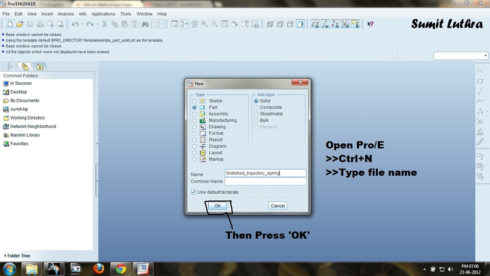

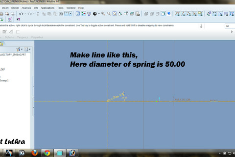

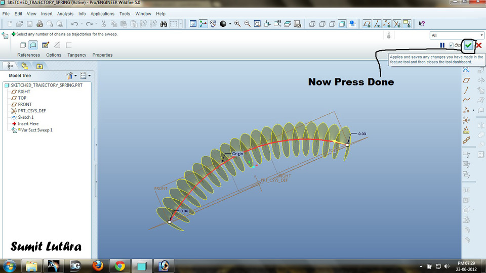

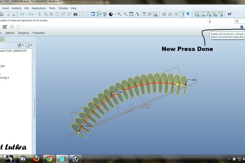

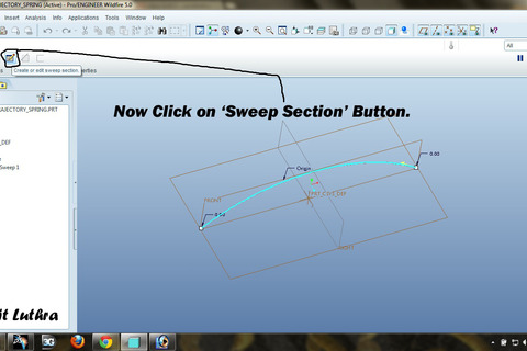

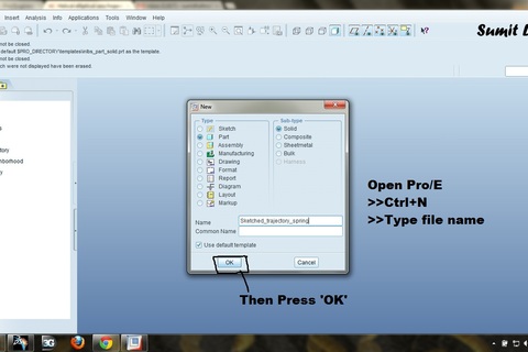

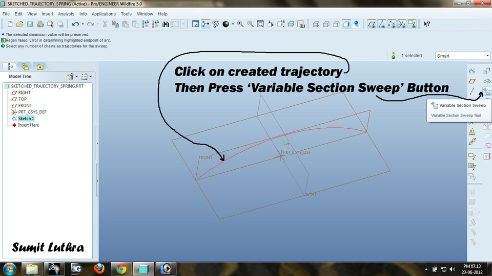

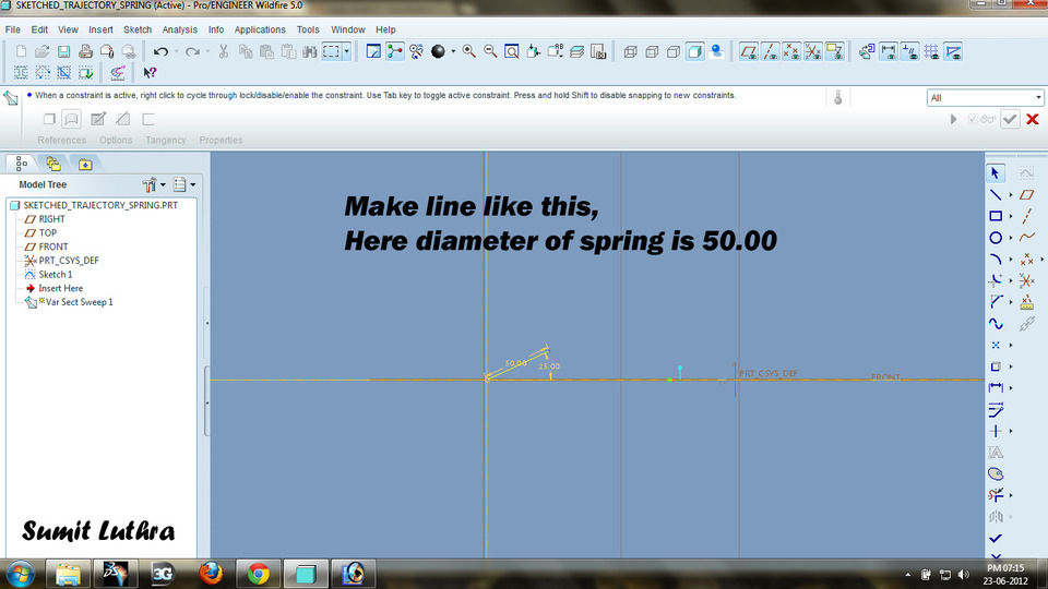

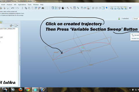

Tutorial: Modelling spring having any given trajectory in Pro/E
We can model spring in Pro/E and Creo having any axial trajectory through this tutorial.

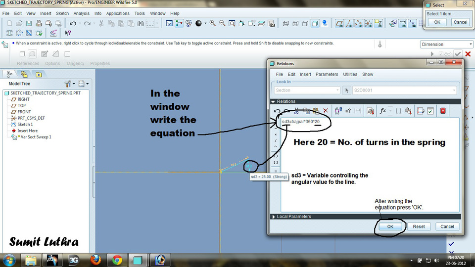

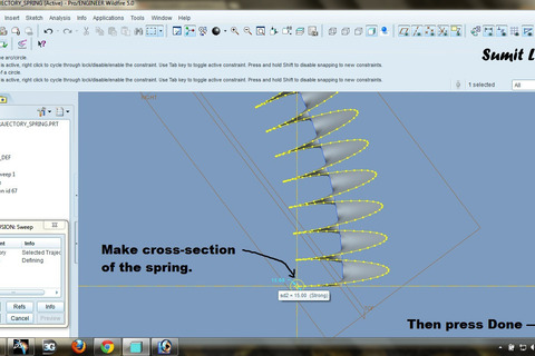

""""umar yazdani
i am having problem in equation part"""

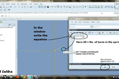

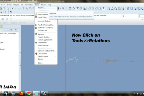

Sd#=trajpar*360*a
Sd# : twist angle
a : number of twist
excellent tutorial bro. Bro i want to learn Sheet Metal in Pro E - 5.0. Can u help me on this tutorial - Rply
Thank you buddy........ it works very well
But give the formula clearly... the formula is (sd3=Trajpar*360*20)
