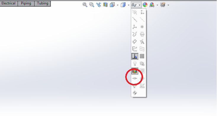

Hi,
I need add tubing routing in my assembly. The assembly is create by using number of sub assembles and i want routing through different sub assembles. but when i try to show routing points the icon (show routing points) is dim,, How can i solve this?.
Thank you.
Manupriya.
Hi, Manupriya.
the best way so you can use the route points of the sub assemblies, would create new points on the upper level of your assembly to click this route, route tools, create route point or connection.
best regards.
