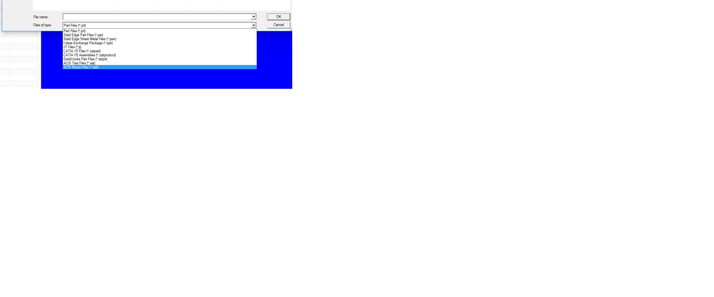

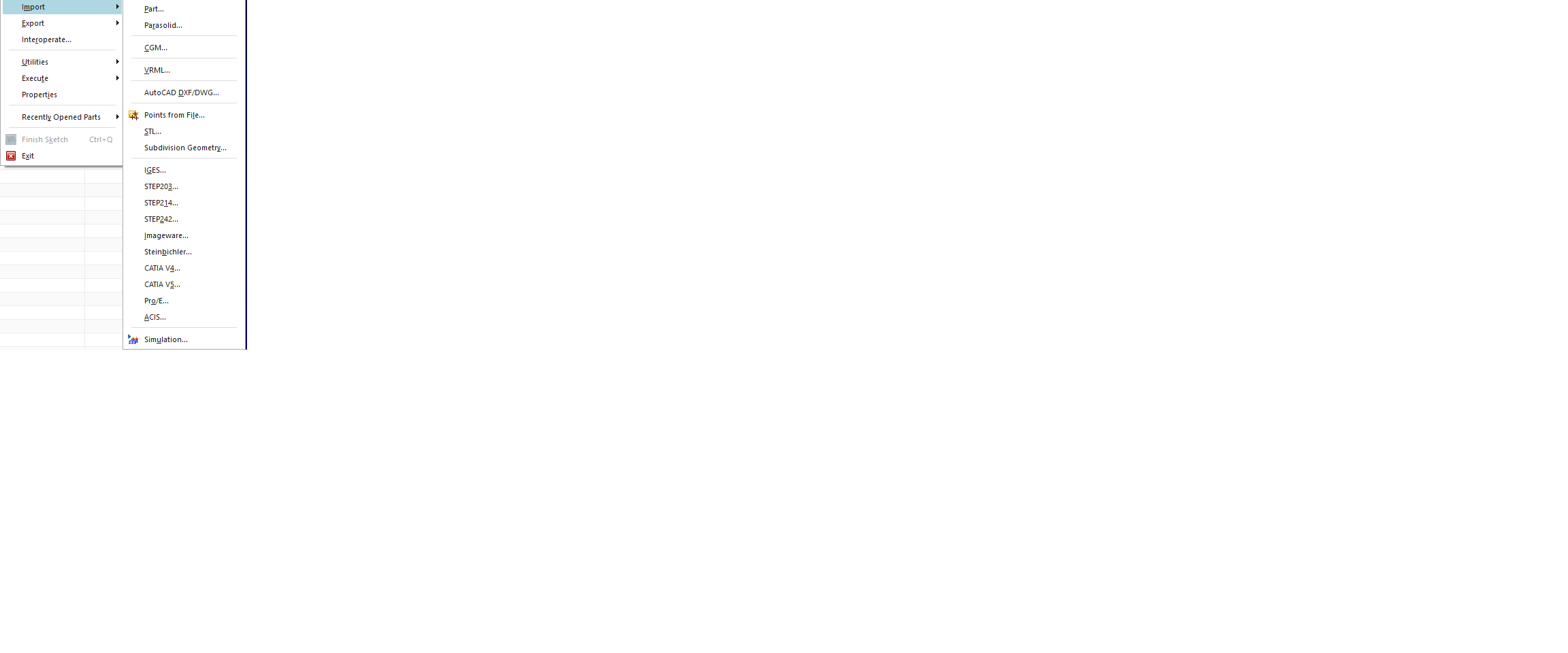

what types of files can we import in unigraphics for read and read and write both? CAD Zest 26 Dec, 2017 11:54 AM what types of files can be imported in unigraphics and can edited as well? please and in details. 2 Answer cmalco Answered on 26 Dec, 2017 12:16 PM Numerous... As for editing... I'll assume you mean, history tree editing? Only native file types. Synchronous and Realize Shape modules allow for manipulation of facet, sub-d and other formats. import2.png import_1.png Dalwadi Answered on 27 Dec, 2017 06:57 PM So many files u can import or open. For editing purposes go menu>insert>synchronous modeling In this u can modify.
