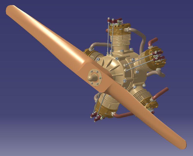

7 Cylinder Radial Engine - with Dimensions
Here I have a PDF. but not all dimensions are complete. It is extensive enough to be a project and sometimes challenging enough to find the dimensions on your own.

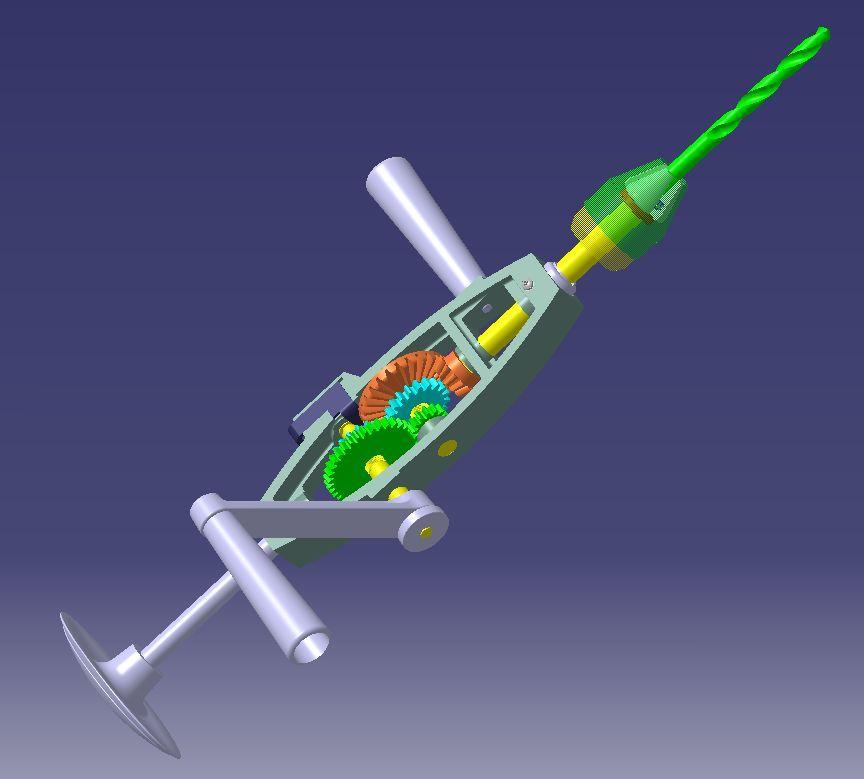

Also you can develop something like attached picture.
