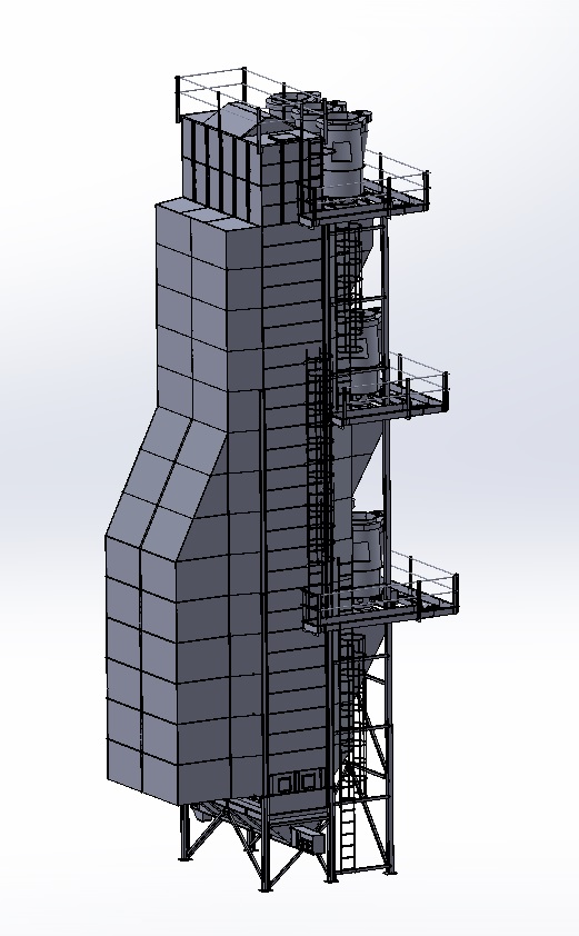

I am working with Solidworks professional latest version and I am making grain dryers, coolers, conveyors etc. And I want to make grain flow videos. Can anyone suggest any program for that?
