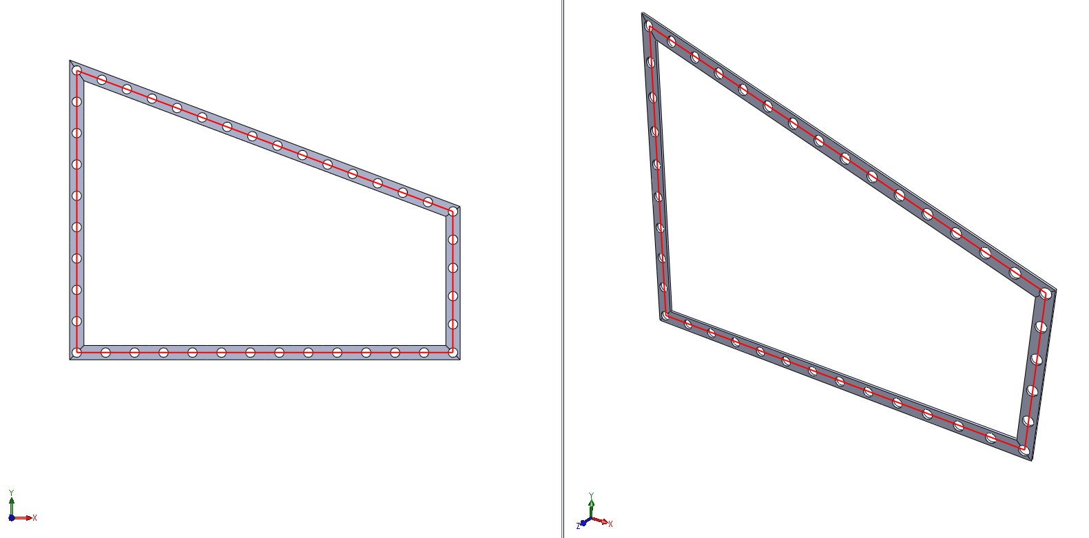

this image appears to contain a 2D geometry of a strip and polygons. if you like to make a building frame that resemble this geometry, all what you have to do is tracing the orthogonal lines of this figure in picture in a sketch environment, then copy that sketch somewhere else and make it independent sketch. then create a new assembly file, place that sketch inside it and use the frame generator to generate the parts (either tubes or pipes).

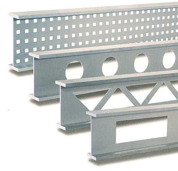

Are you wanting to do something like what is shown in these "lightened" profiles? That is, draw the lines of the structure and then assign them profiles like that?

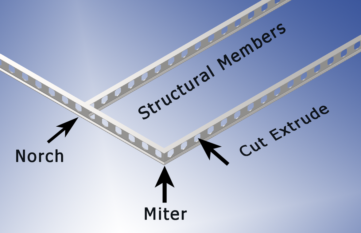

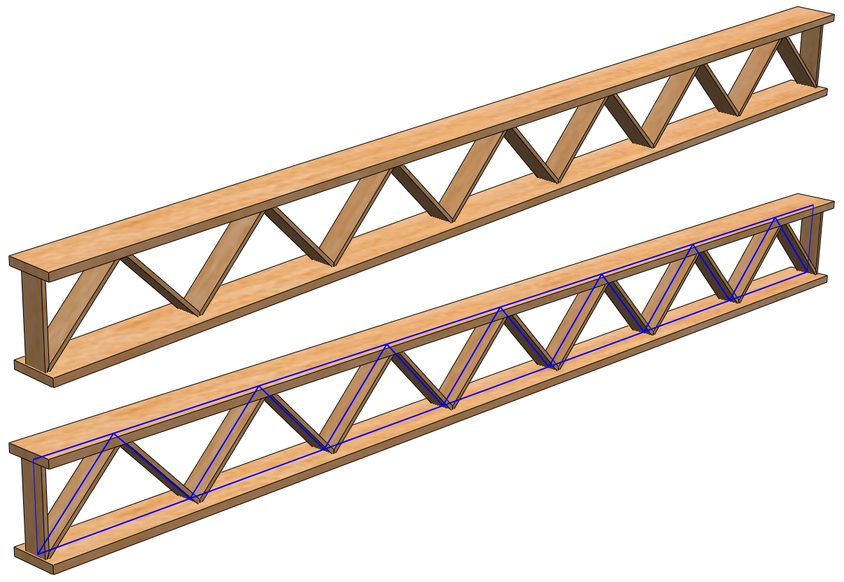

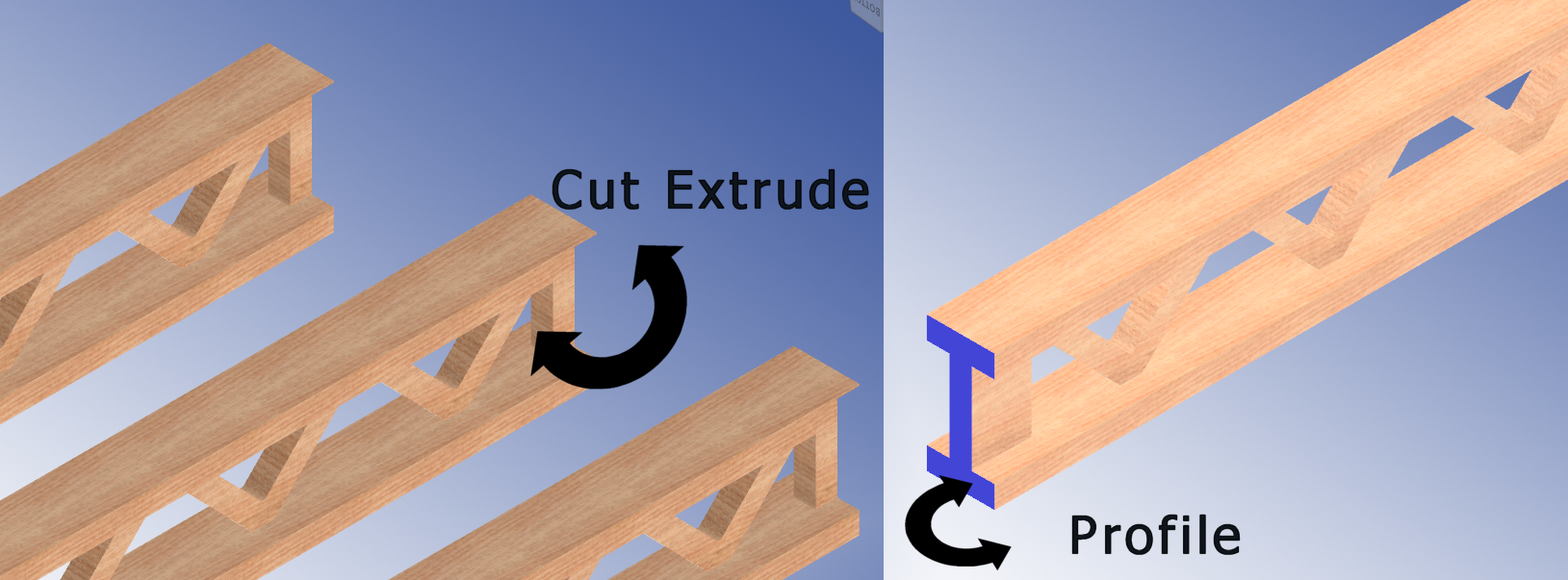

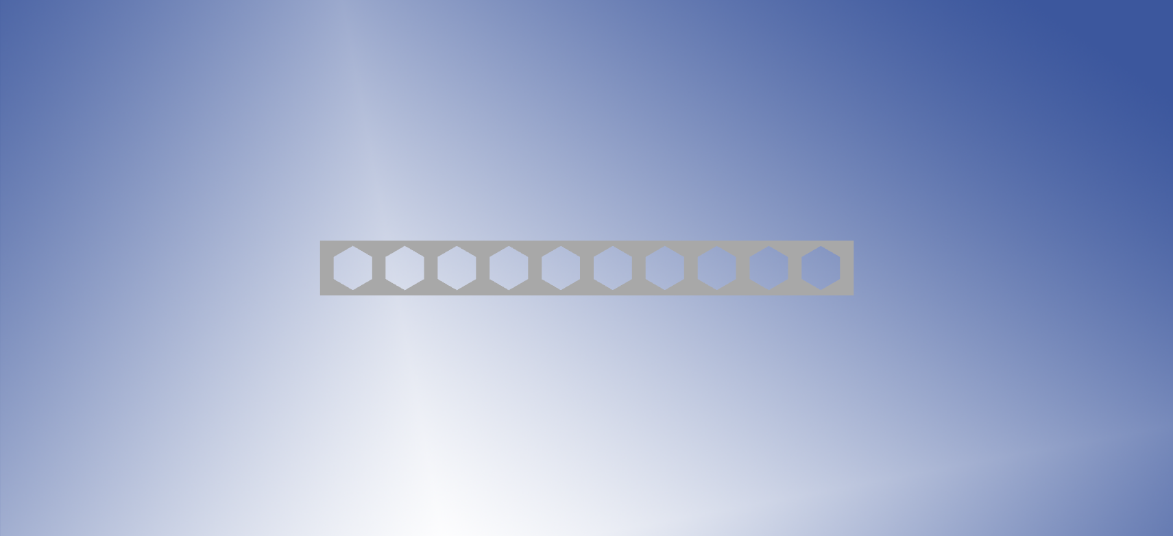

Ok I could not find the solution so this is what I did made a profile in my Library placed into my assembly then opened the part and made a cut extrude to get the shape I wanted.
This is what I wanted.......
