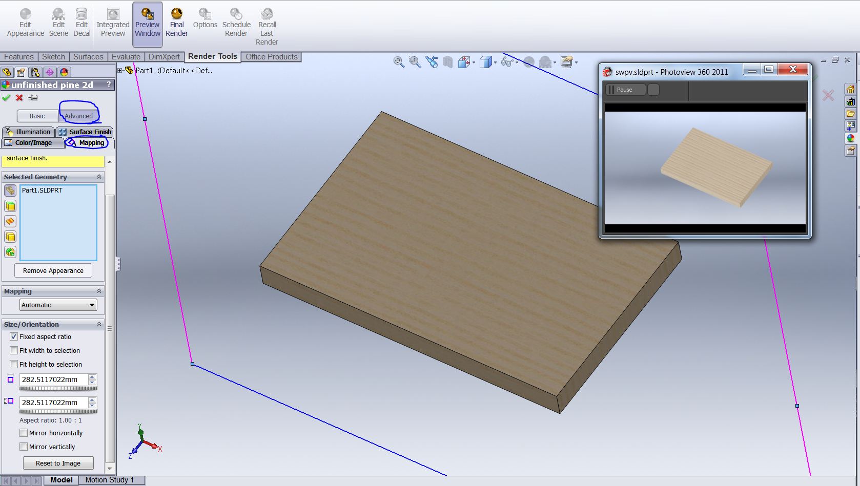

I am having problems on placing wood appearance on a board in SLD2012.
when I apply unfinished pine to a face of board on the render view it appears ok, but when I go back to sld normal view and back again to the render view the grain change, and become horizontal instead of vertical. I don't know the how to "lock the wood grain direction". Can any one help me?

You could use the Mapping feature and set the grain size...see if it works...
Comments 1
Yes, you can go to mapping feature and you can also change the angle of the grain. I have this problem at times, so the best results i always get is to add the material to the face only.
