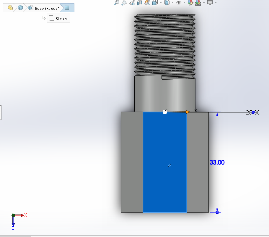

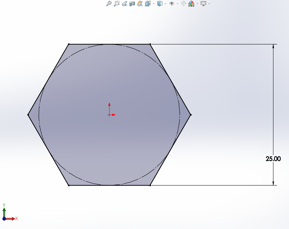

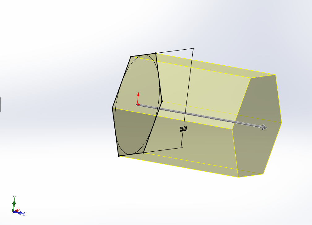

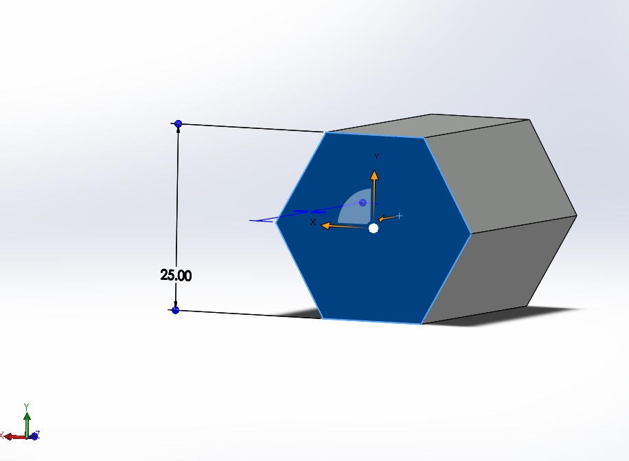

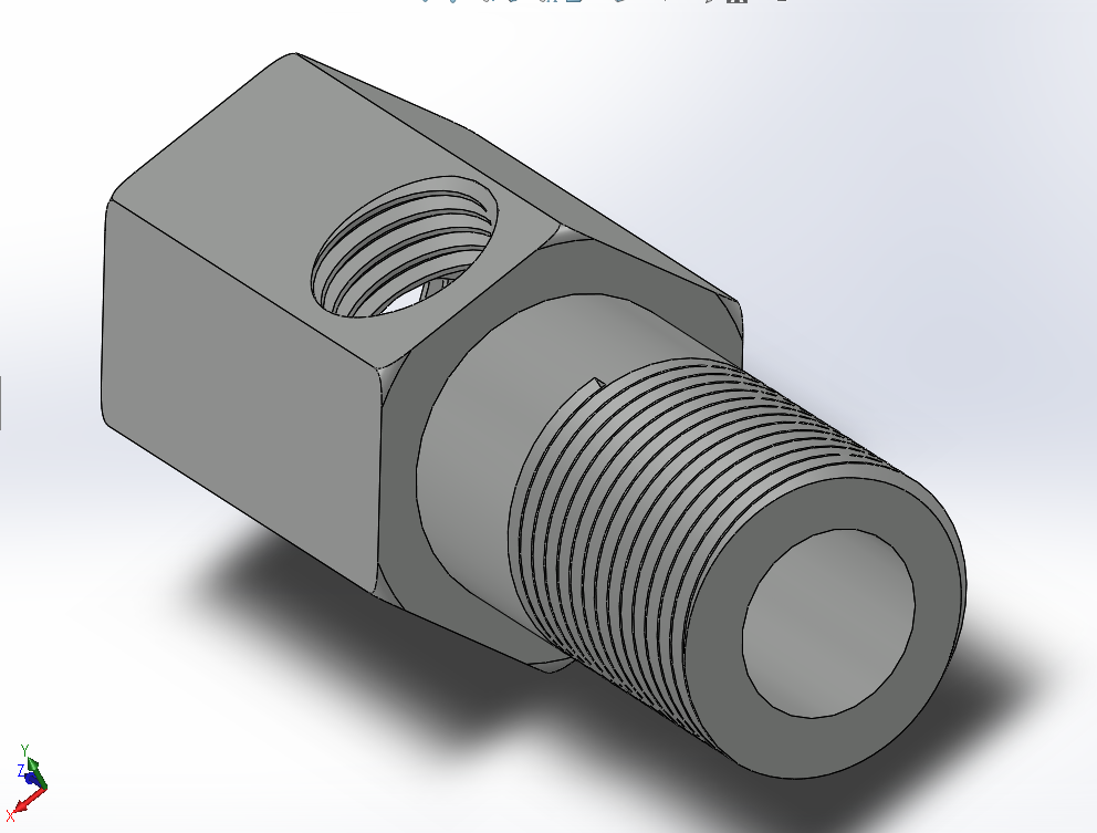

  1. Step 1:
    Create a profile of Hexagon with desired dimension on the Front Plane.
    For me the Inscribed circle diameter 25 mm.
    Perform Extruded boss with the sketched profile.
    Direction dimension: 33mm

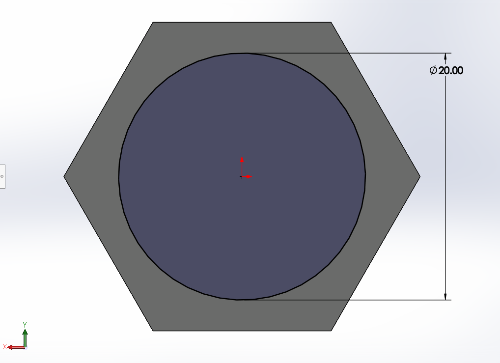

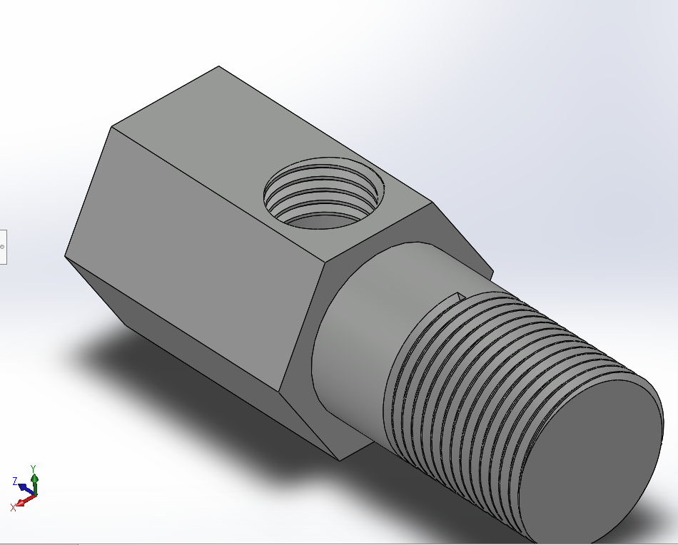

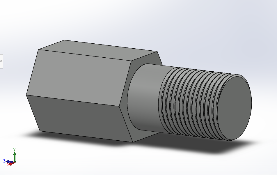

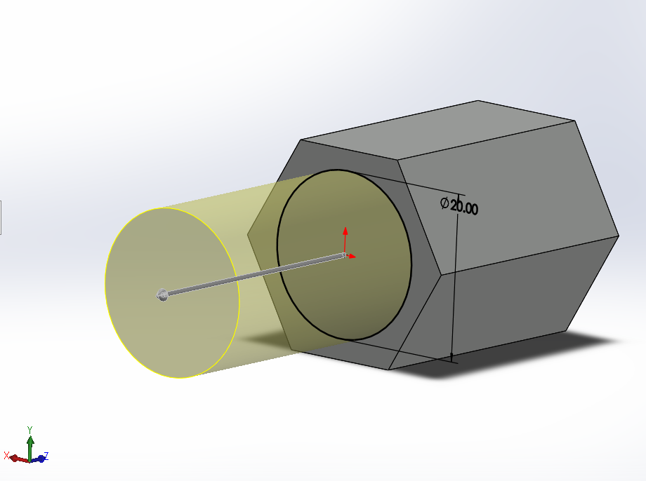

  2. Step 2:
    Select one of the end faces and Sketch.
    Draw a concentric circle of diameter 20 mm with the inscribed circle of the Hexagon.
    Perform Extrude boss with dimension 32 mm.

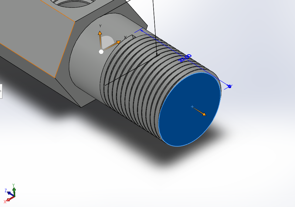

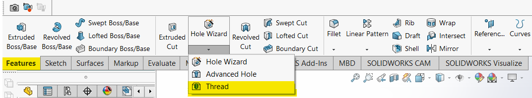

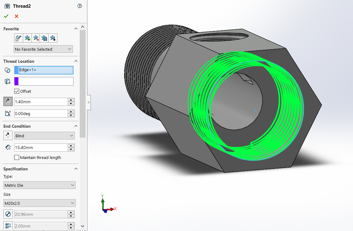

  3. Step 3:

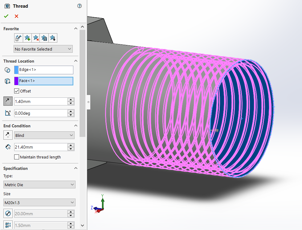

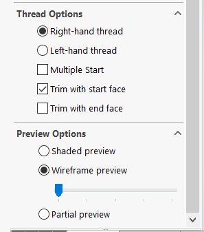

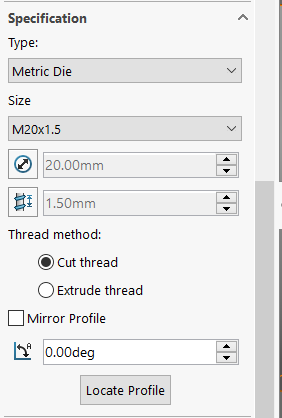

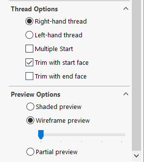

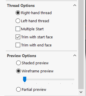

    Time to create some thread. Select Thread feature.
    On Thread Location:
    • Select the edge of the cylindrical part (Edge 1)
    • Select the end face of that part (face 1)
    • Tick offset (1.4mm) [ Its required to trim with starting face]
    • End condition: Blind - 21.4mm [total thread length - 19 mm]

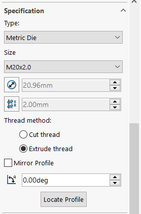

    Specification:
    • NOTE: for external thread use thread method Cut thread and for internal thread use Extrude Thread

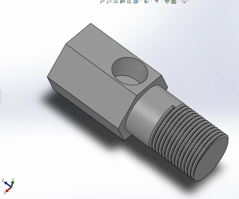

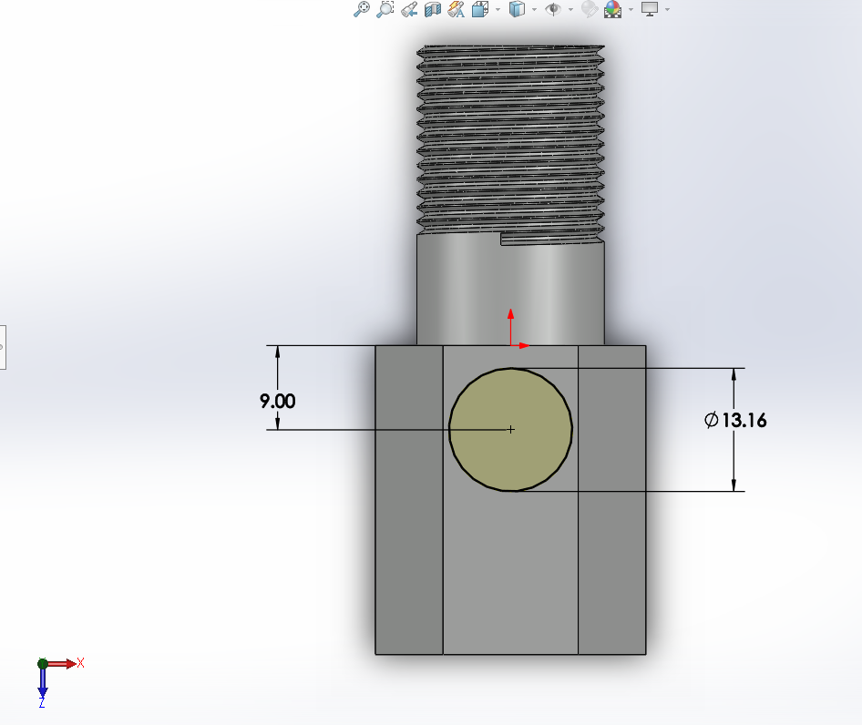

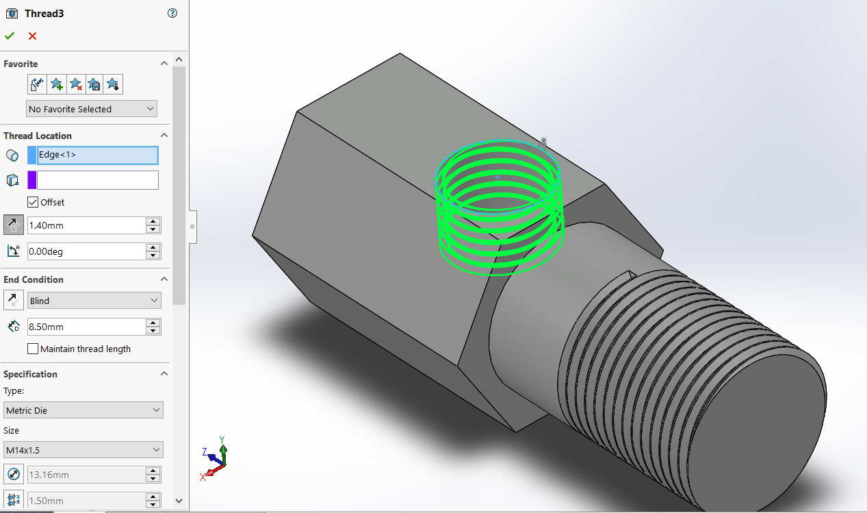

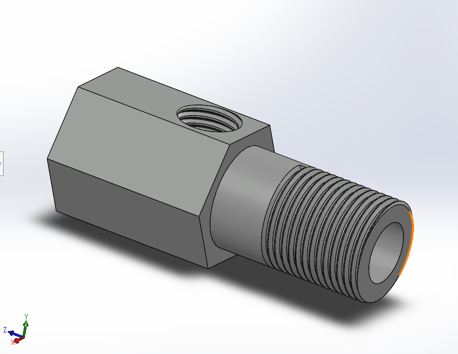

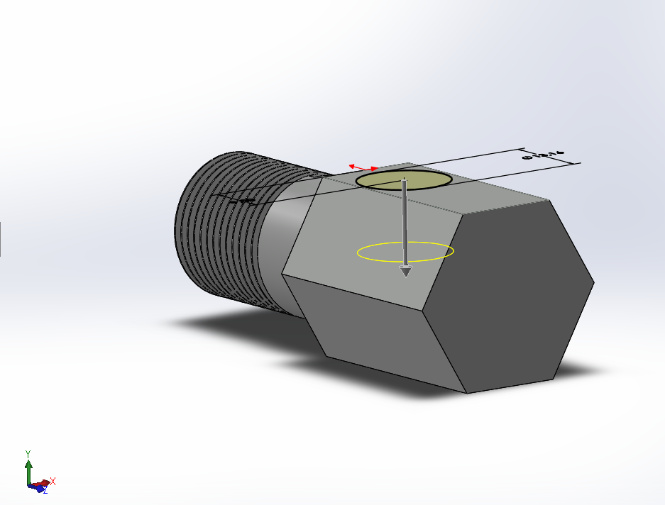

  4. Step 4:
    Select the top face of the Hexagon part and Sketch.
    Sketch a circle with detailed dimension.
    Perform Extrude cut with the sketched profile up the half way.
    Direction Dimension: 10mm

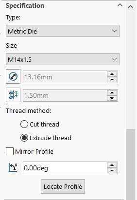

    Again we will use Thread Feature.

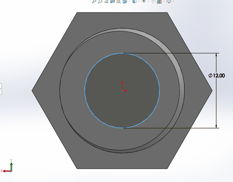

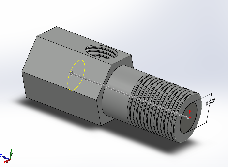

  5. Step 5:
    Select the end face and Sketch.
    Draw a concentric circle of diameter 12 mm.
    Perform Extruded Cut . Blind, Direction Dimension: at least 35mm

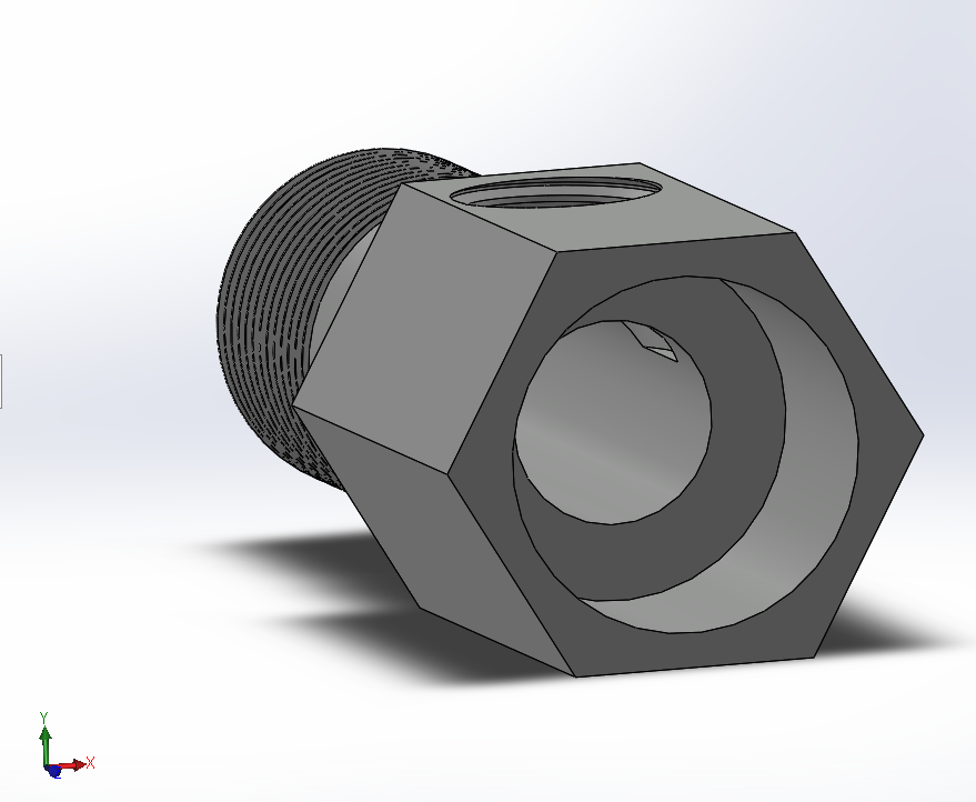

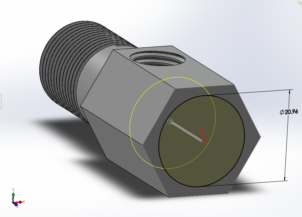

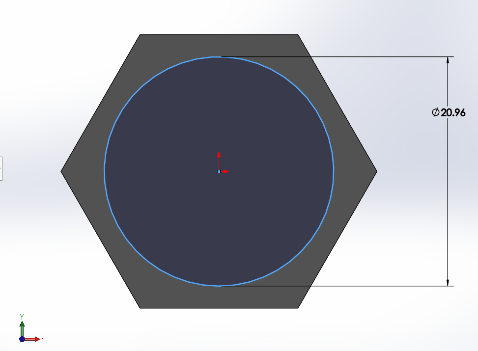

  6. Step 6:

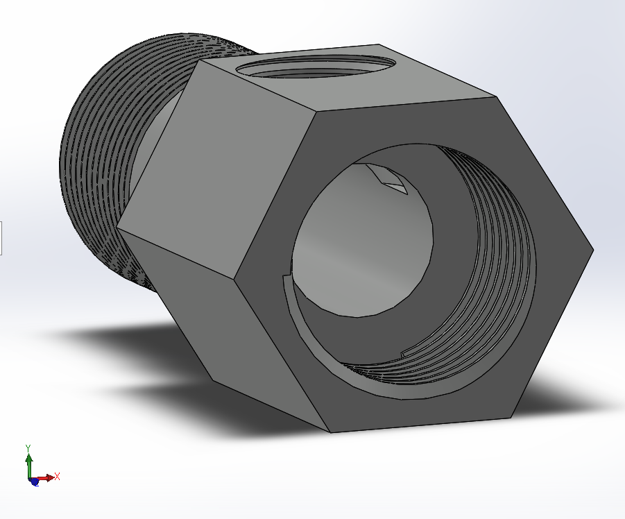

    Select end face of Hexagon and Sketch
    Draw a concentric circle of diameter 20.96mm.
    Perform Extruded cut - Blind - 15.4 mm
    Using Tread Feature for the Last time

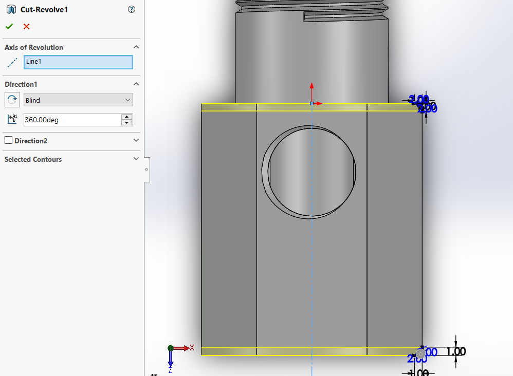

  7. Step 7:

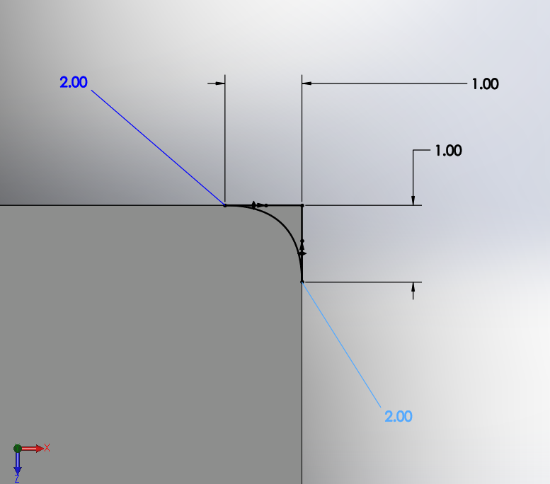

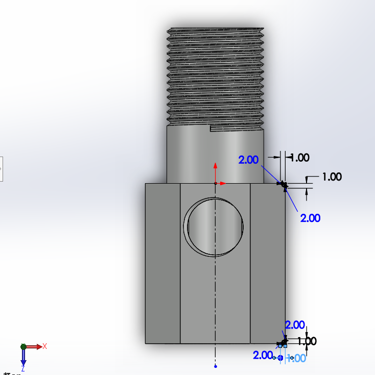

    Lets Round off the sharp edges.
    Select the Top Plane and Sketch.
    • draw a vertical construction line and profiles on the edge as shown below
    Perform Revolved Cut
    • Axis of Rotation: construction line of the sketch.
    So this is the Final product. Now you can export the model to SOLIDWORKS Visualize for randaring.
