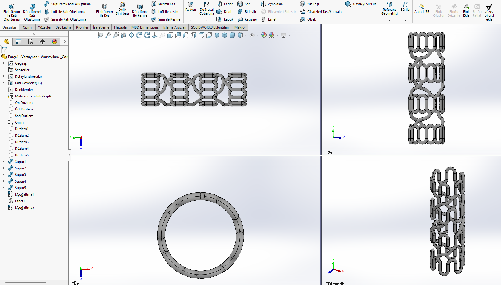

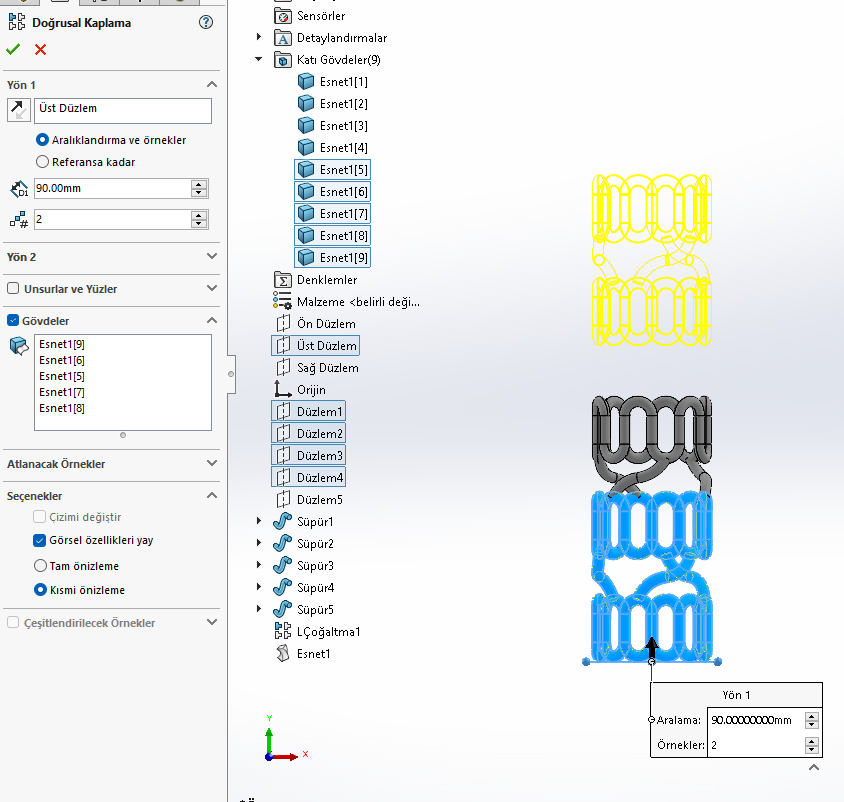

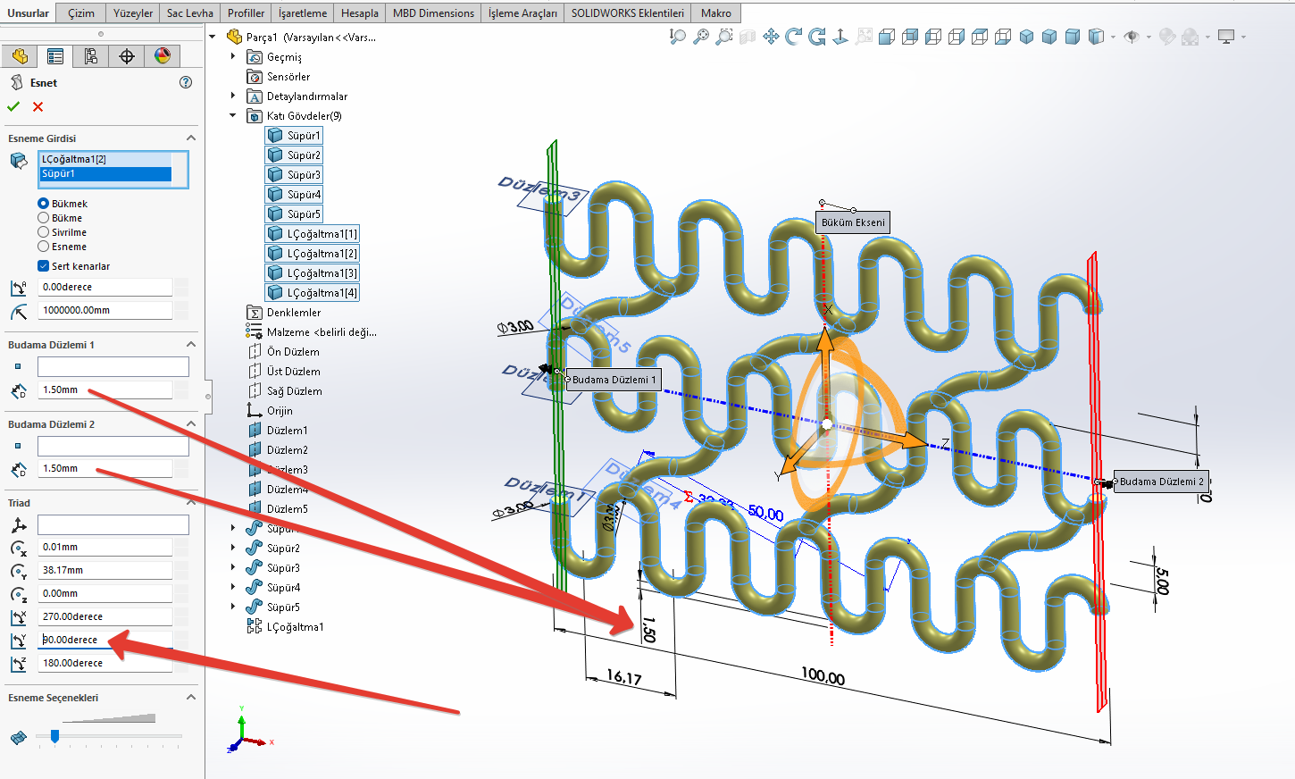

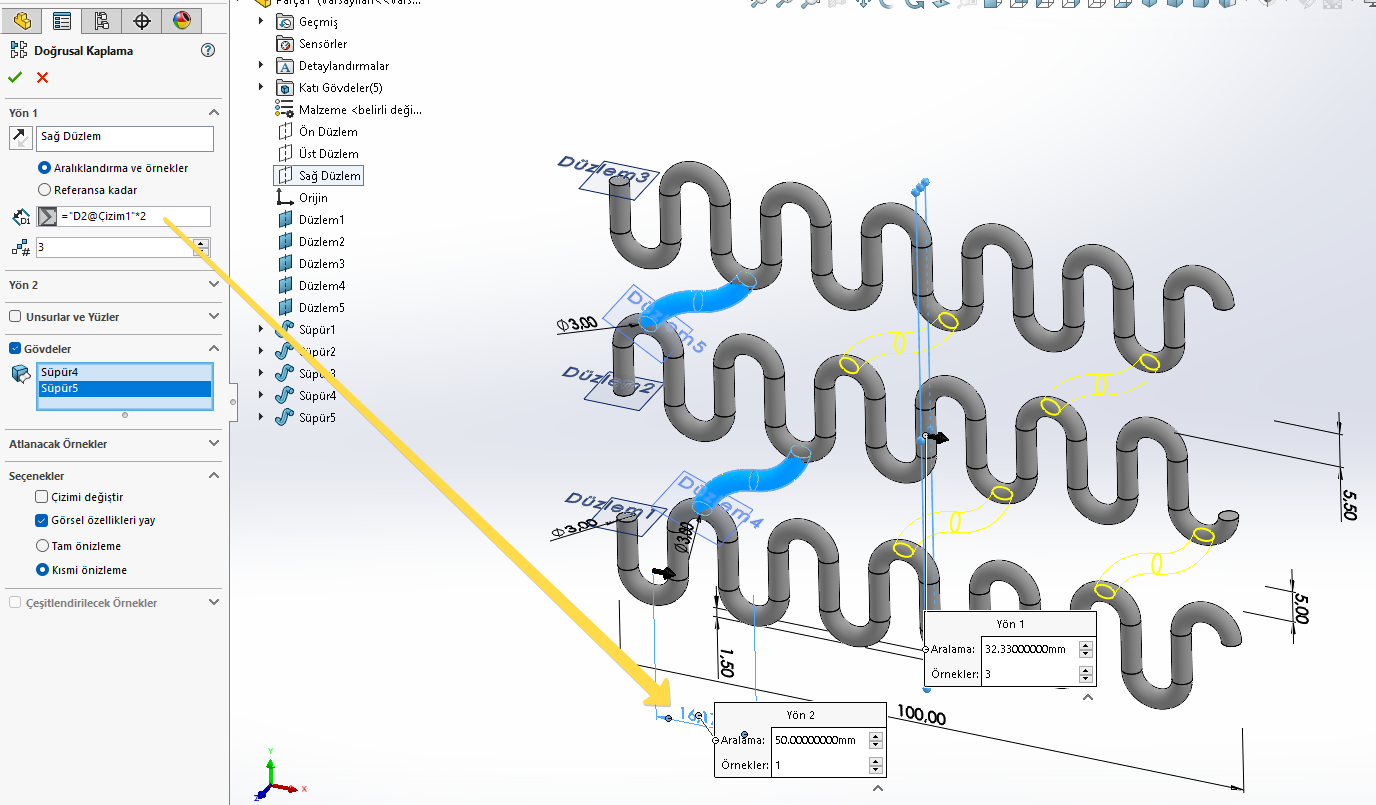

3D Stent Design
Frankly, although I think there may be better methods than this one, I think this method will meet the basic needs of students and at least give them an idea to find better methods.
The measurements are random, you should make adjustments with your own measurements. Remember, this is just to give you an idea.
For part link --> 3D Stent Design

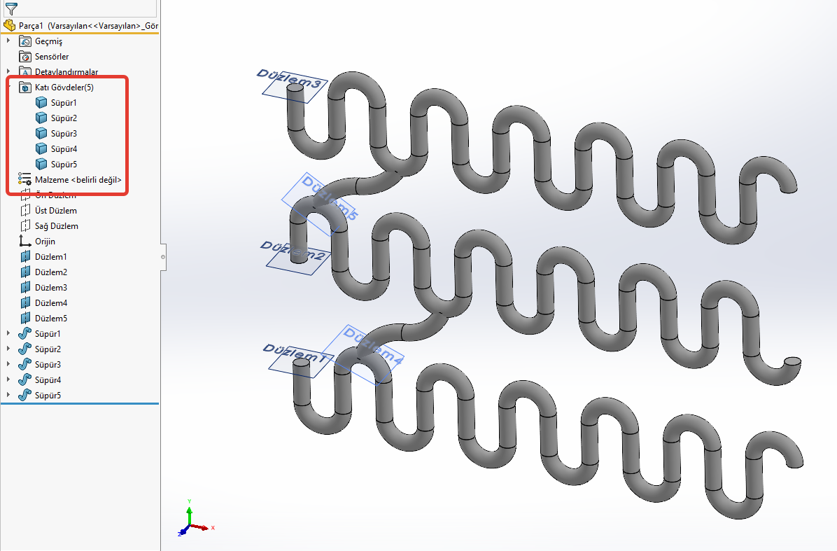

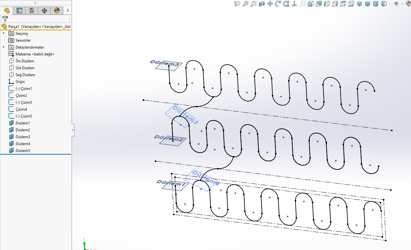

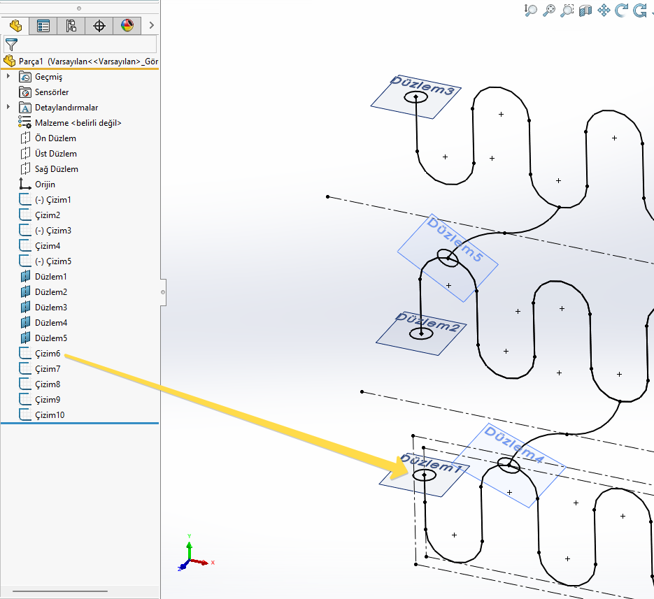

  1. Step 1:
  2. Step 2:
  3. Step 3:
  4. Step 4:
  5. Step 5:
  6. Step 6:
  7. Step 7:
  8. Step 8:
  9. Step 9:

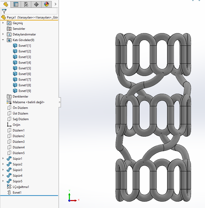

    Do not join the bodies because you will increase the total length with plain patterns.
  10. Step 10:

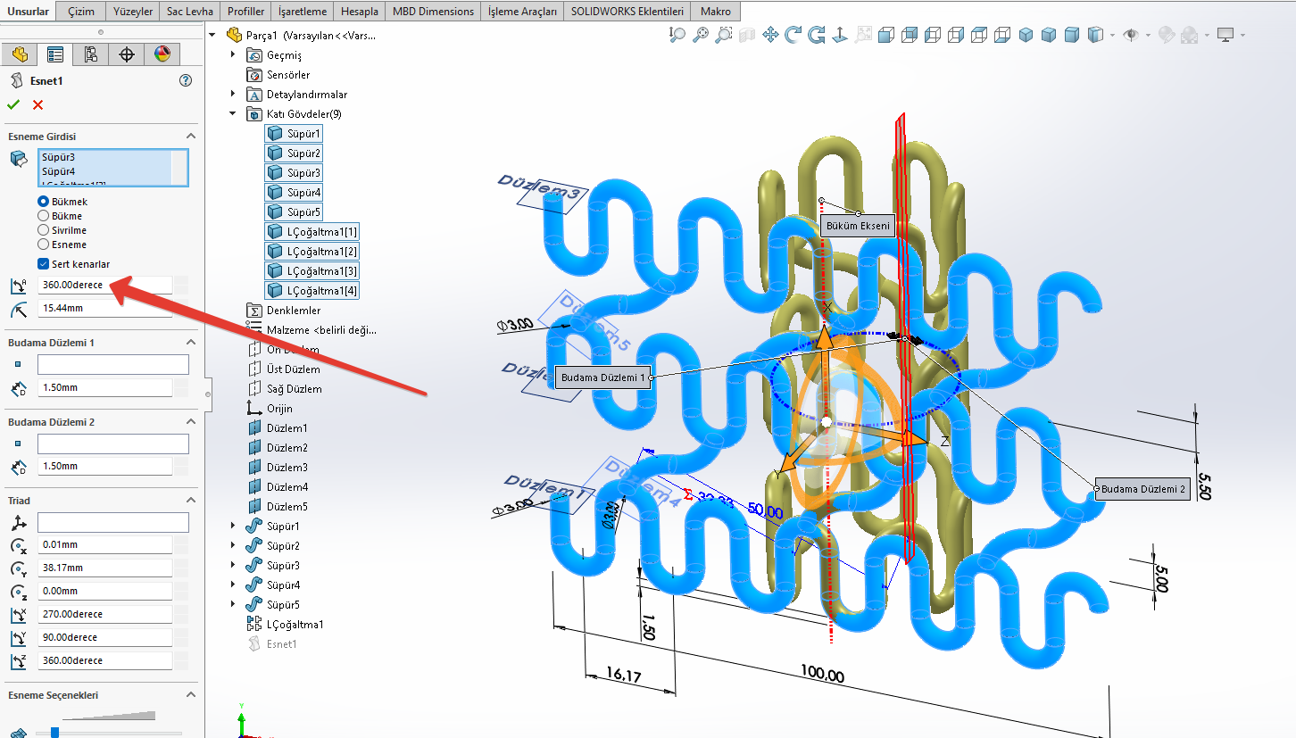

    • You can increase the overall size by using plain patterns.
  11. Step 11:
