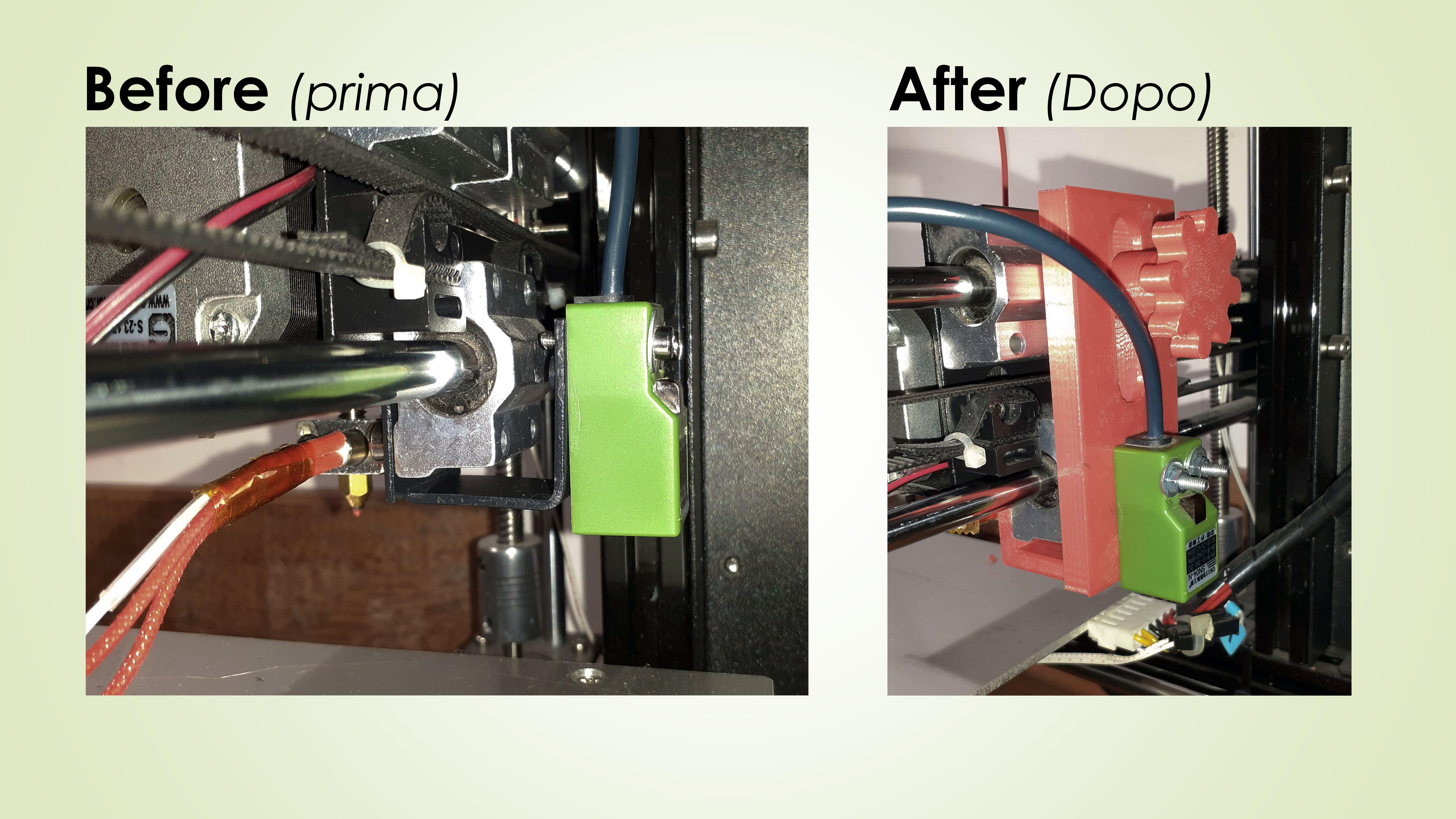

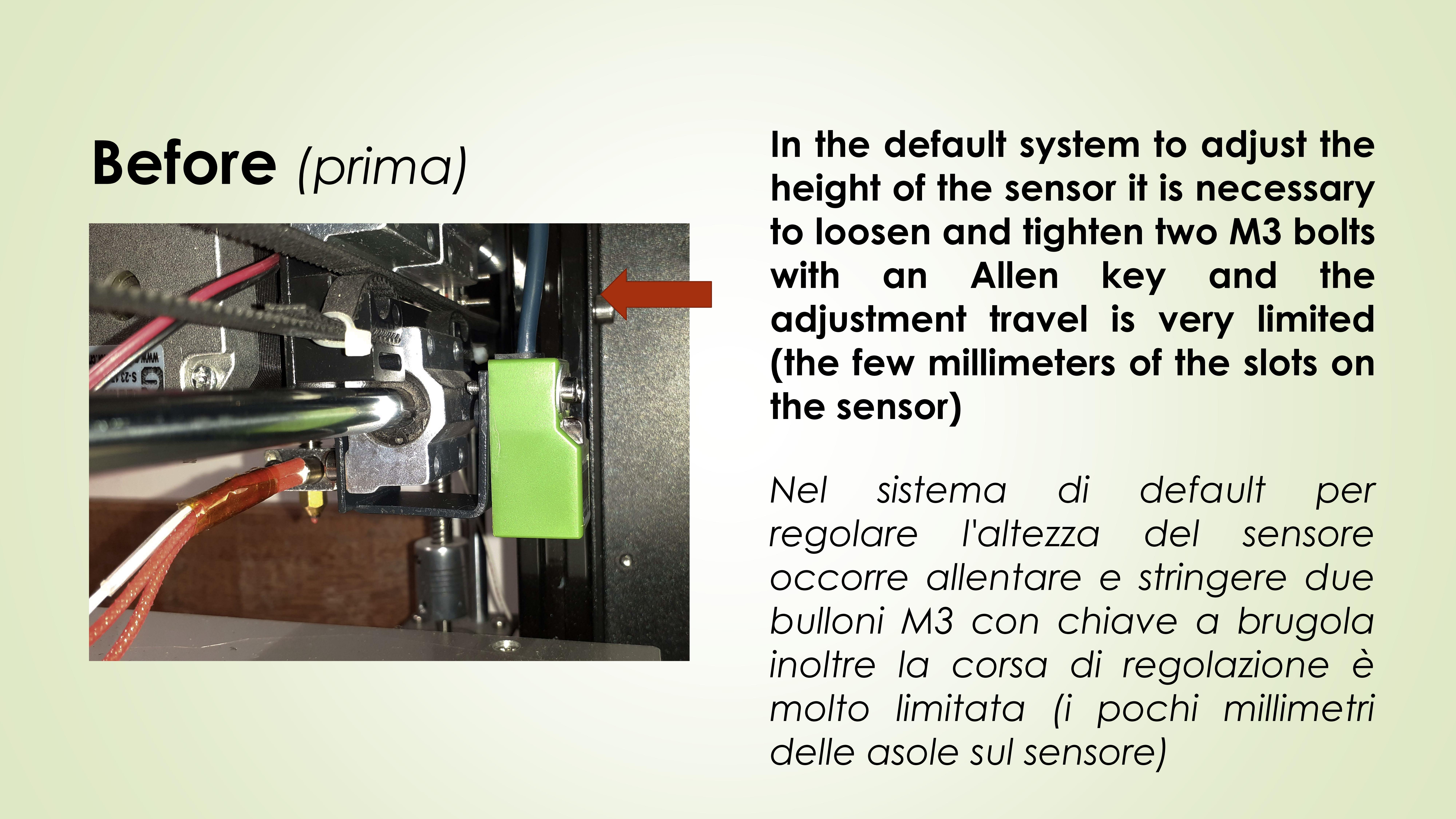

Step 1: Before and after
Step 2: Old System
Step 3: New system

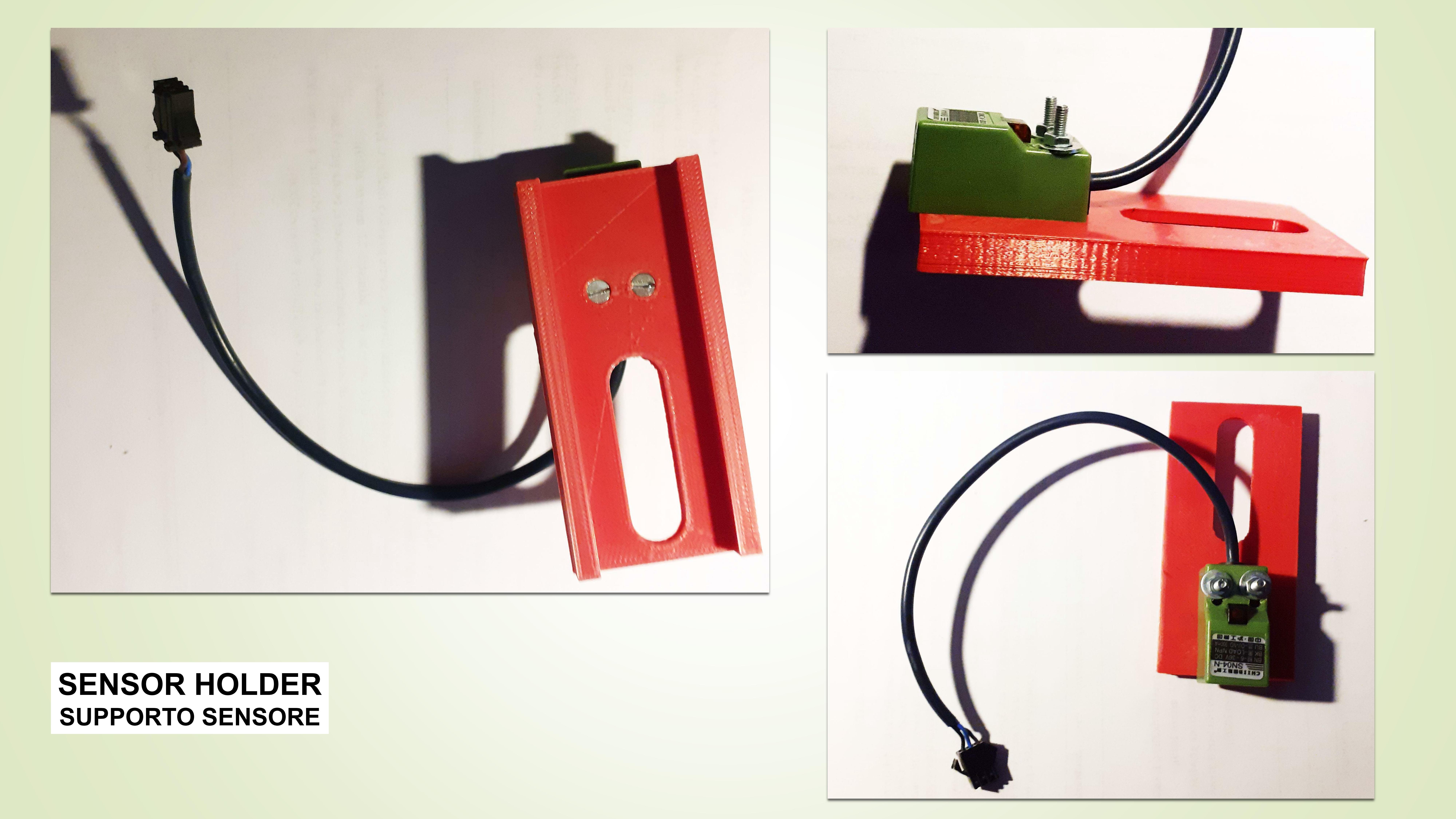

Step 4: Parts
Step 5: Install the sensor
Step 6: Installing sensor

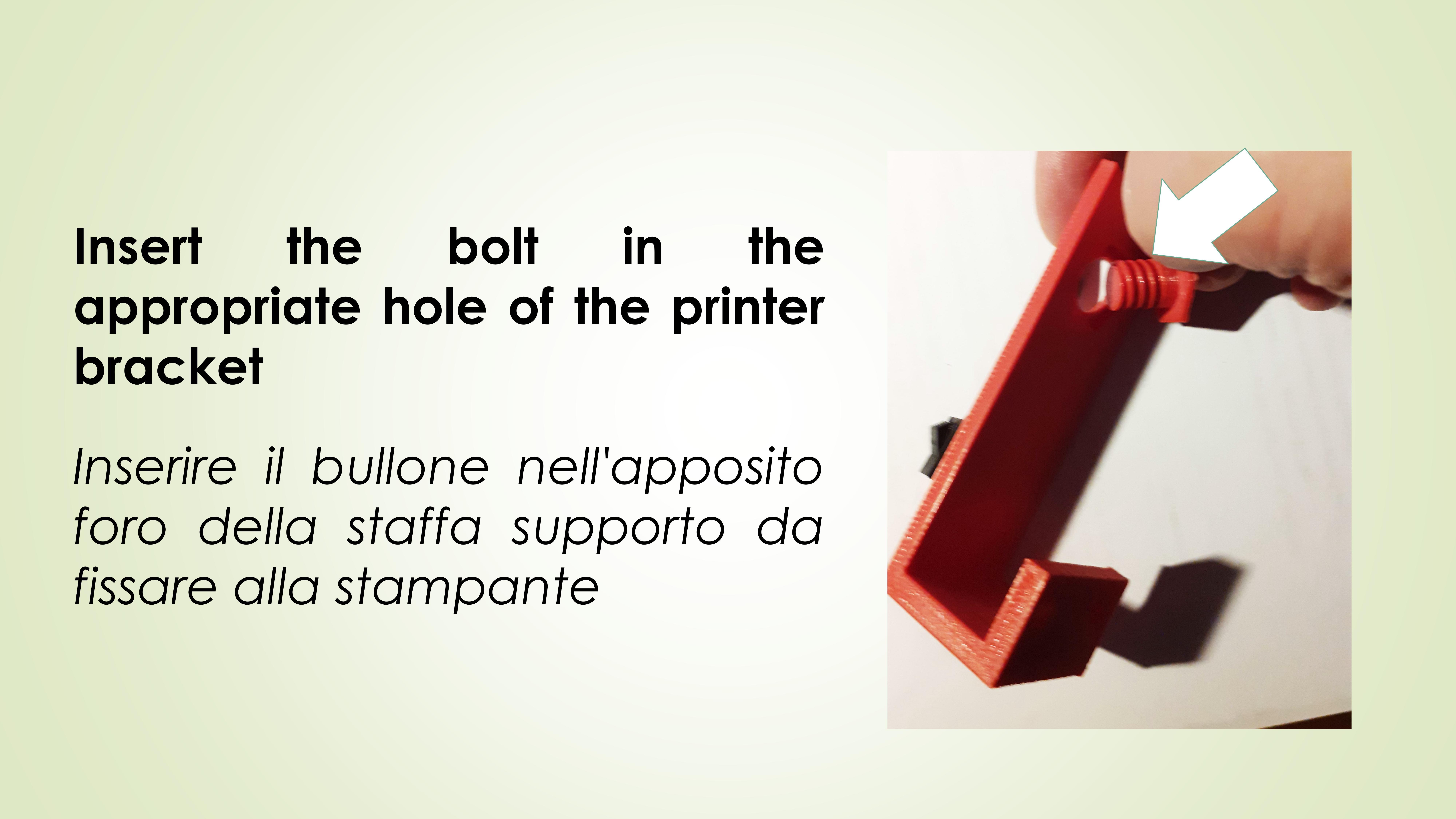

Step 7: Install bolt

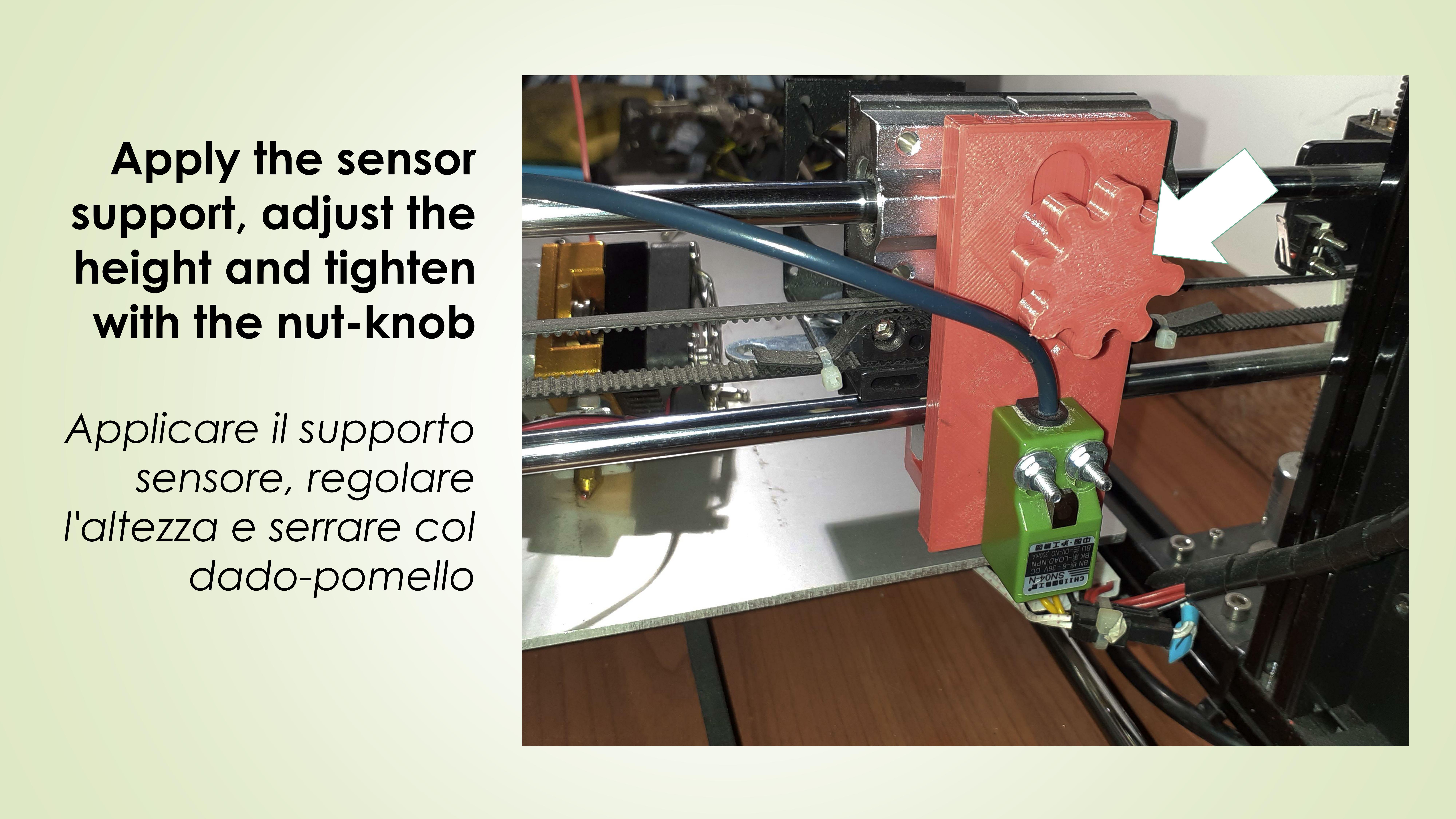

Step 8: Mounting on printer
Step 9: Adjusting sensor

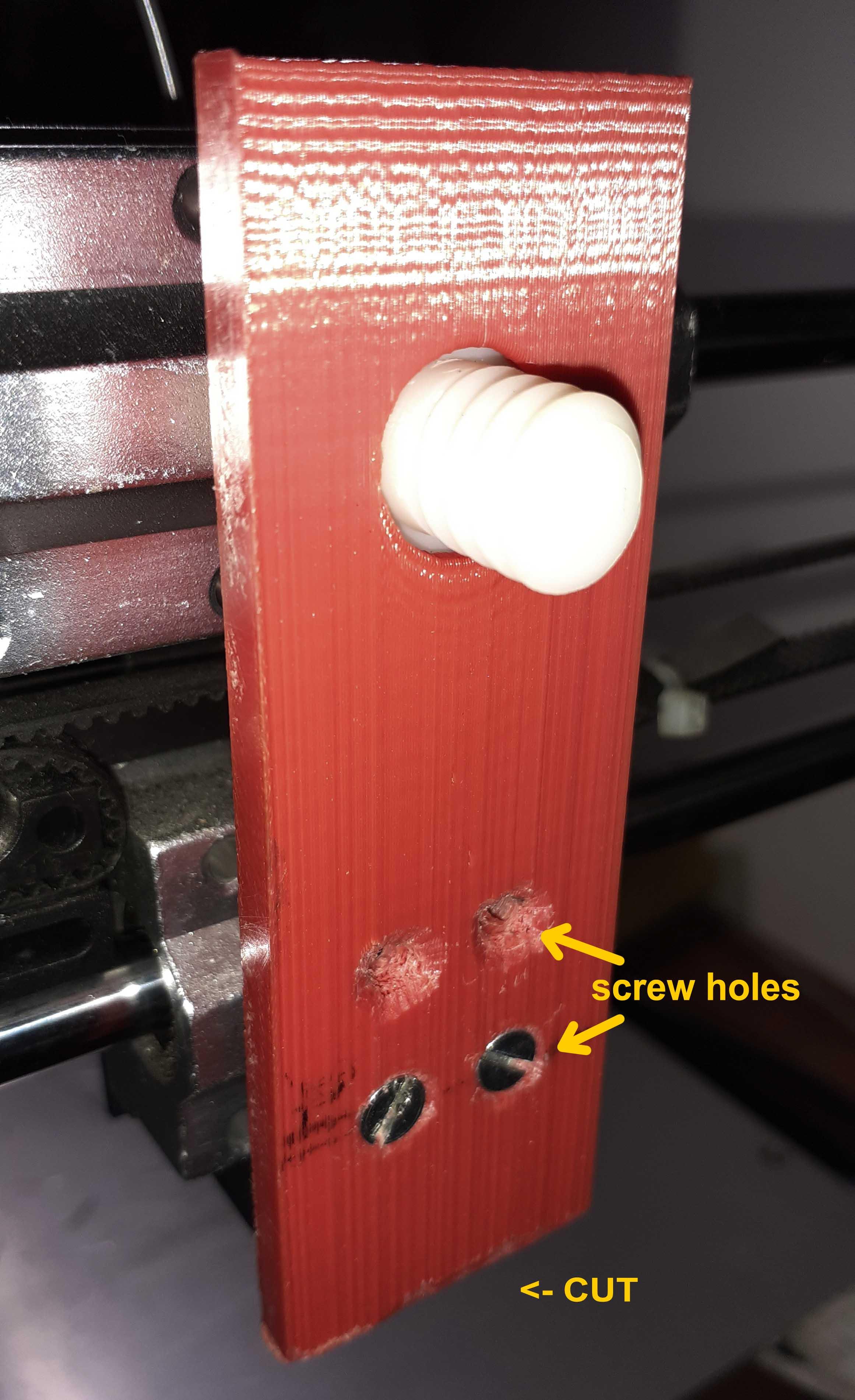

Step 12: Modification necessary in case of low space below
Step 13: Cutting of the lower part and fixing on the existing metal bracket
Instead of connecting the support in place of the existing bracket, the underlying part is cut and two small holes are made at various heights to fix the support directly to the pre-existing metal bracket (which therefore must no longer be removed)
Invece di collegare il sostegno al posto della staffa pre esistente, si taglia la parte sottostante e si fanno due forellini a varie altezze per fissare il sostegno direttamente alla staffa metallica pre-esistente (che quindi non va più tolta)

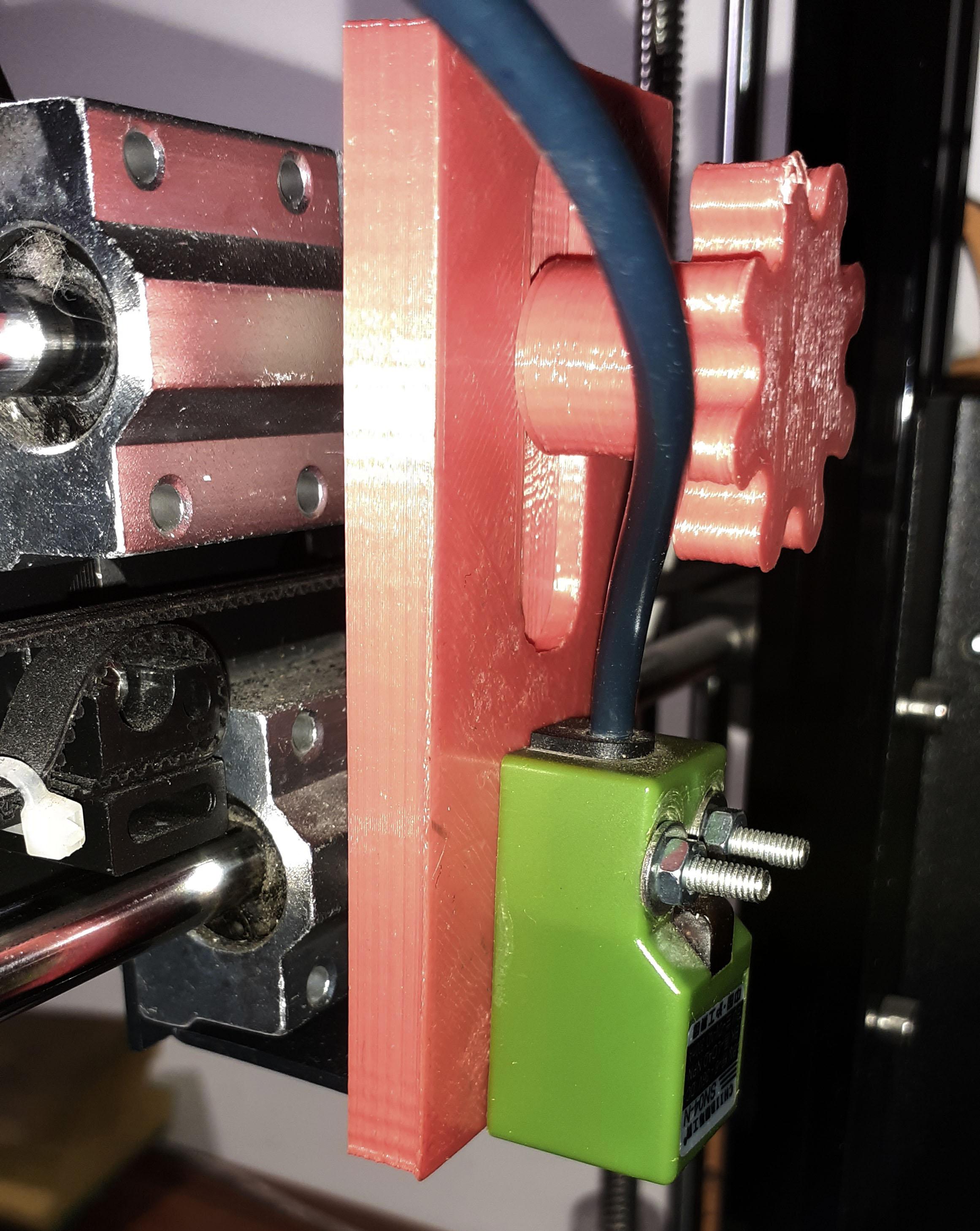

Step 14: Final results
I recommend printing the bolt (only the male) in resin because with PLA it is not very resistant
Consiglio di stampare il bullone (solo il maschio) in resina perché col PLA è poco resistente
