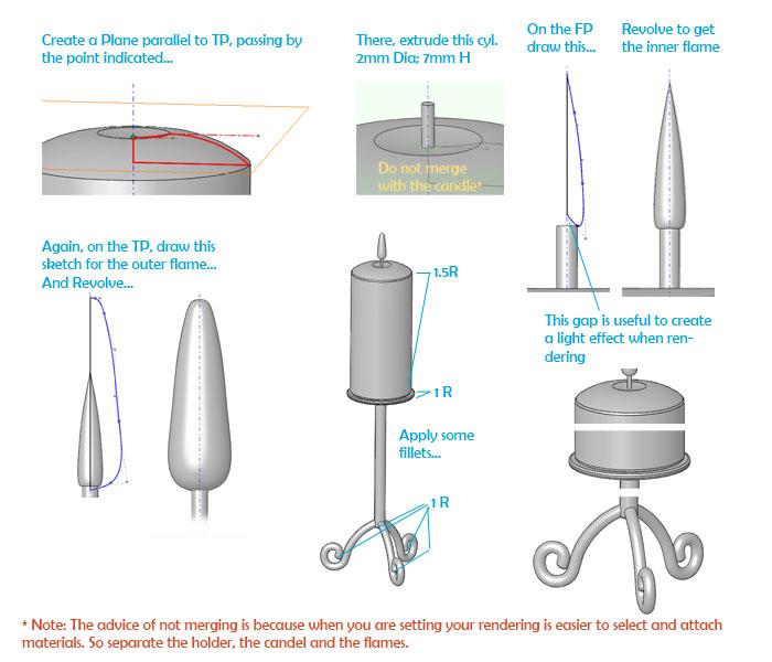

Step 2: Modeling the legs...
Step 3: Modeling the Flame...

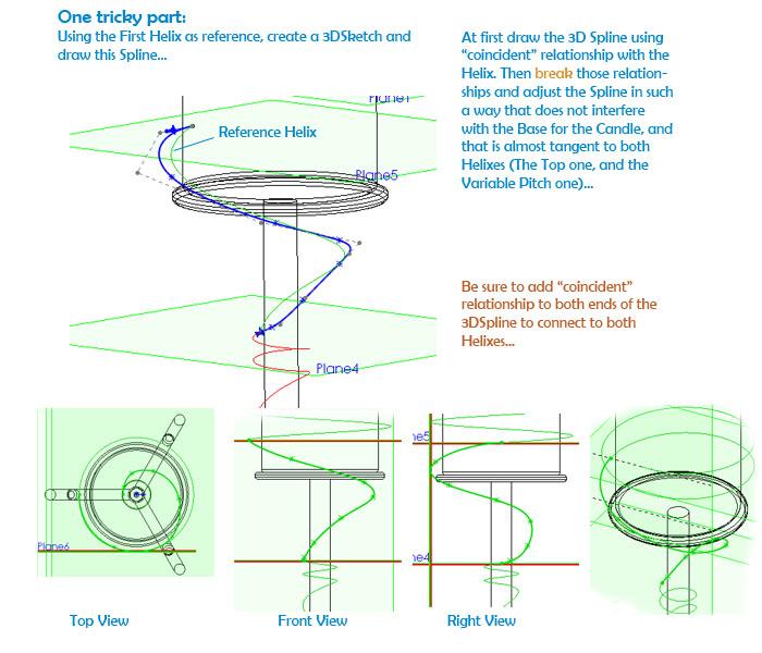

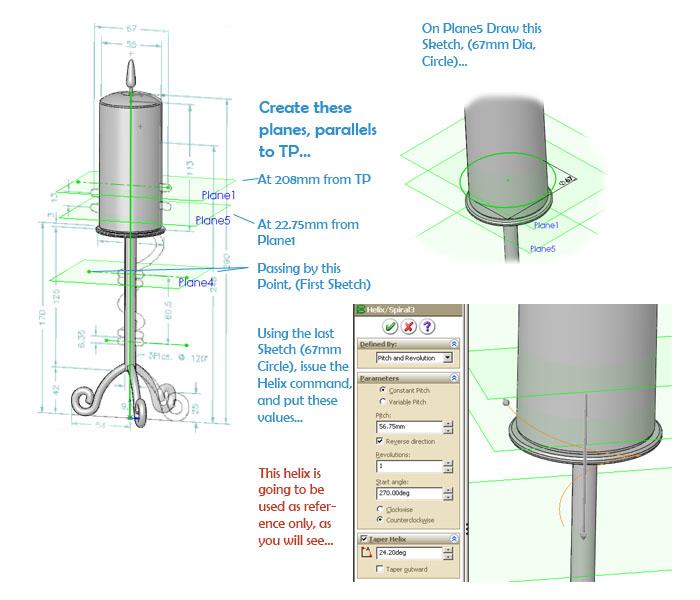

Step 4: Auxiliary Planes for Helix...
Step 5: Working with the Helixes...
Step 6: Connecting with Spline (Trick)...

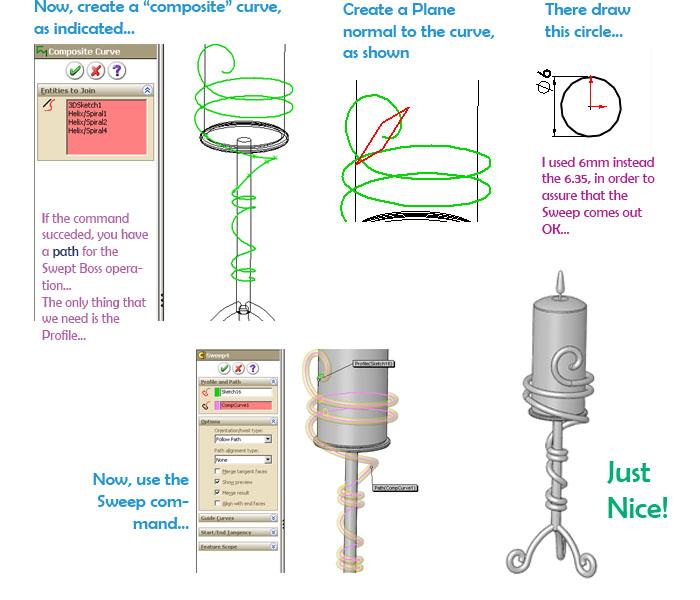

Step 8: Creating a Composite Curve...

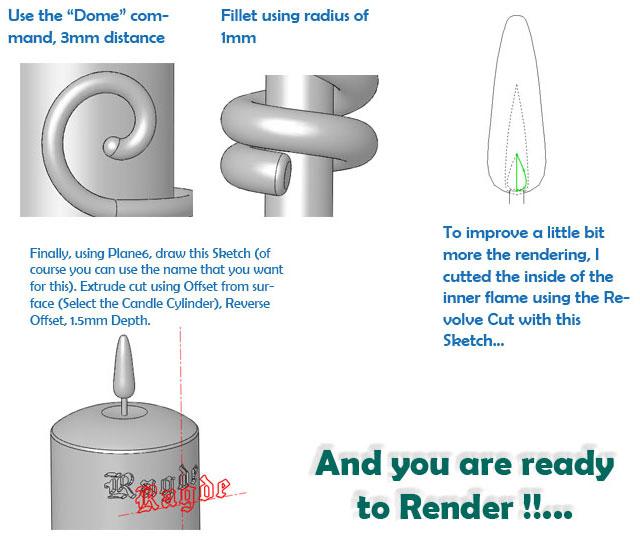

Step 9: Doming the Ends of the Wire...
Also some improvements for the flame. And putting the text...

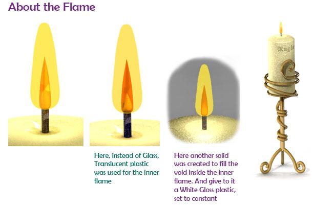

Step 10: Rendering Tips...
Step 11: Some about the Flame...
Step 12: Some Lights... et voliá!
