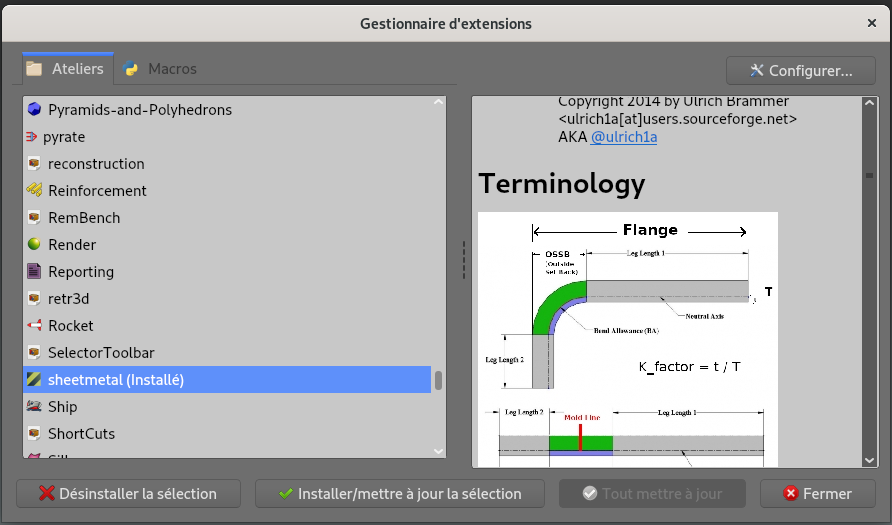

Step 1: Install SheetMetal WB (optional)
(optional - if you have not yet installed SheetMetal WB)
1) Go to -> Tools,
2) -> Addon Manager,
3) Select sheetmetal from the drop-down list,
4) Click on Install/Update.

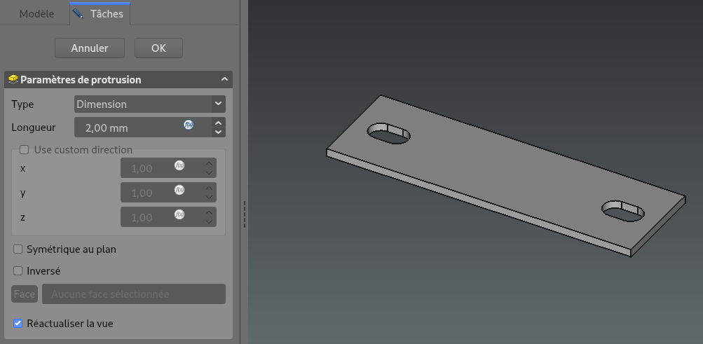

Step 2: Made a first extrusion
1) Go to Part Design WB ;

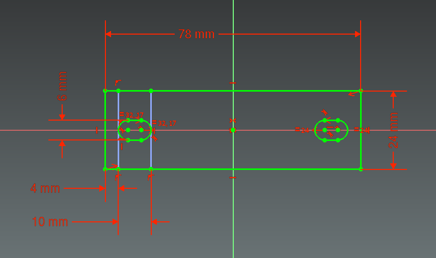

2) Create a new Sketch on XY plane in Part Design ;
3) In Sketcher WB, reproduce the sketch below : first, use Rectangle and Slot functions to made the shape, then add constraint ;
NB : To add a cotation between the two arches of a Slot you can use construction lines tangent to the arches.
4) Extrud a solid form the created sketch with Pad function ;
5) Sheet metal thickness is 2 mm as showed below.

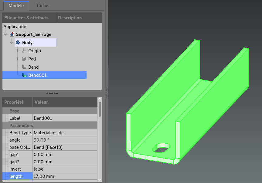

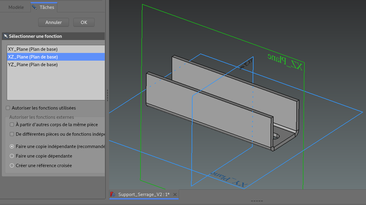

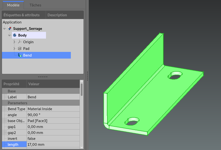

Step 3: Add Bends
1) Go to Sheet Metal WB ;
2) Select a edge of the previously created Pad and create a bend with Make Wall function ;
3) Set parameters :
- angle to 90,00°,
- Bend Type to "Material Inside"
- lenght to 17,00 mm.
4) Select the opposite edge and made same bend with same parameters.

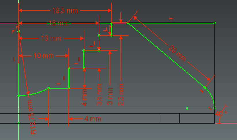

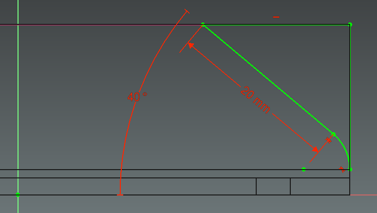

Step 4: Draw Pocket shape
1) Create a new sketch on XZ plane ;
2) Reproduce the sketch : below at the side of the part,
3) Then on the inside of the part.

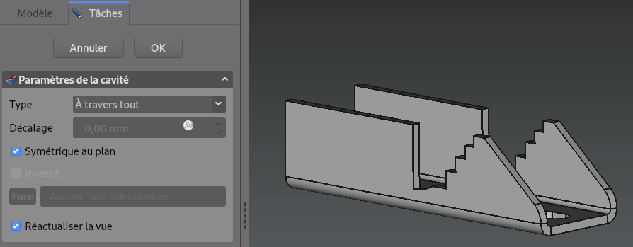

Step 5: Add symetrical Pockets through the two bends
1) Leave Sketcher and make a Pocket with step 4 sketch ;
2) Type is Through all, in order to reach the two bends.

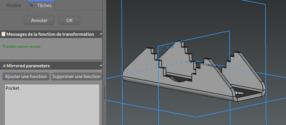

3) Use Mirrored function to add symetrical pockets ;
4) Mirror must be executed on the YZ plane.

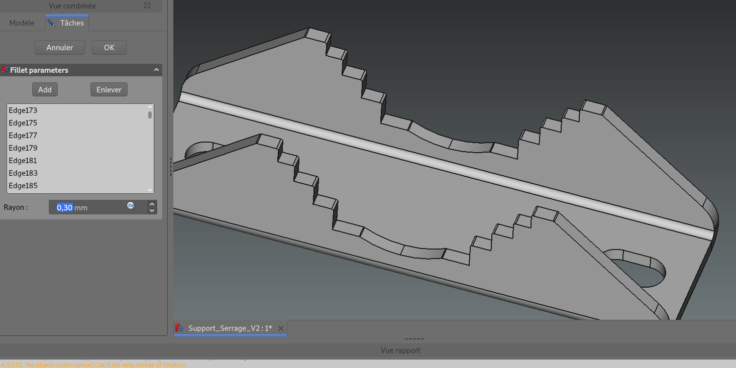

Step 6: Add Fillets (optional)
1) For more realism, you can add round edges with the Fillet function ;
2) Fillet can be set at 0.30 mm on all protruding angles.

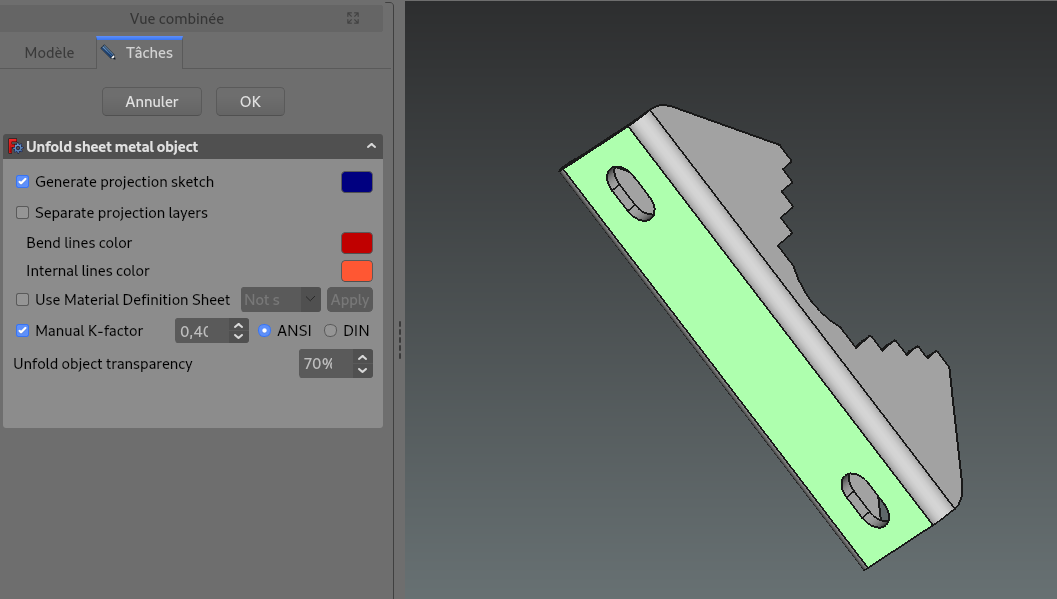

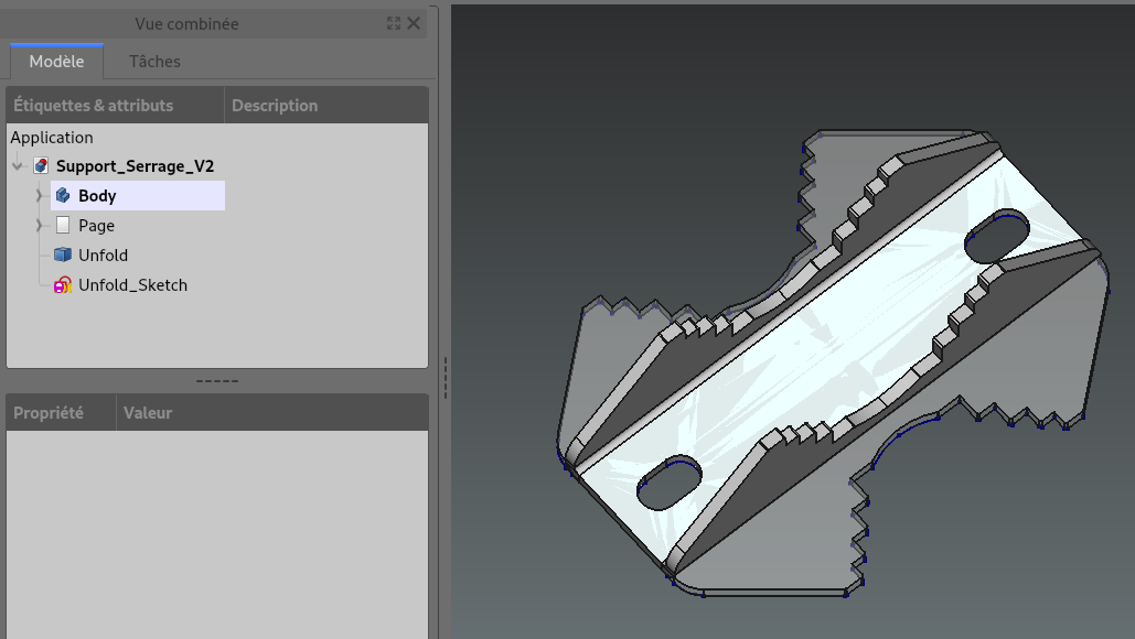

Step 7: Flatten Sheet Metal
1) Once the part is finished, we will be able to unfold it by returning to the Sheet Metal WB ;
2) Select the base plane of part and click on Unfold function ;
3) You have to chose a K-factor before cliking on OK. Here ANSI.
It will generate a solid and a sketch as below, that correspond to unfolded sheet metal.

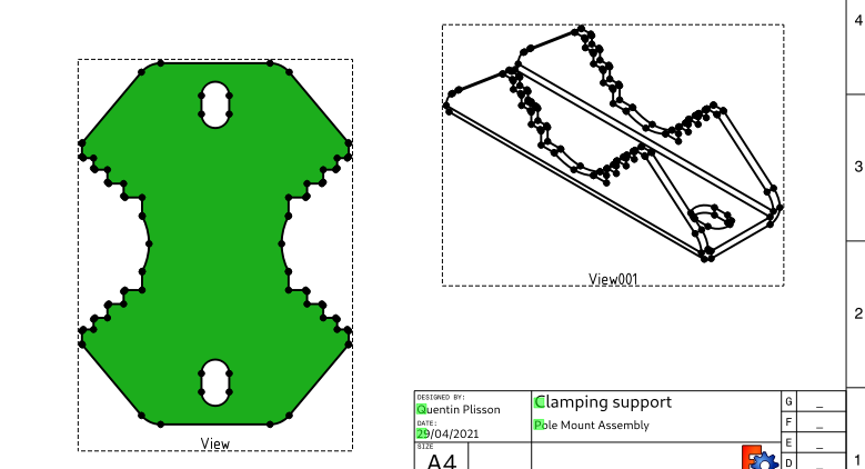

This will allow to insert an unfolded view of sheet metal with TechDraw WB :
4) Create a new Page ;
5) Select a face of Unfold body ;
6) Use Insert View function.
Step 8: Drawing Example
Below you can find an example of drawing for the Clamping Support with TechDraw default template.
1) Functions used to insert views : Insert View - to add five views of the part ; Insert Detail View - to insert detail A ;
2) Functions used to place dimmensions : New Horizontal ; New Vertical ; New Radius ; New Angle ;
3) Functions used to add annotation : Insert Annotation ; Add Centerline to Face - to made symmetry lines ; Add a cosmetic line - to add bending line.
