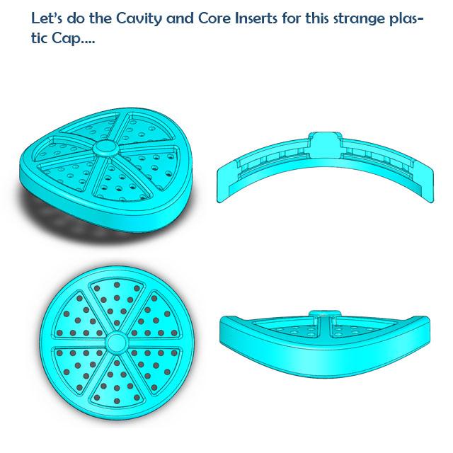

Core and Cavity for Strange Cap....
Exploring SolidWorks capabilities for injection mold design.
This time, inyeccion mold inserts for this crazy powder cap.

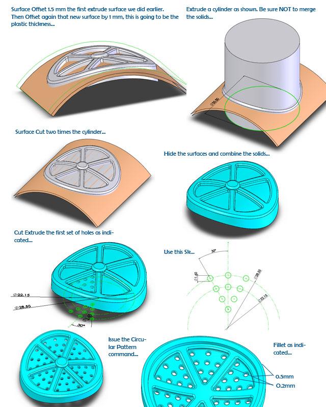

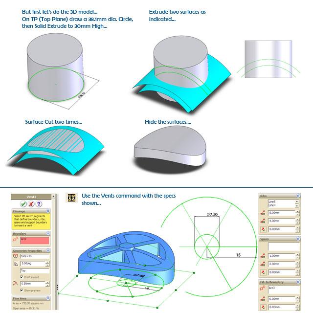

  2. Step 2: First, let's model the Cap...
    For most users modeling this cap will be a real challenge. So we decided to show you how we did it.

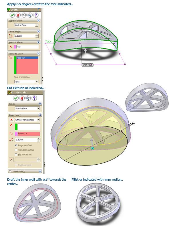

  3. Step 3: Applying Draft & some Fillets
    As you may know, injection molds need draft angles to facilitate the ejection of the plastic parts. It is also necessary to avoid sharp edges by adding fillets.

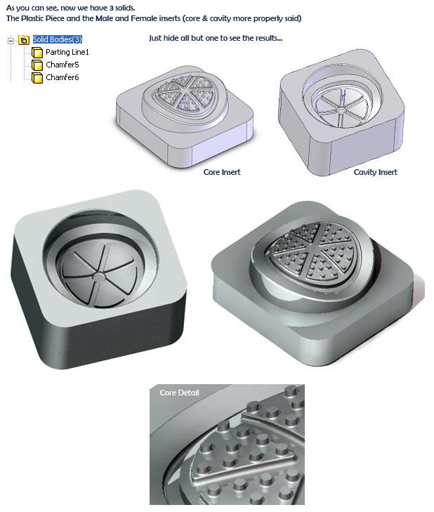

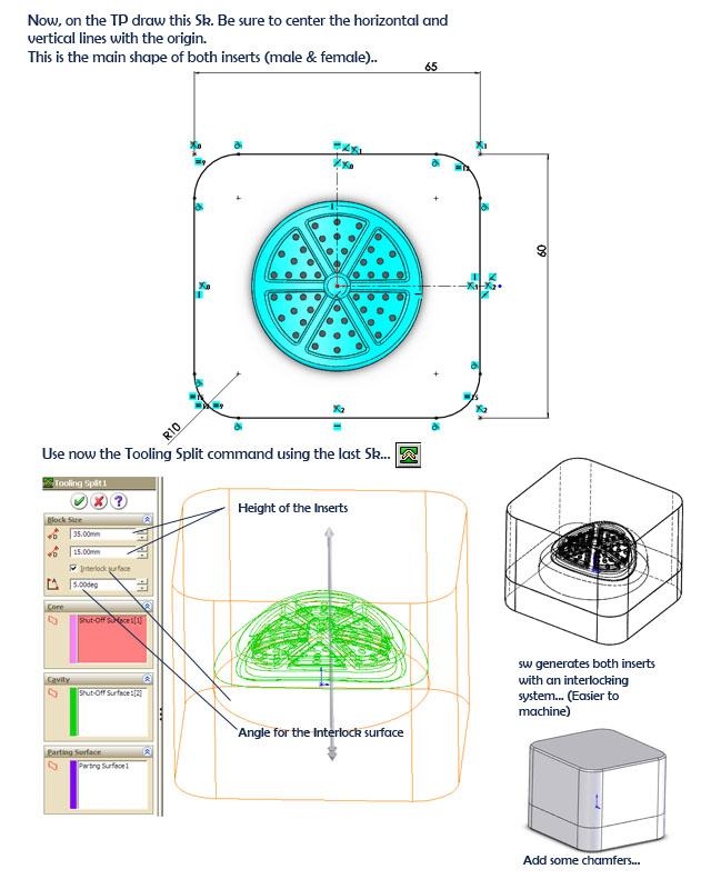

  5. Step 5: Mold Inserts. Parting Line...
  6. Step 6: Tooling Split...
    This is where the "magic" of SolidWorks works!
  7. Step 7: Final Outcome...
    As you can see, this is a very nice result!
    Of course, the inserta are not completely finished, missing threads for fixing, vents, plastic gate, etc.
    But for the purposes of this experiment, it's more than fine.
