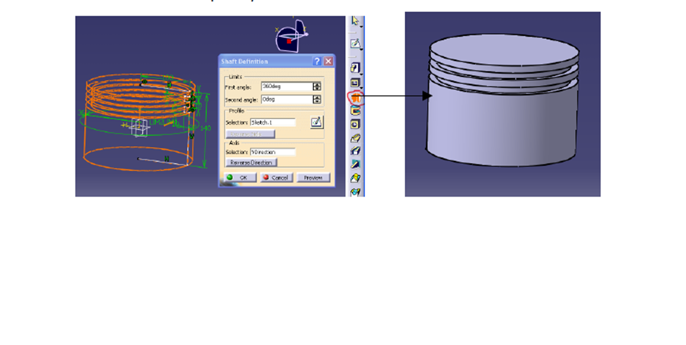

Step 2:
Click on the Limit icon and set the required size limitations.
Step 3:
Exit Sketch and click the Shaft icon to select the axis of reference that axis
Turn around to make the piece.

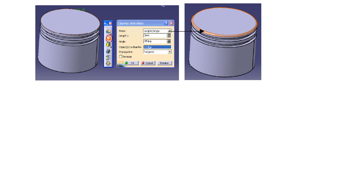

Step 4:
Click on the Chamfer icon to chamfer the pistol and select the edge,
Create it.

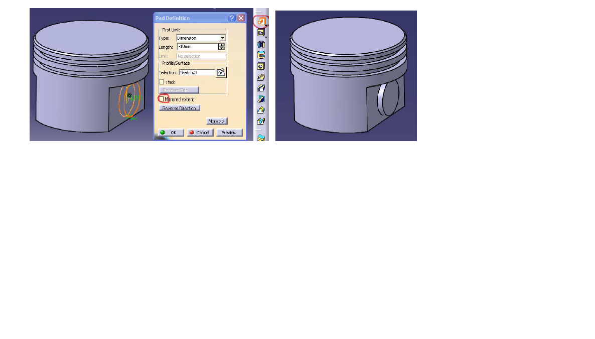

Step 7:
Draw a circle to project from the milling surface of the piston.
Step 8:
Click the pad icon or make a protrusion
Step 9:
Create this pad on the other surface using the symmetry icon.

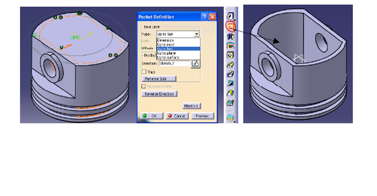

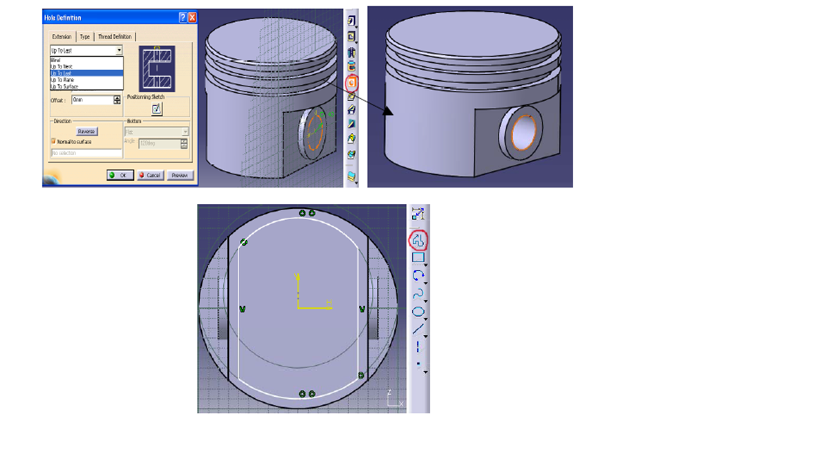

Step 10:
Make a hole by clicking the hole icon
Using the Profile icon, create the geometry on the bottom surface of the piston.
Step 11:
Create the geometry on the bottom surface of the piston using the Profile icon

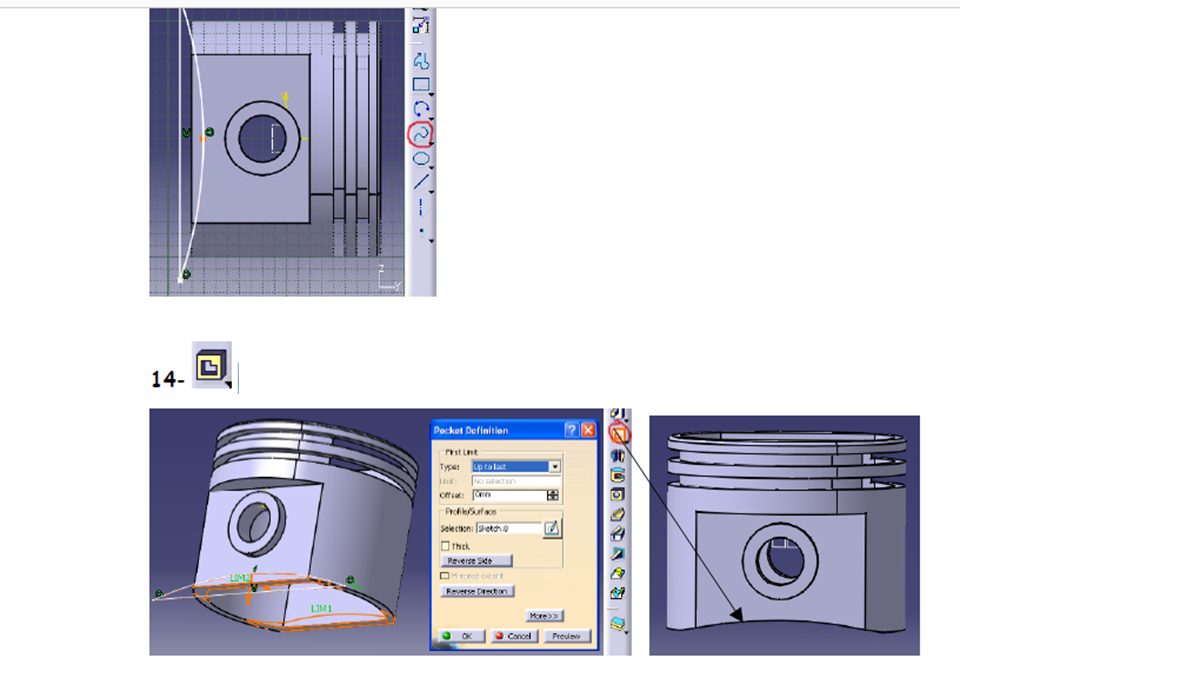

Step 12:

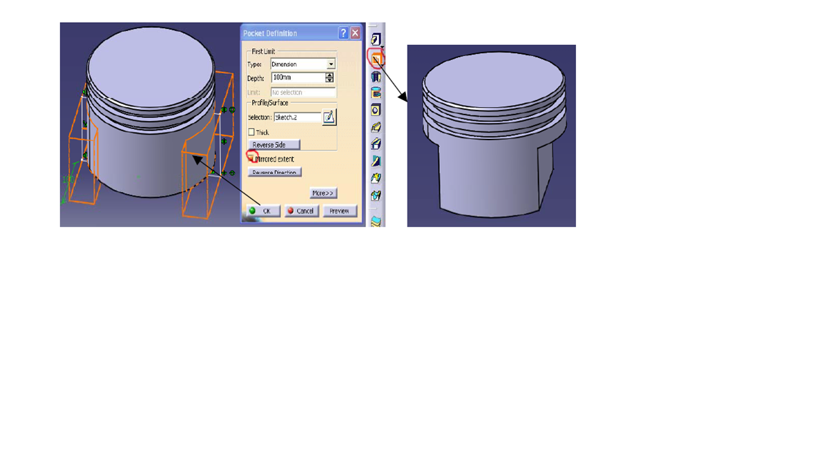

Create a geometric hole by clicking on the Pocket icon.
Step 13:
Again using the spline command to curve to the piston side surface
Create it.
Milling along the geometry by clicking on the Pocket icon.
Step 14:

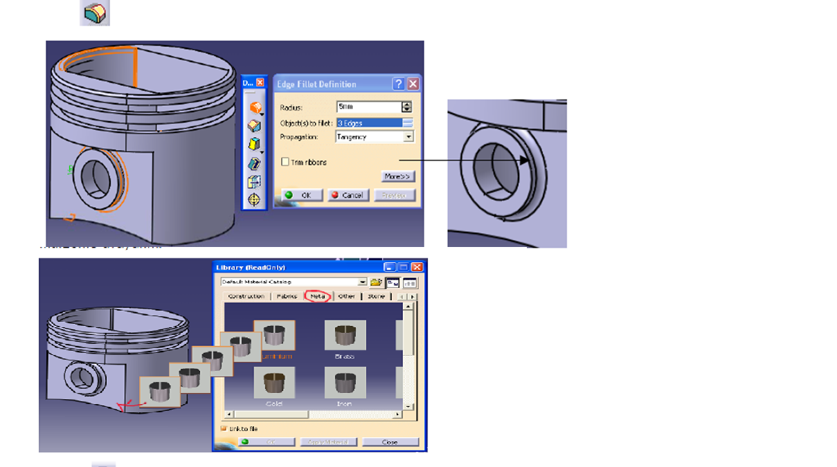

Fillet icon to create the required surface radius
To make various static analyzes of this part we have created
Let's assign stuff.
Step 15:
By pressing the view icon, the color of this material on the screen
See properties.
