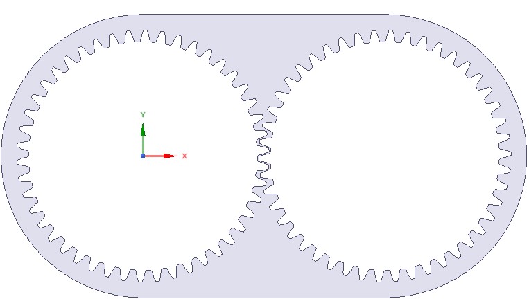

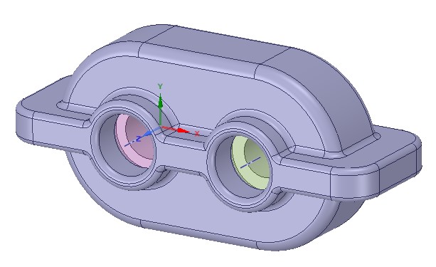

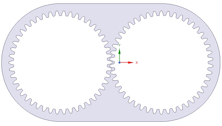

3D Model :-
For finding the result using this 3D model is increase the computational cost and time to run the simulation and also we are having Academic license so some limitations for mesh generation. So we are extracting 2D model from 3D model and done simulation on it.
For performing this simulation we have two types of model
Model 1 : Low clearance
Model 2 : High clearance

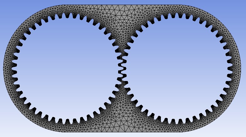

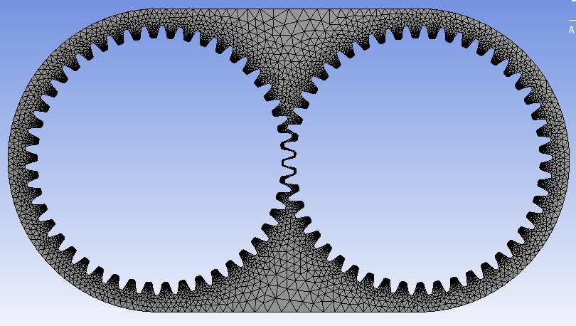

Meshing :-
For refining the mesh for this case we are using all triangle method
- Element size = 30 mm
- Capture proximity ON
- Proximity minimum size = 0.3 mm
- Number of cells across gap = 1
Low clearance
High clearance

Center of Gravity Location
For Low clearance
- Left Gear
- X-direction = 0 m
- Y- direction = 0 m
- Right Gear
- X-direction = 0.115 m
For High clearance
- Left Gear
- X-direction = -0.0684485 m
- Right Gear
- X-direction = 0.0485515 m

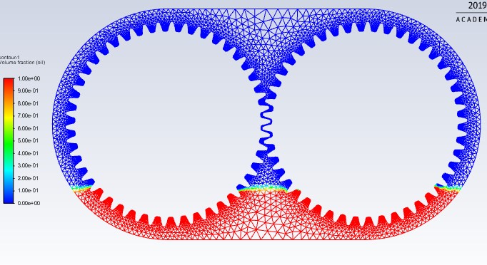

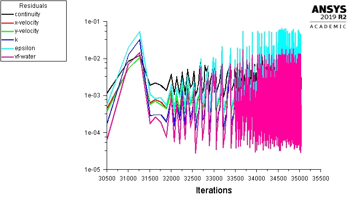

Case 1 : Gearbox with Low clearance and Water as a fluid

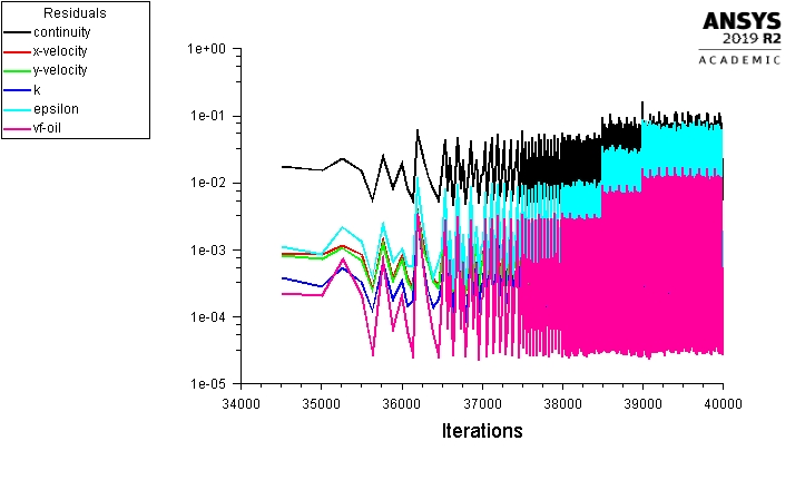

Fig : Residuals plots

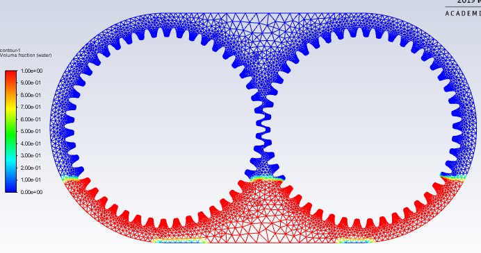

Fig : Volume fraction of Fluid at initial state.
Animation : Flow of lubricant fluid inside gearbox

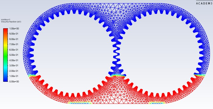

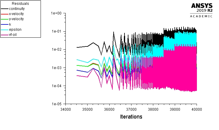

Case 2 : Gearbox with Low clearance and Oil as a fluid

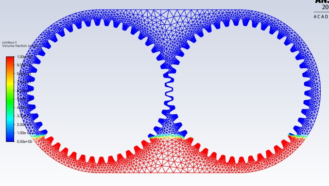

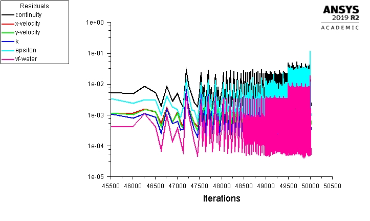

Case 3 : Gearbox with High clearance and Water as a fluid

Conclusion : -
- As shown by above Animation, we can see that both oil and water can work as a proper lubricant.
- All the teeth of the gears are covered in the lubricant after they completed 1 revolution.
- The difference between oil and water as a lubricant is that there is little sloshing with oil on the top of the gear teeth than water due to its higher viscosity and higher resistance.
- Oil has lower density then water means oil has lower mass per volume so it stick on teeth of gear for more time.
- The splashing in the top half of the gearbox is lesser for the high clearance model because there is much space between the gear to pass the lubricant through.
