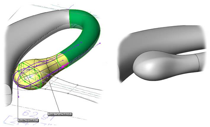

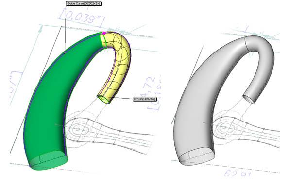

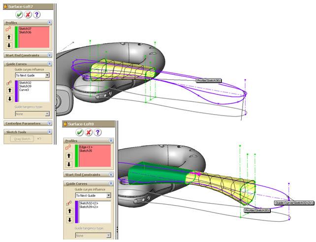

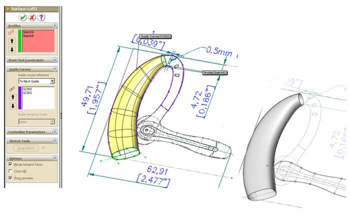

  1. Step 1: First Steps. Surfacing...

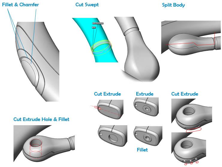

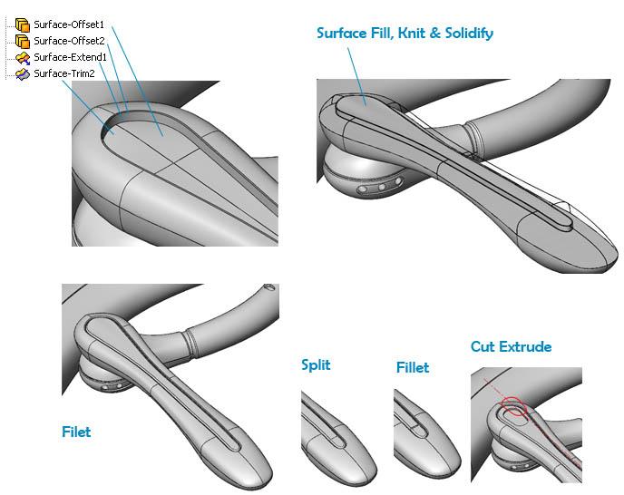

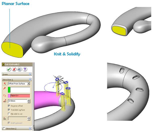

  2. Step 2: Solidifying
    Making solids, and extruding lateral slots...

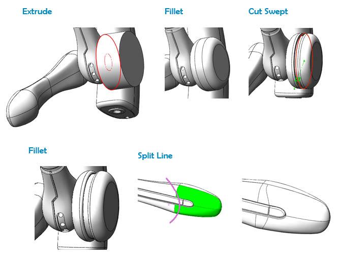

  3. Step 3: Some other Main Body steps

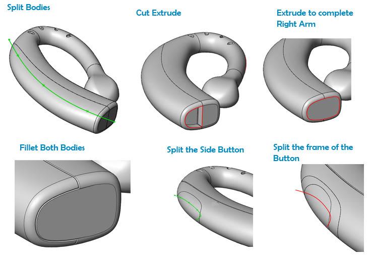

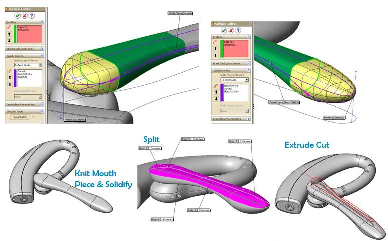

  4. Step 4: Microphone Modeling
  5. Step 5: Final Details...
