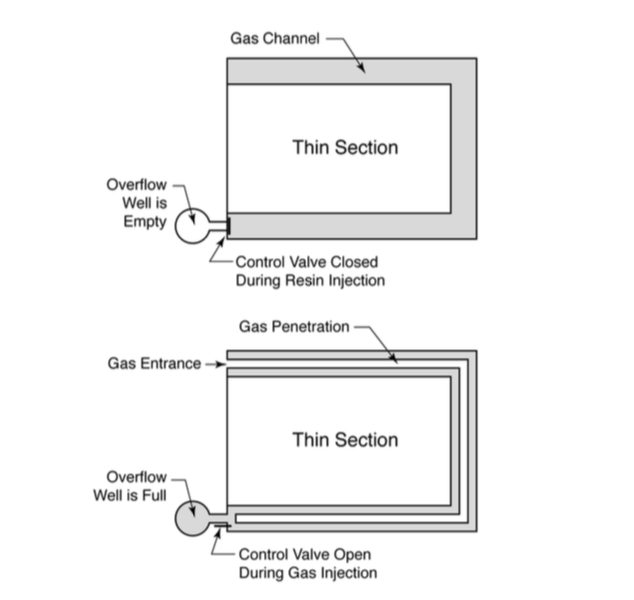

Step 8: Gas Assist Molding
This process is used to hollow out thick sections of a part where coring is not an option and sink is not acceptable. Gas assist molding can be applied to almost any thermoplastic, and most conventional molding machines can be adapted for gas assist molding.
