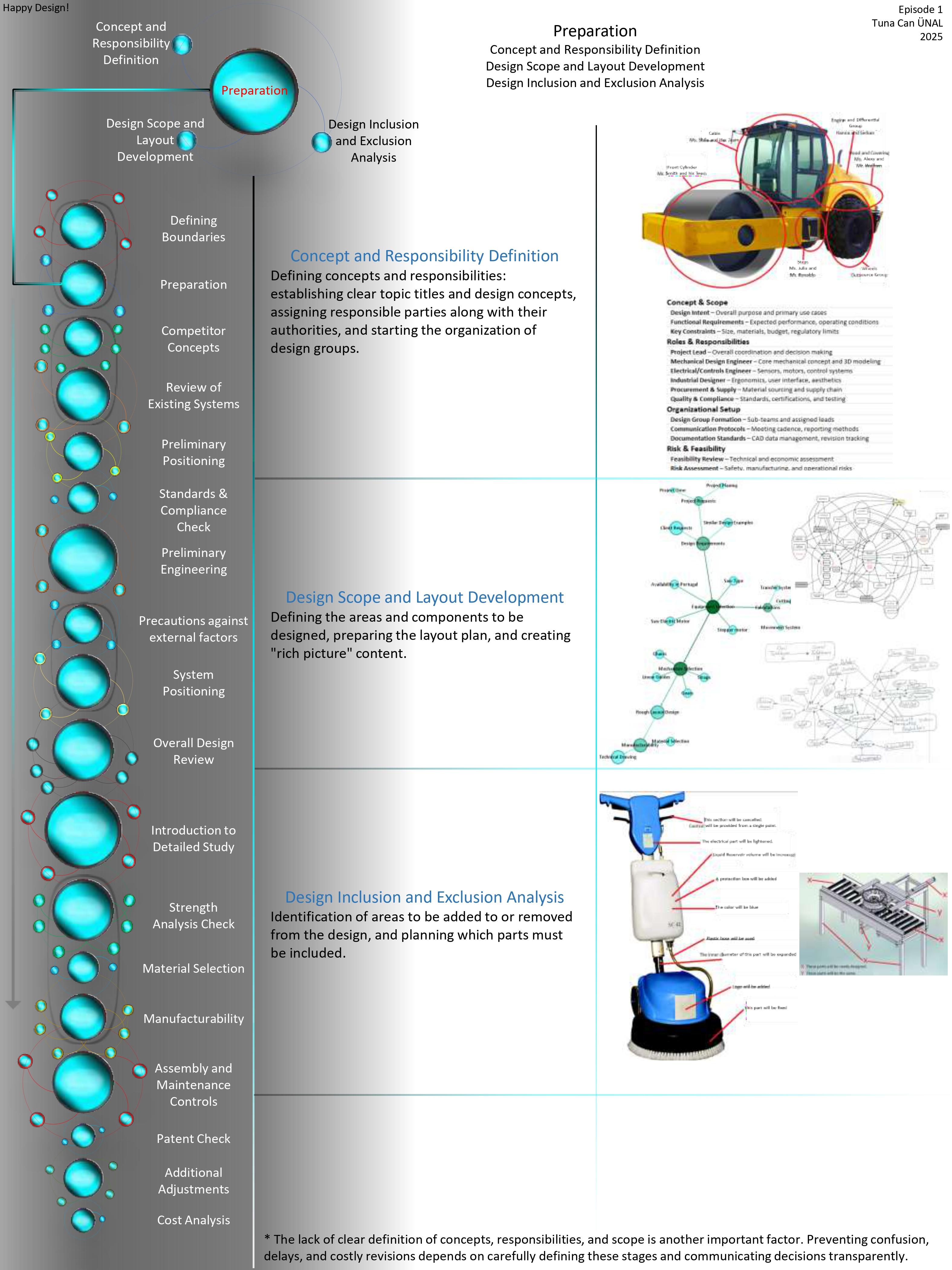

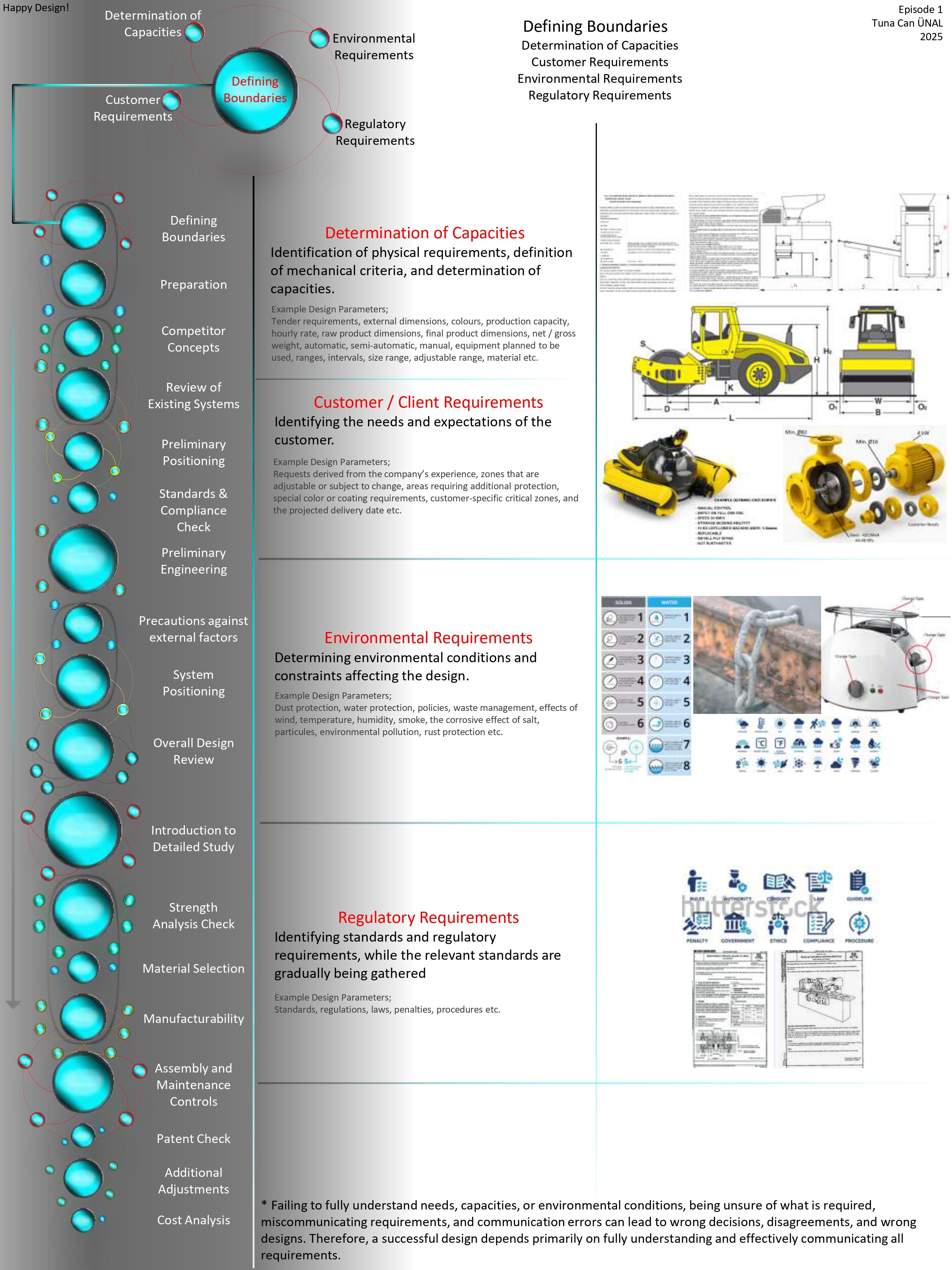

  1. Step 1: Episode 1

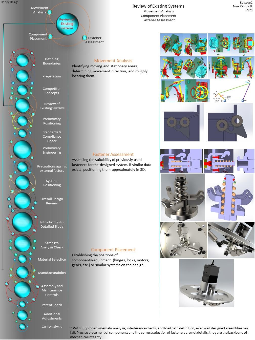

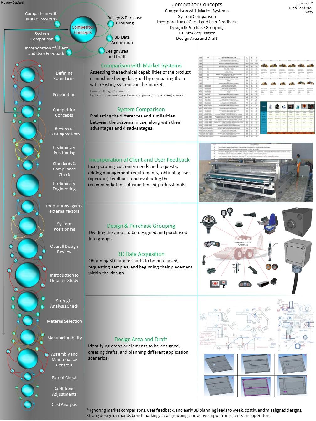

  2. Step 2: Episode 2

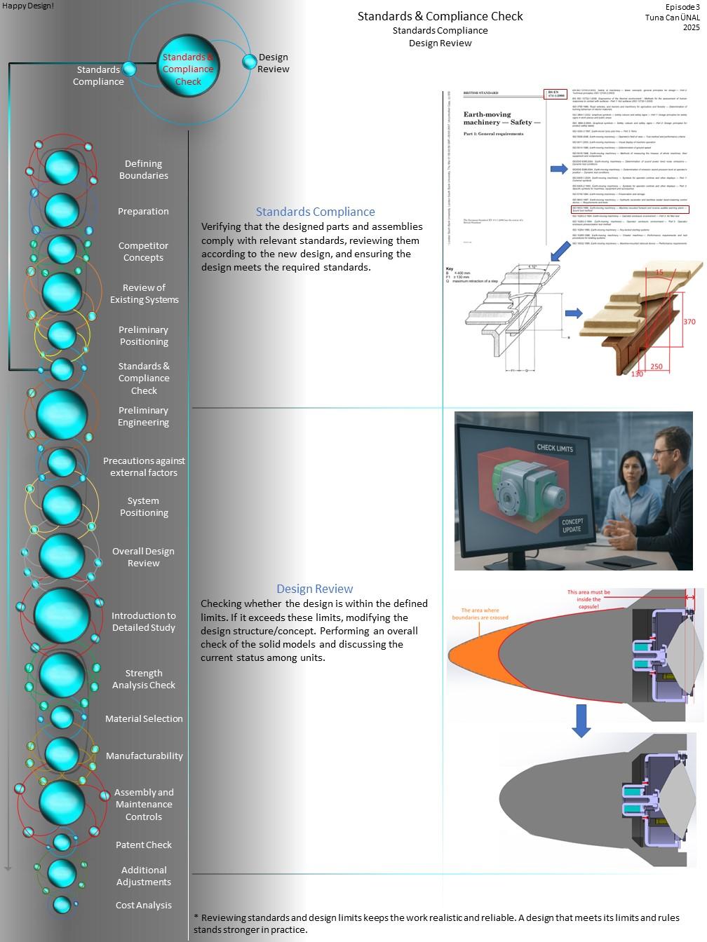

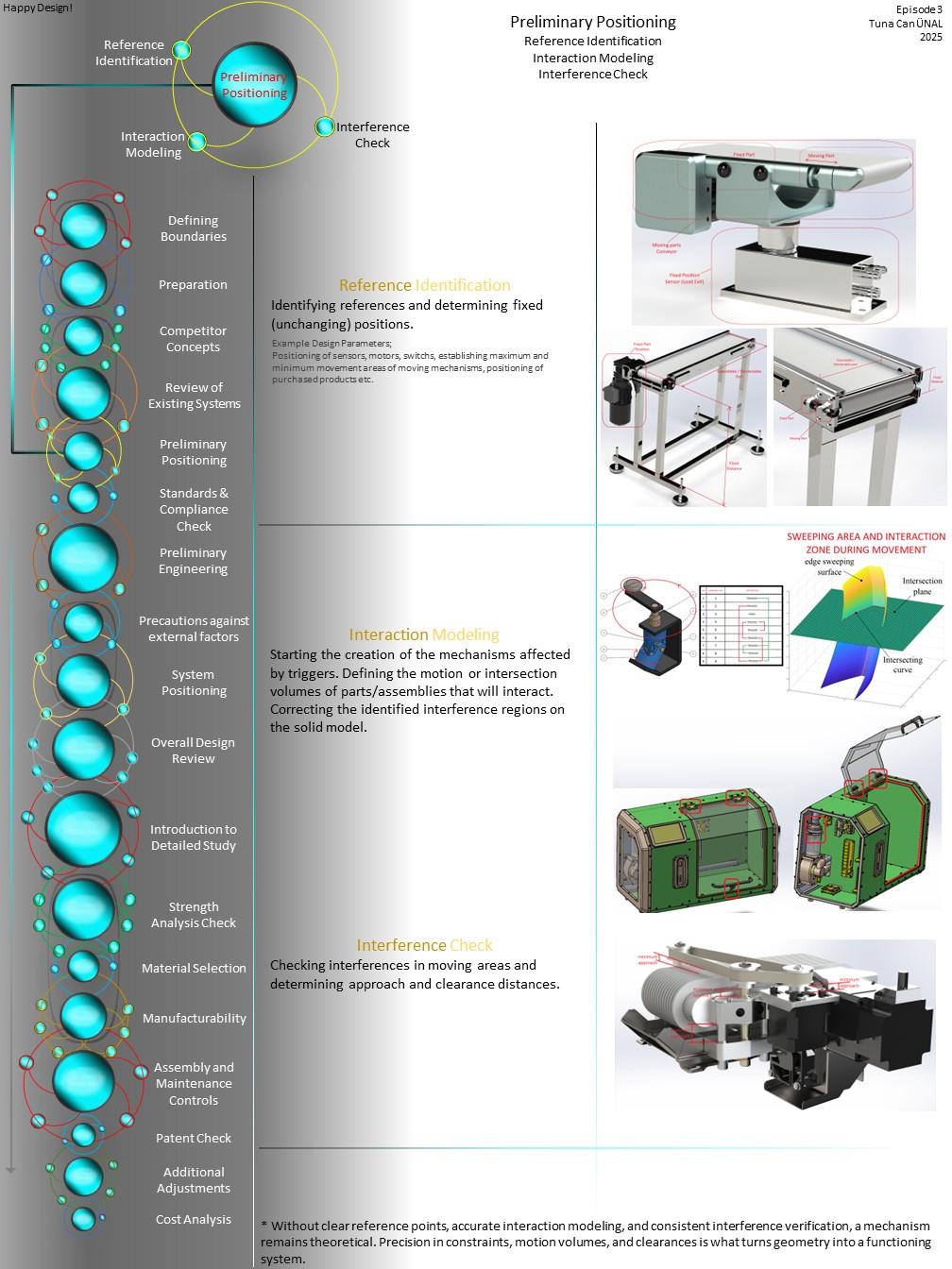

  3. Step 3: Episode 3
