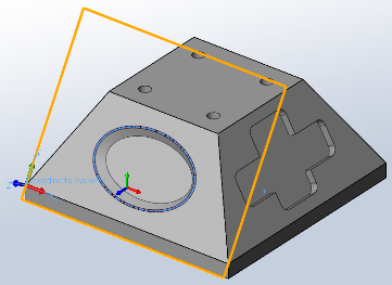

    Tool Orientation
    ➝ Enable Tool Orientation
    ➝ Select Use Coordinate System
    ➝ From the tree view in the model window, expand the node Tutorial3<1>.
    ➝ Select Coordinate System1.
    Machining Boundary
    ➝ For the machining boundary, select Selection.
    ➝ In the graphics window, click on the outer oval edge of the pocket to select it.
    ➝ Select Tool Center on Boundary from the Tool Containment drop down.

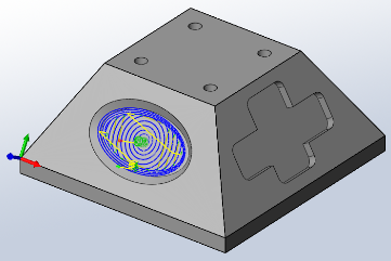

    3. Start calculation
    Click at the top of the property manager. The resulting toolpath will look like this:

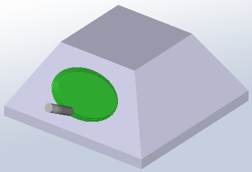

    4. Verification

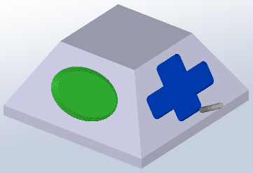

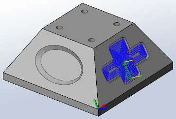

    To verify the toolpath use the stock simulation, right click on the Job node in the Operation Manager and select Stock Simulation (All). Press the Start button and watch the stock simulation up to the final stock shape.
    Click to exit the Stock Simulation.
