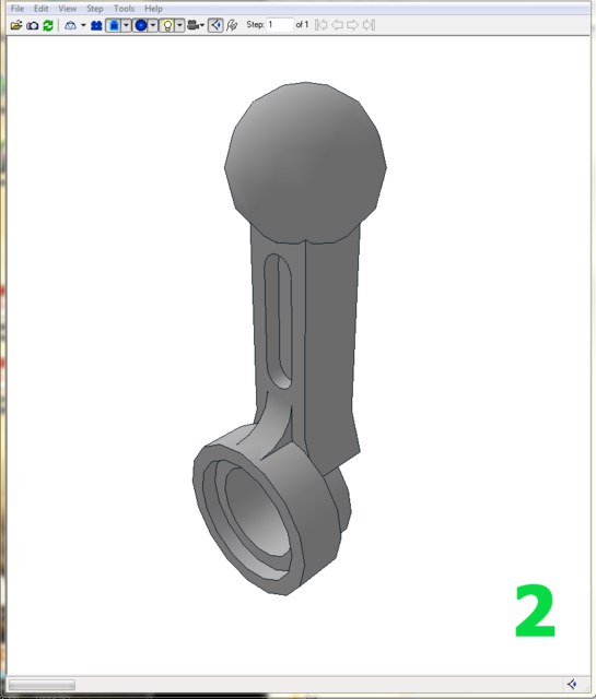

    Example: 2852 - Technic Engine Connecting Rod
    (See images below)
    1. Get the DAT from LDraw.org.
    2. Open in LDView and export to STL. *STL will open in Inventor, but with no edges or vertices to pick from. YMMV.
    3. Import the STL into 3DSMax and export to DXF. Now you have data you can measure. *In my case, I have to flip the X axis. IV and 3DS use different coordinate systems.
    4. Import the DXF into Inventor. *You may have to adjust you import settings. I have to change my units to cm to scale correctly (among other settings).
    My normal workflow is to place the part off-center in 3DS. When I import it into IV, the surface data will be off of origin a little. I now work in the same file, creating new IV data next to the imported model (see image 4). When completed, I delete the surface data, add iMates, refresh, purge, and save. Done
