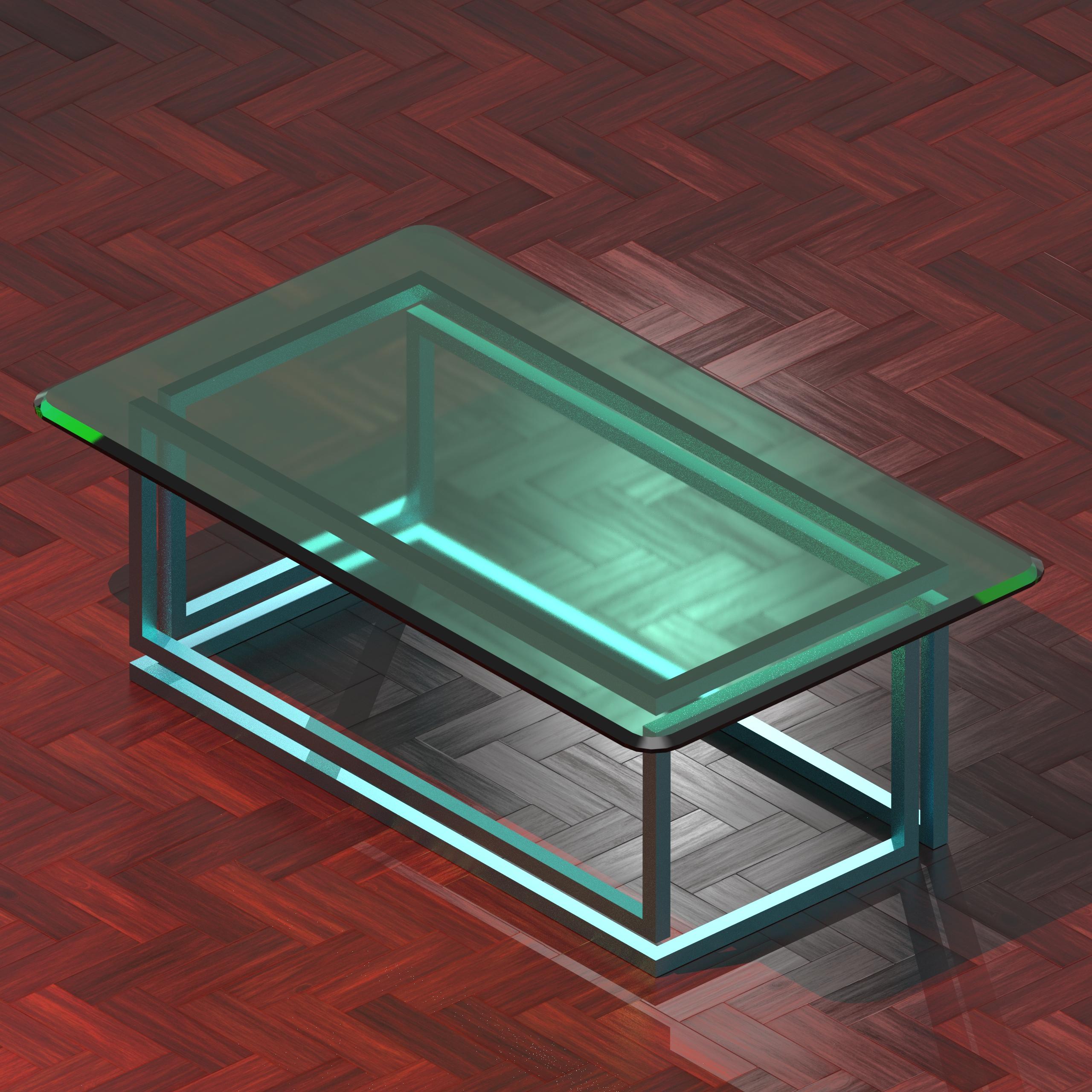

    Follow the same procedure for all elements till rectangle is completed as shown below.
    I have used colors to identify 6 different profiles so it can be easy to understand.
  4. Step 4: Checking Overall Dimensions
    After completing the model. I just ensured if I have modeled my job with the dimensions I have decided. As you can see above, Overall dimensions perfect. The gap is uniform at where it is present.
    Though I modeled it with multiple errors while creating each profile. The gap was more at some section. Profile is length out of box dimensions. But finally I managed to get is perfect.
    This is final render I have created using keyshot. The 3D .step file is uploaded on my profile. You can check it out there also.
