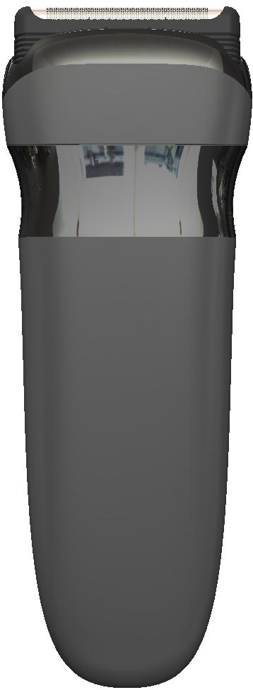

Step 1: Take pictures of the object
For this technique you have to first take pictures of the object you plan to model.
Make sure to take the pictures with the top- front- and right plane in SOLIDWORKS in mind.
For best results i recommend to use a background color with contrast to the object and taking the picture with as little perspective as possible. I usually distance the camera far away from the object and then zoom in tho make the model fit the frame snug.
Also make sure that you have at least one dimension that you can easily measure in real life clearly visible in the pictures.
Here are the reference pictures i will be using:

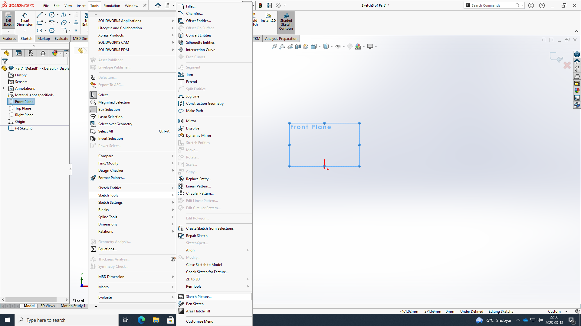

To import the picture onto a plane, start a new sketch on a plane by selecting the plane and pressing the sketch button, I'll select the front plane.
Once you have started the new sketch go to:
Tools - Sketch Tools - Sketch Picture
Here you can browse for your desired picture select it and press OK. I'll choose the front view.

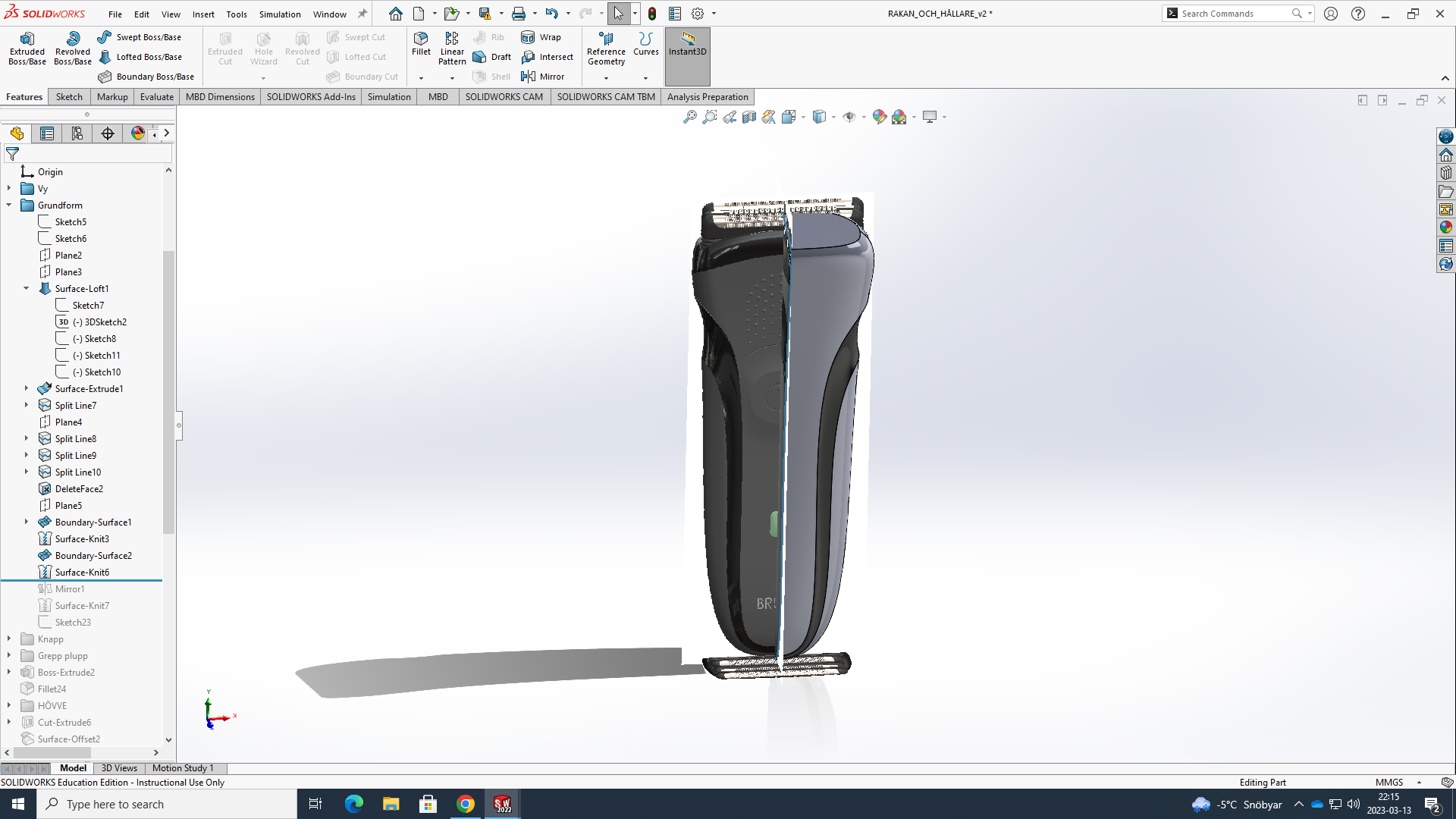

Step 5: Modeling
You can now use these imported pictures to start modeling easy or complex shapes! Simply start a sketch on one of the planes with a picture and trace the contours of the pictures. I recommend splines for double curved surfaces.
After some tinkering using tools such as projected curve, surface loft, splitline and boundary surface i came up with this basic shape of the razor:
And after a while you can get results like this using the reference pictures:
