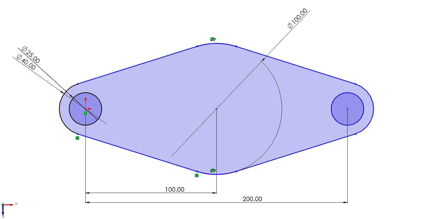

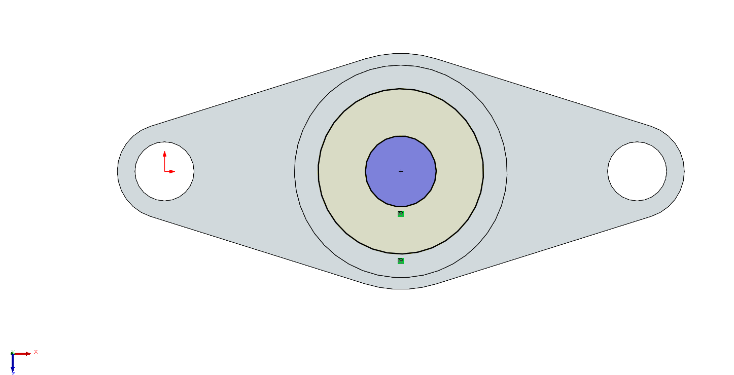

  1. Step 1: Create Base of the flange (Sketch)
    At first we should create base drawing of the flange. Here is the measurements.

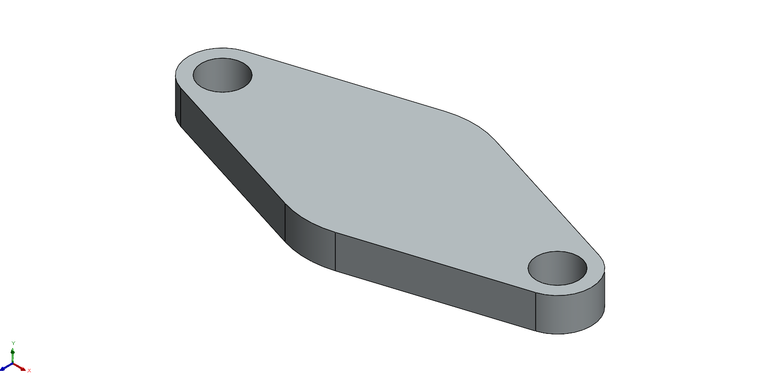

  2. Step 2: Create Base 3D From Sketch
    Extruded Boss/Base that sketch file.

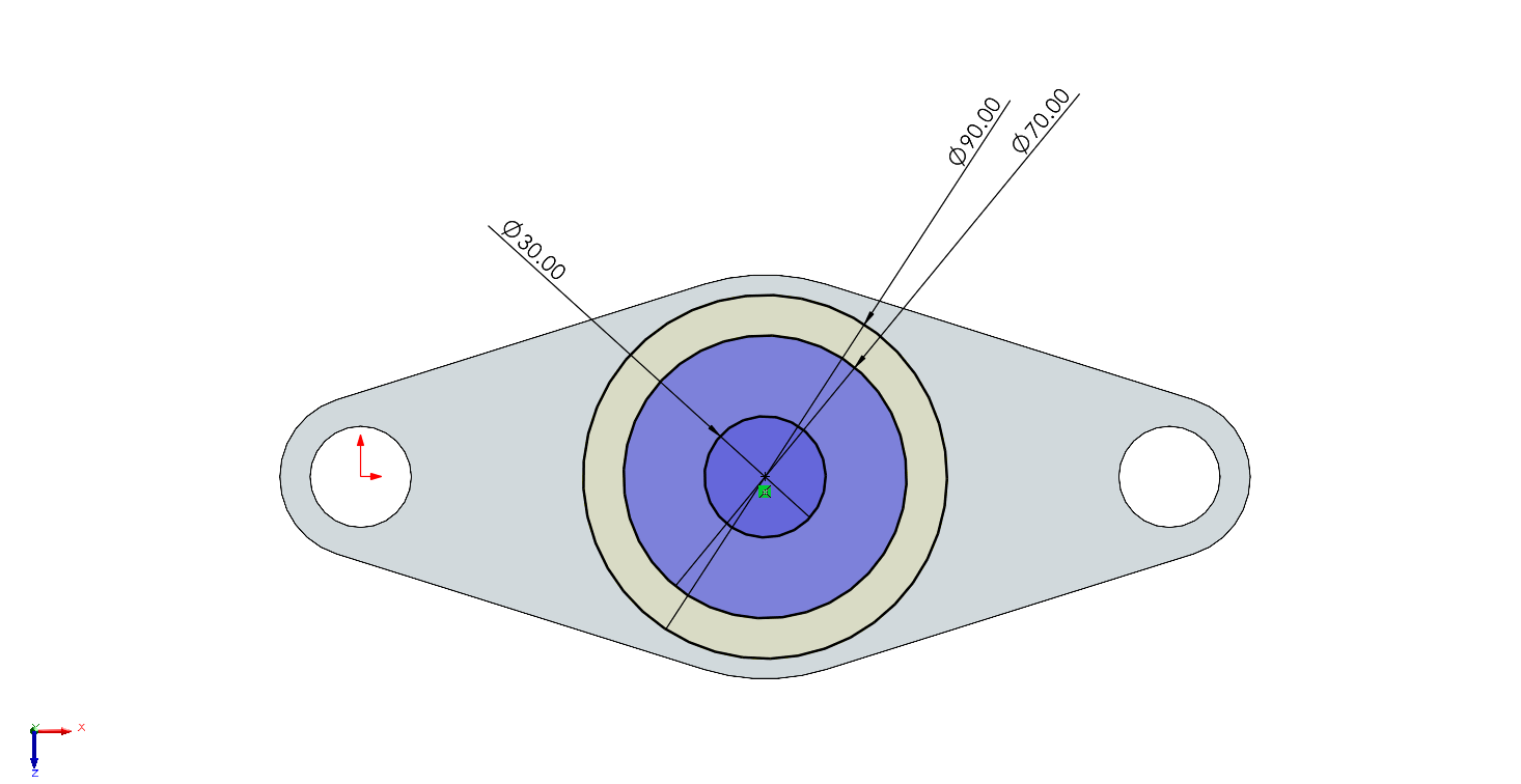

  3. Step 3: Create Center Support Frame (Sketch)
    In next step create the Center base as shown in the picture.

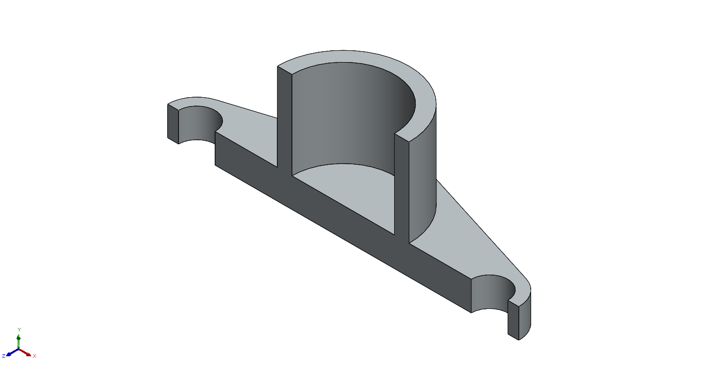

    Lets see the sectional view of the model that we created till now.

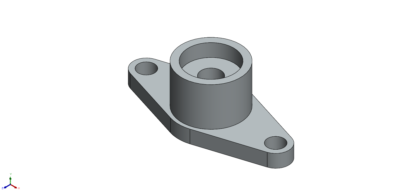

  6. Step 6: Create Inner frame 3D from Sketch
    Extruded Boss/Base the base the sketch file of inner frame.

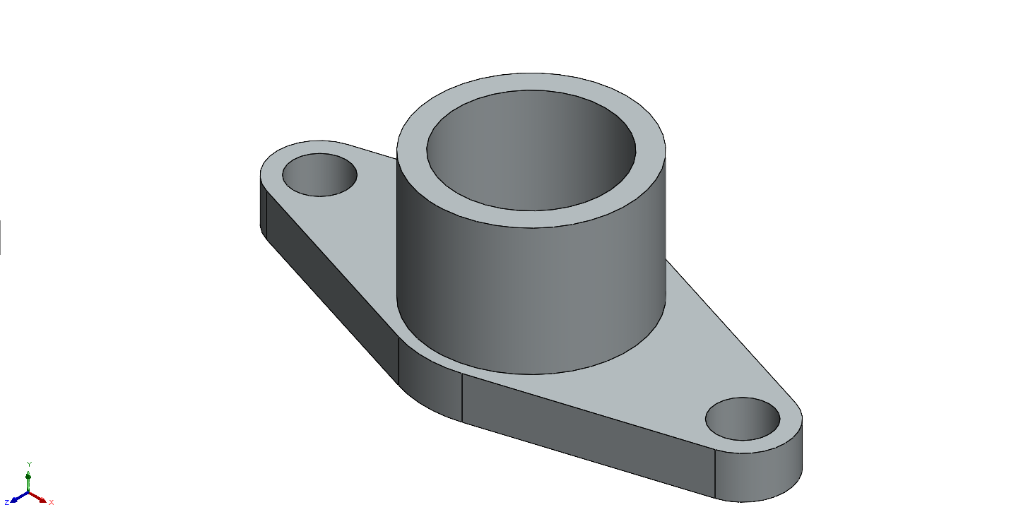

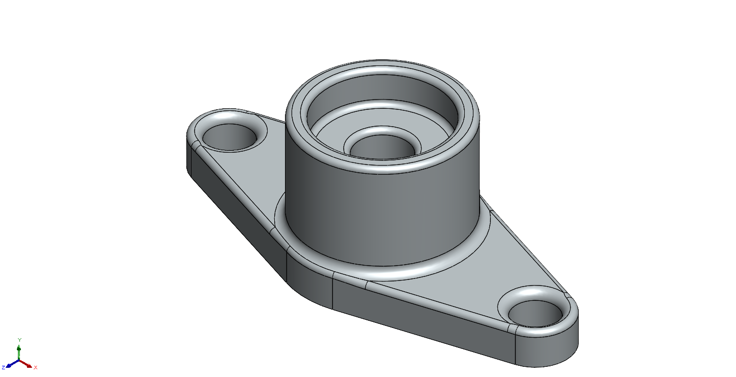

  7. Step 7: Fillet the edge
    First fillet the edges by 5mm size.
    Then fillet other edges by 3mm size as shown in the picture.

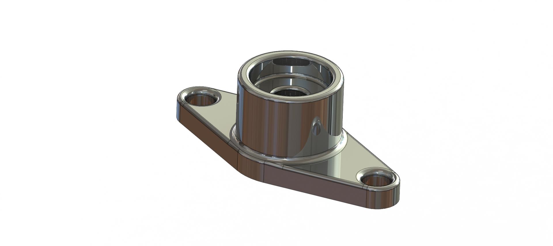

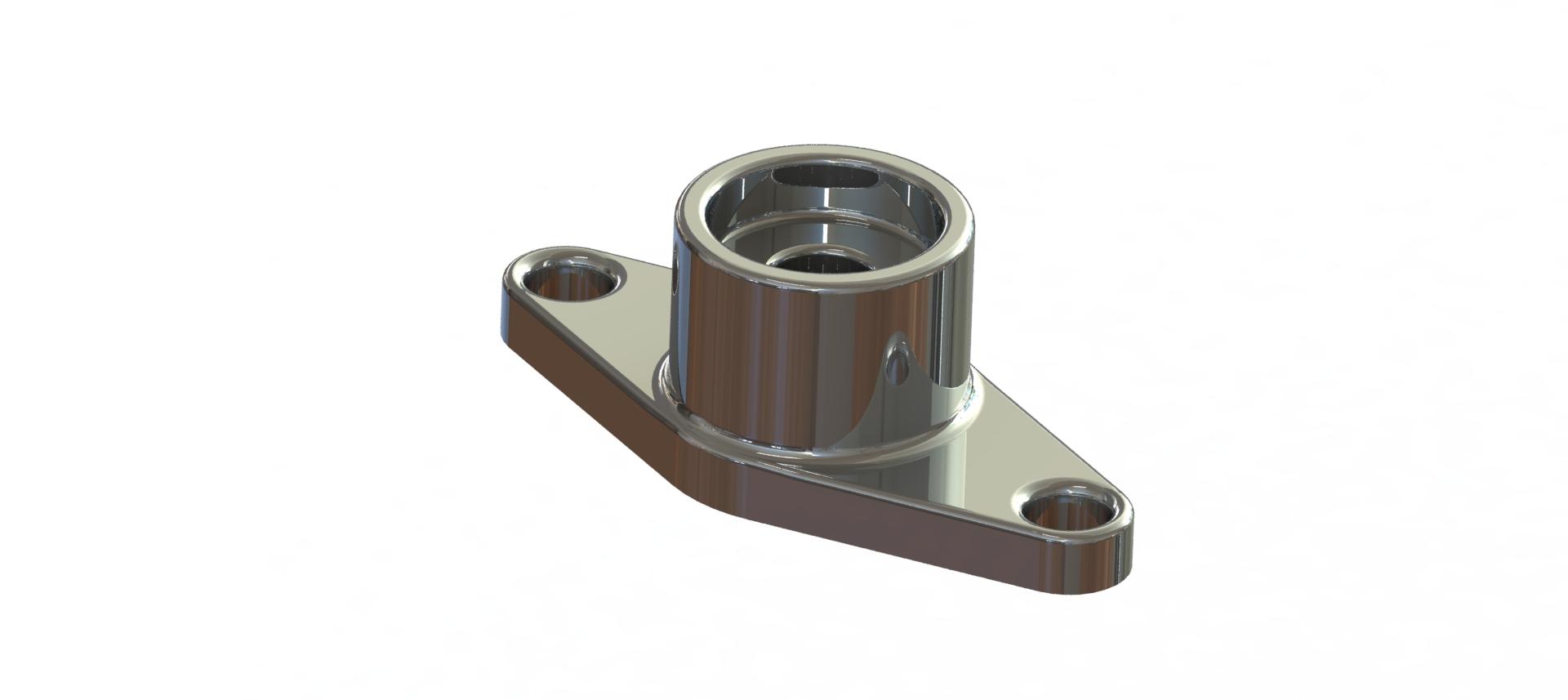

  8. Step 8: Rendering view

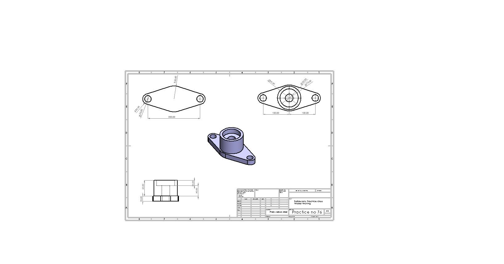

  9. Step 9: Full Drawing sheet
