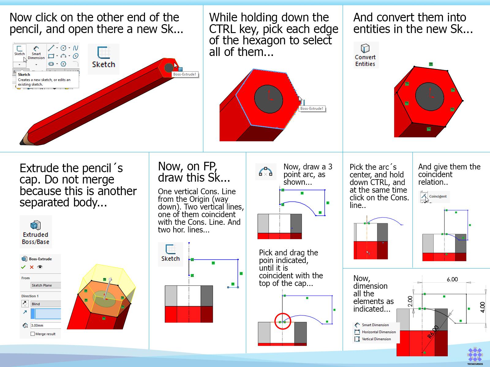

This is a tutorial for beginners, but yellow belt (a little more advanced).
It is about modeling a 2HB drawing pencil in a multibody environment.
You will learn several tricks and modify appearances to make them look more realistic.
Enjoy!

  7. Step 7: Adding the Cap...
  8. Step 8: More on the Cap & Some Filleting...

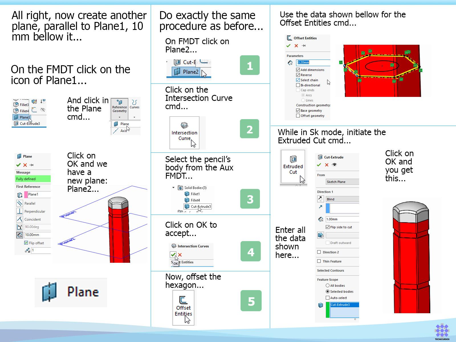

  9. Step 9: Creating Planes...
  10. Step 10: Adding a Cmd to the Command Mgr...
  11. Step 11: Using "Intersection Curve"...
  12. Step 12: Making the Other Groove...
