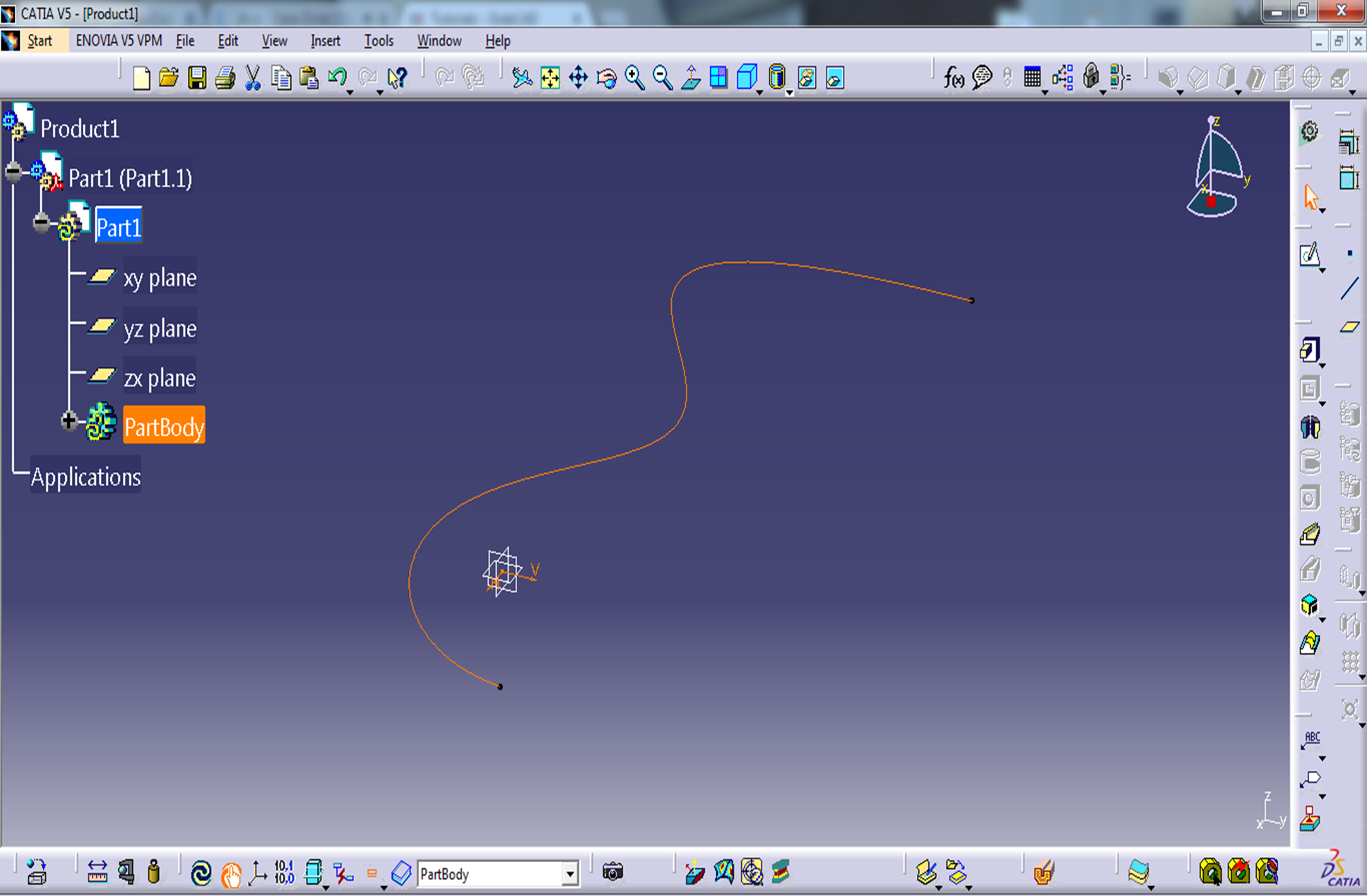

First a wavy drawing is made with the spline.
Step 2:

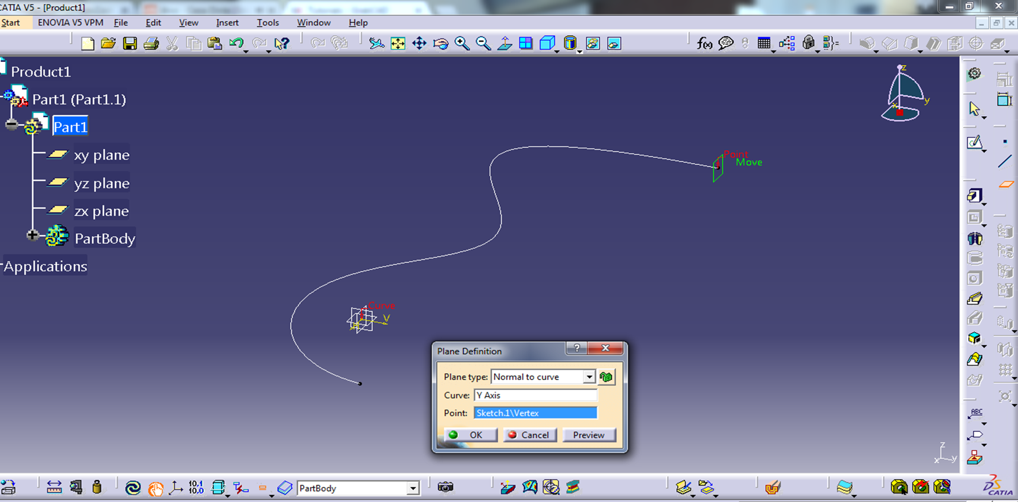

The spline is assigned to the spline.
Step 4:
With this plane, sketch environment is entered,
