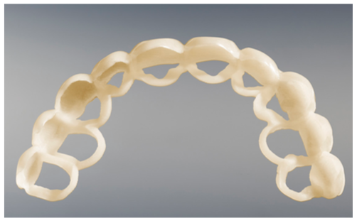

Step 6: Medical and Dental
PolyJet photopolymers have expanded beyond their roots as a tool for engineers and designers to become a leading 3D printing technology for medical and dental applications. Recognizing the unique needs of the medical arts, Stratasys has formulated six materials specifically for medical and dental applications.
Property-wise, these materials are nearly identical to Rigid Opaque. The one exception is stiffness, which is nearly 50 percent greater, so these materials are strong and very rigid.
For dental applications, there are four materials.
VeroDent
VeroDentTM has a natural peach tone and is primarily used for dental models generated from patient scans or impressions.
VeroDentPlus
VeroDentPlusTM is also used for dental models, but it comes in dark beige and offers improvements in detail resolution and surface finish.
VeroGlaze
VeroGlazeTM has an opaque, white color that is listed as an A2 in accordance with the Vita shade guide used in dentistry. The shade and properties make VeroGlaze an ideal material for realistic veneer samples (Figure 5) that allow the patient and doctor to visualize the results of a prosthetic prior to performing the treatment.
Bio-compatible
Bio-compatible material is used by both medical and dental professionals when the 3D printed part will have bodily contact. It has five approvals: cytotoxicity, genotoxicity, delayed type hypersensitivity, irritation and USP plastic class VI. With these approvals, Bio-compatible material can be used for direct skin (more than 30 days) and short-term mucosal-membrane contact. Please check each medical material for its specific bio certification.
This clear, colorless material is suitable for orthodontic appliances, delivery and positioning trays, dental try-ins and surgical guides.
Hearing Aid materials are used to rapidly manufacture accurate hearing aid molds with smooth, comfortable surfaces. The hearing aid materials are available in two colors, clear and rose clear, and they have received medical certification.
