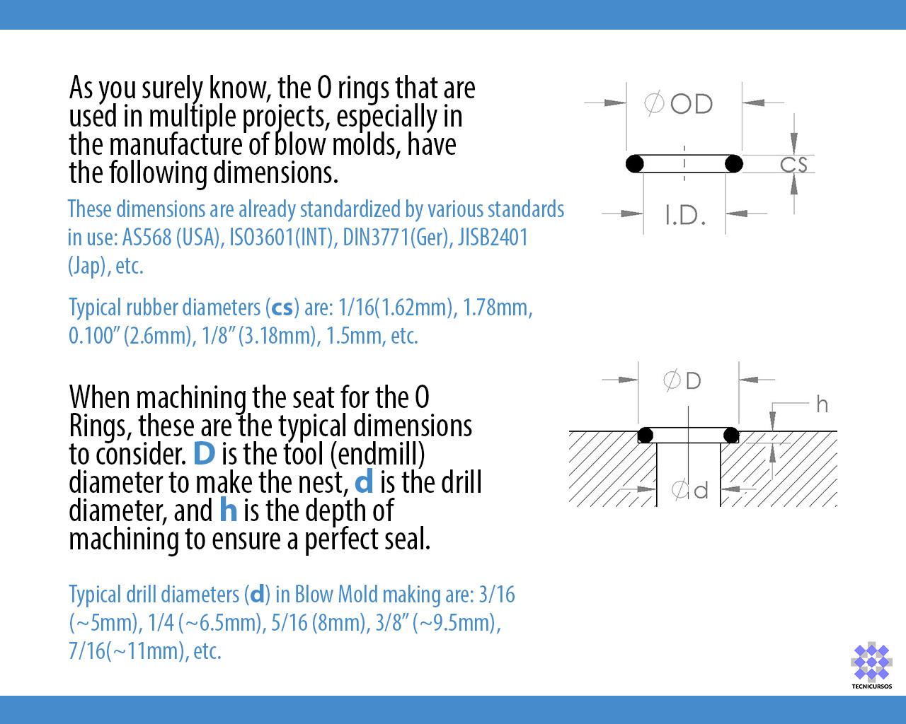

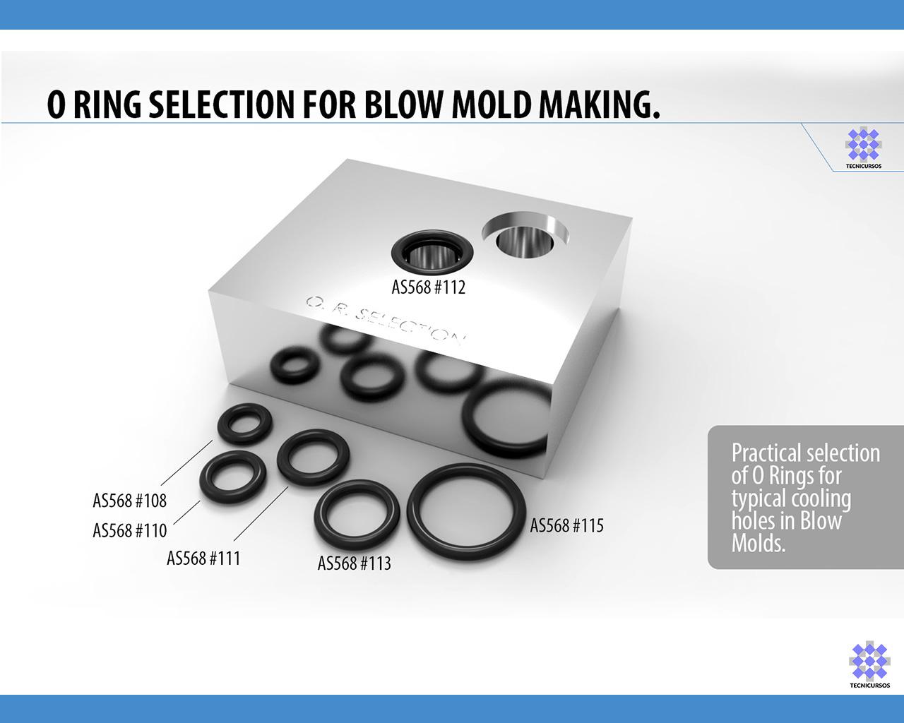

This is a practical selection of the most common O Rings used in blow mold making. Standard AS568 (USA)
We have been using it for a long time, and it has been extremely useful to us.
