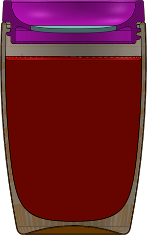

    Here is the same cup designed as surfaces and as solid bodies.

    For this cup, the liquid should slightly overlap the cup. This is for two reasons.
    1) The render works
    2) There is no chance the tessellation will leave gaps between the model.
    We could design with the overlap in our CAD software, or we can scale the liquid up in KeyShot. 0.1mm is plenty.

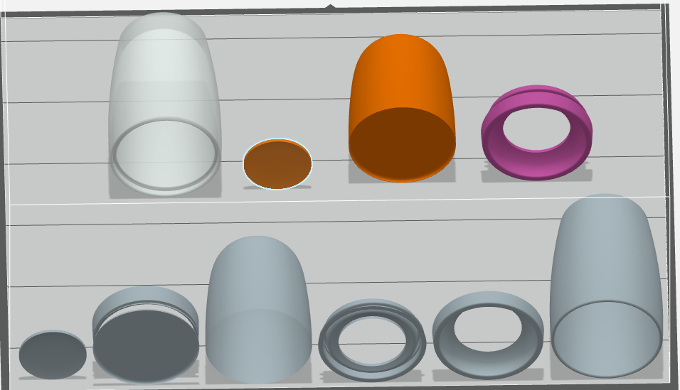

  3. Step 3: Polishing Layer
    Polishing layer: a layer of clear material added to the outside of a part
    Designed to be sanded away, removing the support interface layer without removing color
    Lowest priority in GCP (more on that later)
    For this cup, we will be sanding the sides and bottom, so that is where we need the polishing layer. Shown below in Orange. The polishing layer here is 0.5mm thick.
